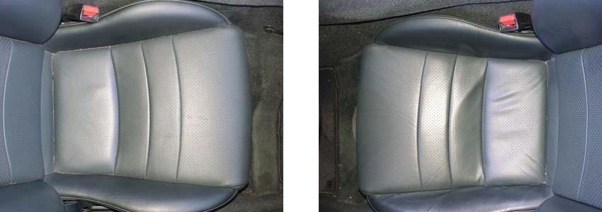

Thanks Jay...can you or anyone else post a pic of the seat post the mod?
Old May 26, 2002 | 10:19 AM
  #25
JL's Avatar
JL
Posts: 140
From: SF Bay Area, California
Matrix,
Here are some pictures: passenger seat is at the left, driver's the right. top is from the side angle and bottom from the top. I guess the difference from removing the foam is more visible than I thought. Also be reminded that I drove this car just about a year, 99% of time solo--the passenger seat was hardly ever used. I wish I took the driver seat before I worked on it. Well, hope this helps you decide.

JL, thanks for the pics !
