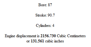

Using Honda's published bore and stroke numbers, the displacement for each are:
F20C 87.0 x 84.0 mm
F22C 87.0 x 90.7 mm

Every bit of Honda literature I've seen in the last 12 years quotes the F20C stroke, correctly, as 84.0 mm, with a resulting displacement, again correctly, of 1997cc.
