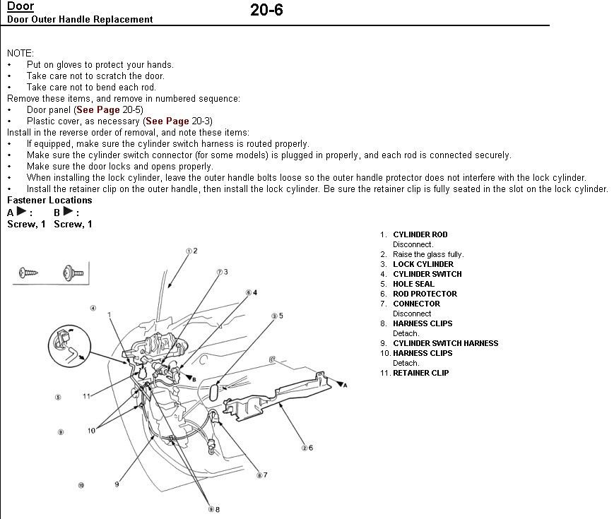

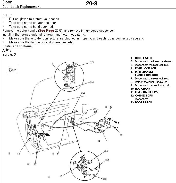

Does any body have experience or instructions on this? I need to swap the lock out but can't figure out how to get it disassembled!

Hope that helps.

sorry to bump this from the dead, but does anyone know if ap1 locks will fit an ap2? the latching mechanism of my pass. door is done.
