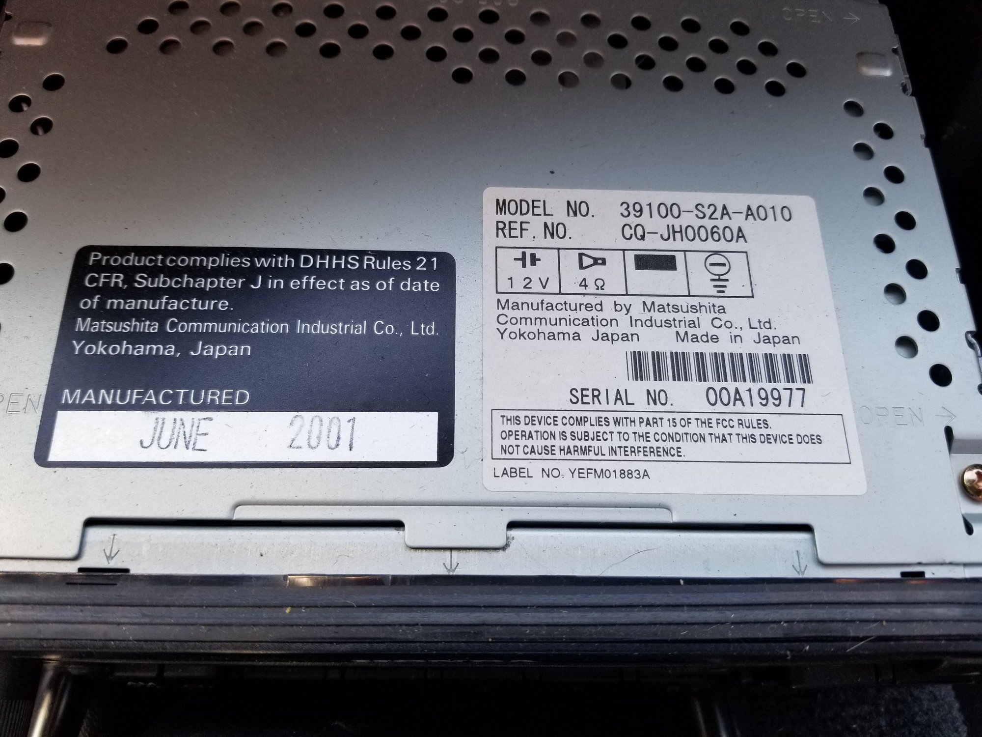

if he already went to the dealer and they told him e radio has to be removed then ya he’d have to in order to get the SN unless he can find that tag. The SN is on the radio itself. You can try holding 1 & 6 and turn radio on and see if it gIves you the sn but older hondas didn’t have that option. You can use the link or pm me the sn and I’ll log in to Honda network and pull the code for you.

Yea. Unfortunately you’ll have too. If you can get me the radio SN I can pull the code for you. Check your paperwork. It usually a small credit card sized with 2 numbers on it. One is the code and other is the SN. Also at the time of when the car was pdi, they might of attached the sn in the glove box, trunk or door jamb
Sorry it took so long. I wasn't looking forward to pulling the radio out, but it was much easier then I thought it would be. Had time to spare so I treated the leather!
Thank you for your help!

I appreciate all of the help. After I posted the pic of the radio sn, I tried the link that JackTs2K posted. I was able to get the radio code from that site no problem.
Now that I have it working, I really don't know if I'll use it. My wife will be happy though.... I see I have to set the time on the radio though.
