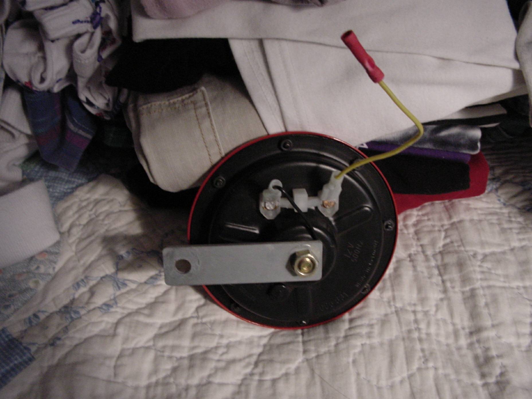

Since I am only using one horn and our car has a 15 amp horn circuit, I did not use a relay. The black wire is grounded between the arm and horn which gets grounded to the chassis when you mount it, and the yellow wire is attached to the original horn wire.

From: High Point, NC
http://gallery.s2ki.com/imagecatalog/image...geview/87001/6/
Thanks for your help. I'll be doing the install tonight

You'll have to create a lead wire that connects to the factory wire. There is only 1 wire, simple process. The other lead from the Hella horn goes to ground.

gomarlins3
