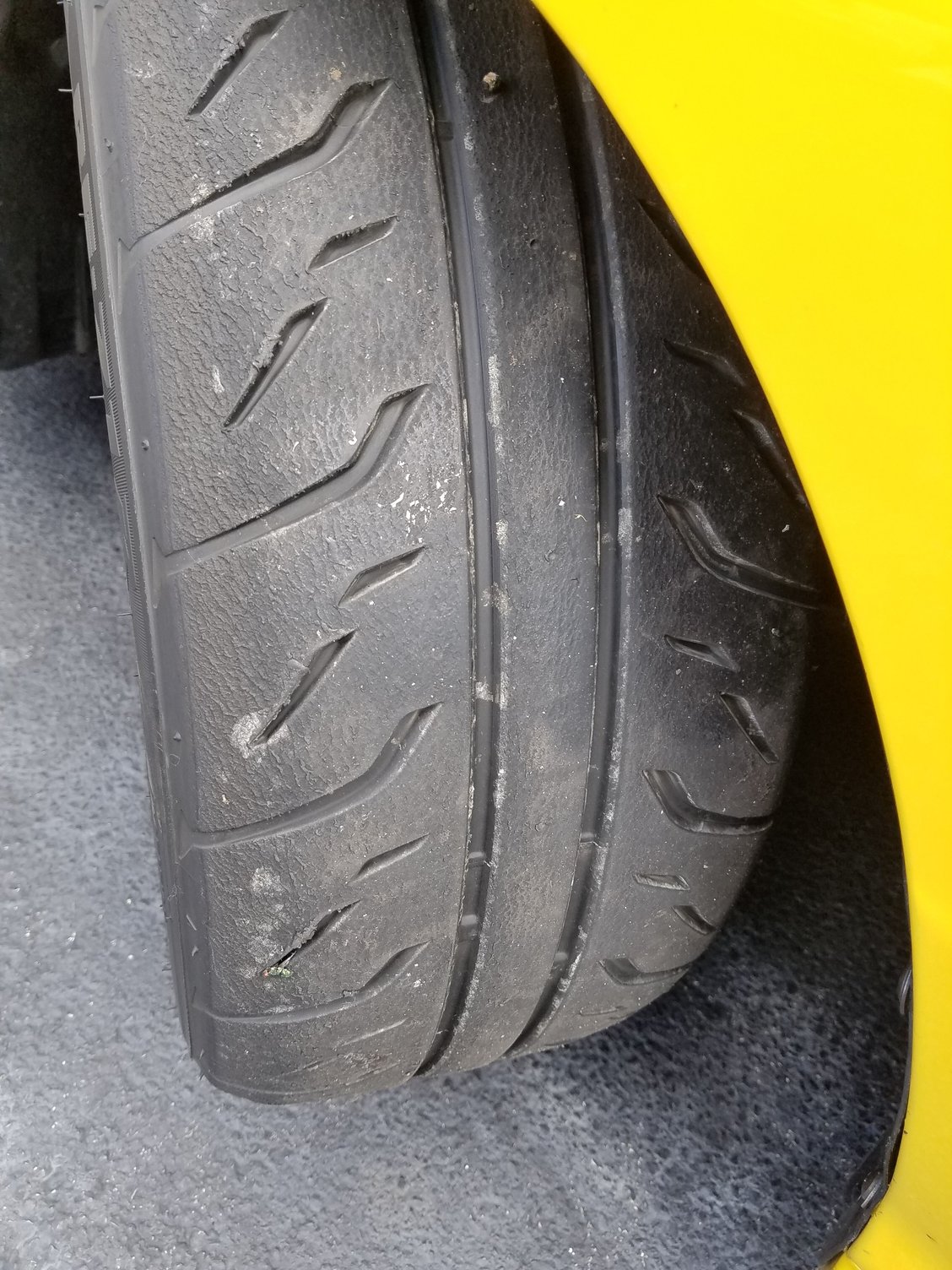

Why are you planning on all season tyres?
The rear of the car loses traction because its driven that way. Stickier tyres will have a higher limit. So most people who use tyres to save the car from spinning just crash while going faster.
I'm using 17x10+50's and 255's all around. They likely weigh a tiny bit more than the stock 16's. But the car turns better lap times anyway. Don't over think it.
I'm currently using ADVAN RZ2's which are roll forged (forging for poor people). And Bridgestone RE71R's.
If you're not tracking the car...look at MPSS's or Bridgestone S04's or Firestone Firechickens.
if you need to drive in the snow, buy snow tyres for your stock wheels.
I'm thinking about buying Volk ZE40's...which come in S2000 width/offsets and are forged. I am not buying them to shed weight or to do anything functional. I just like them.

Never buy all season tires if you only drive when the temps are above 7 degrees C. buy low tread wear tires and replace them every 3-4 years, even if they don't look worn (UTQG 200-340)- Z2, RS4, RE71R. Buy snow tires if you're going to drive in cold/snowy weather

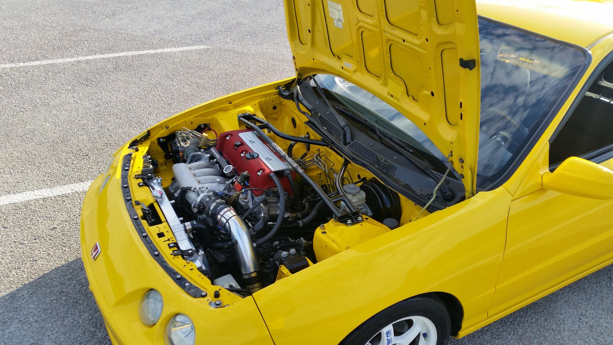

It took me about 6 minutes to figure out a winning ITR combination. More power, short gears, sticky tyres, brake pads that didn't overheat, a decent suspension that worked where I used it.
TE37's are on there because I like the way they look...and they were convenient to buy.
15X7 TE's were like 9.x LB. No clue how much 205mm 71R's weighed. But even if a less sticky tyre weighed less....the sticky one is faster.
I would have preferred a 15x8 and 245mm's up front. It would have gone WAY faster even if they were a different brand or model that weighed more.
Sometimes simple is more effective.
But...I guess you're having fun with the details. Nothing wrong with that.
But usually, detailed builds have a purpose.
I'm a logic based organism. Is this a build thread, or are you asking for input? Or just a discussion?
Its fine either way...but...why all the detail? what purpose are you building this car toward?
And all that detail followed up with an all season tyre choice is incredibly odd. Detail detail detail, cams, cleaning up castings, port flowing, retainers...and...eehhhh whatever tyres I can find lying on the side of the road.
KNOWWHATIMEAN?
The tyre choice is a more effective mod than all of the other detail junk put together. If the goal is to be effective....

I don't think ot can be emphasized enough about tires. This car acts wonky if the sidewalls aren't sufficiently stiff. While some summer performance tires are more suitable than others, pretty much any AS tire is going to be totally lacking in this regard. This is why everyone is telling you not to go this route.
Get summer tires with a stiff enough sidewall, then don't drive the car when temps might go low enough for snow or ice or cold roads. Get winter tires if you must drive it in cold weather, then drive it respectfull of their limitations.
