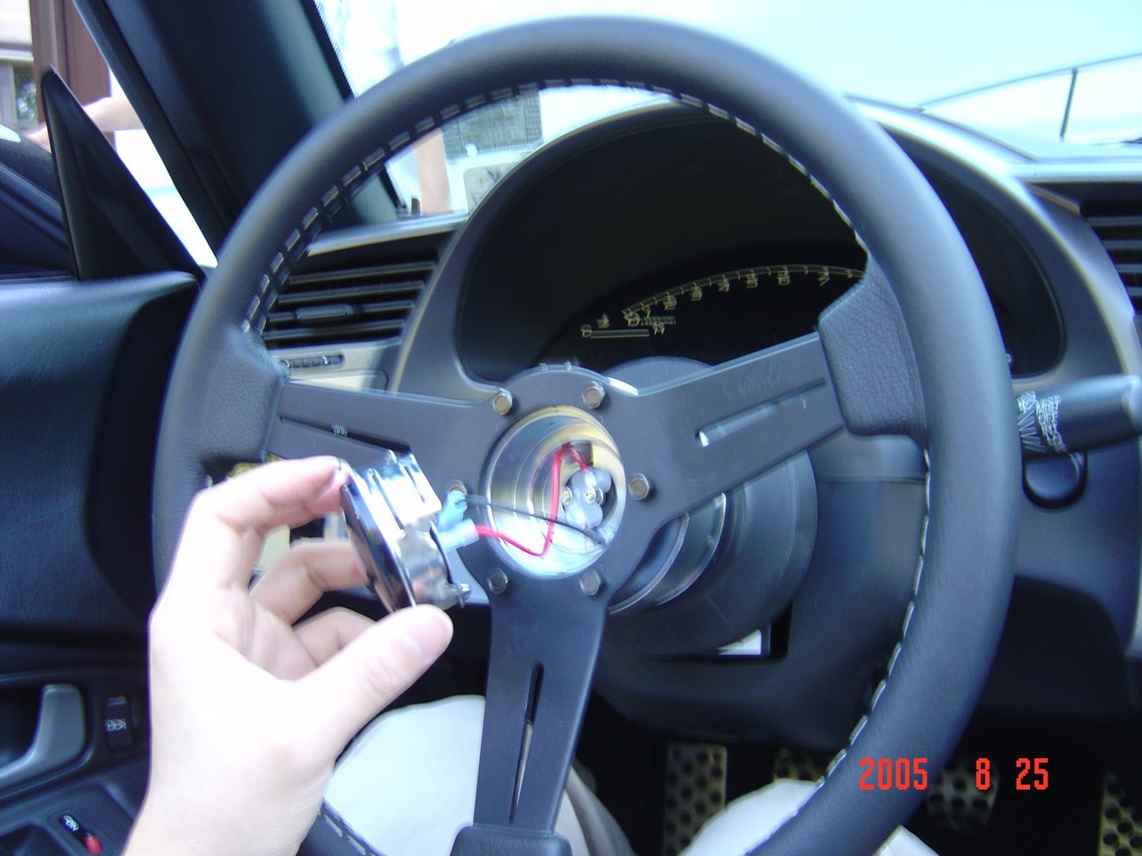

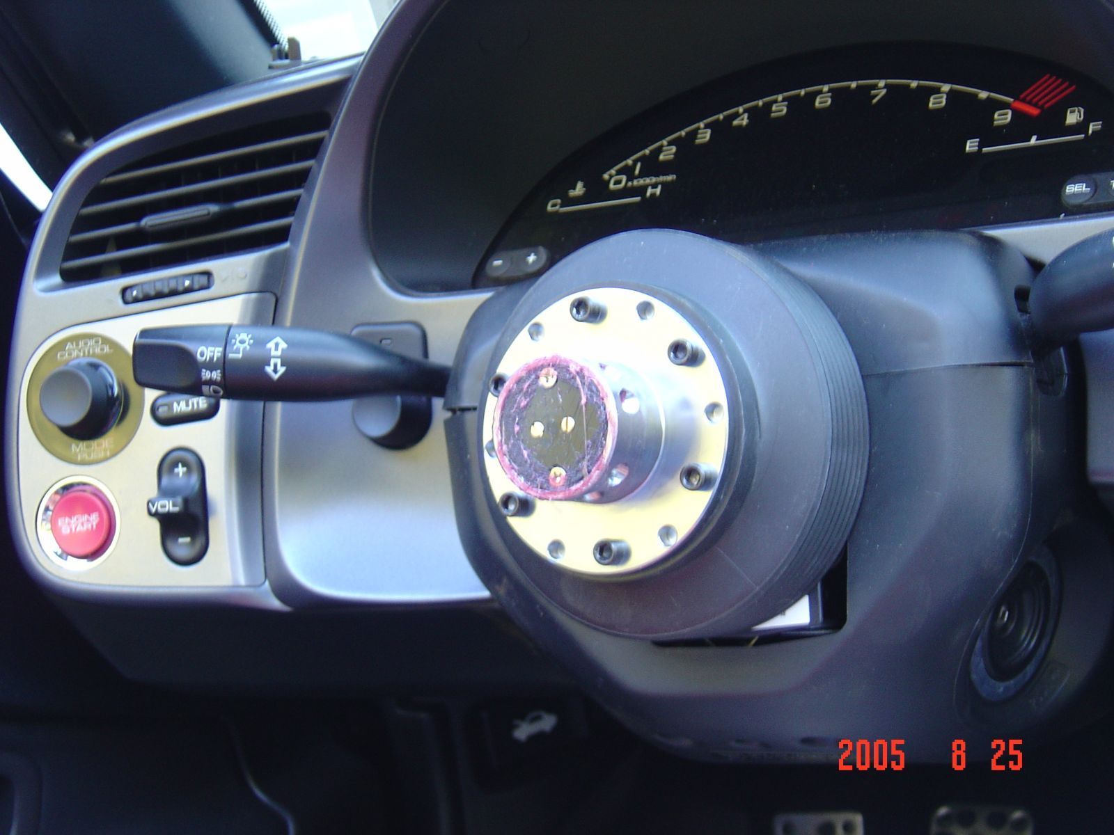

don't know if the pics helps
BTW, mine is Splash short hub + (made in Taiwan no brand) Quick release
you mean these right? Splash has a hole where you may tuck them in

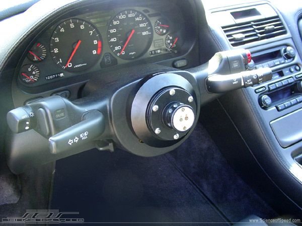

NRG on NSX is like this

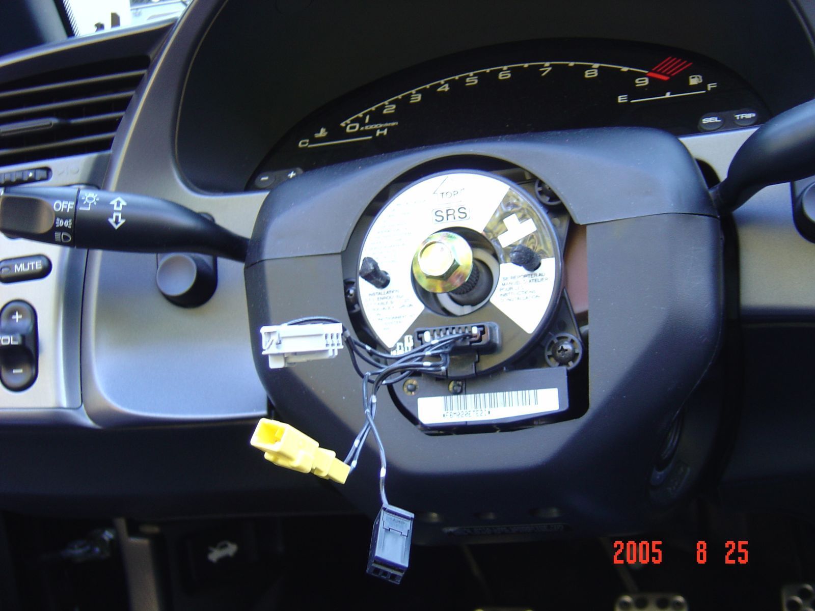

i'm pretty sure you have the right part.
you need to remove the SRS reel.

Thanks for all the replied, yes im installing that short hub with NRG quick release, i think the one i have is wrong part coz inside the box its got paper saying all the car what this hub for, which is for integra 94-up, civic 92-95, so it mean this hub that i received is the one for car without airbag
S9735, Yes...the hole that i need to run that SRS reel & the horn wires through the hub, the hub i had is just flat...
S2X, do i have to take out that SRS reel? i dont think i like that coz that mean i got no horn also.... ?
