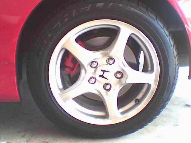

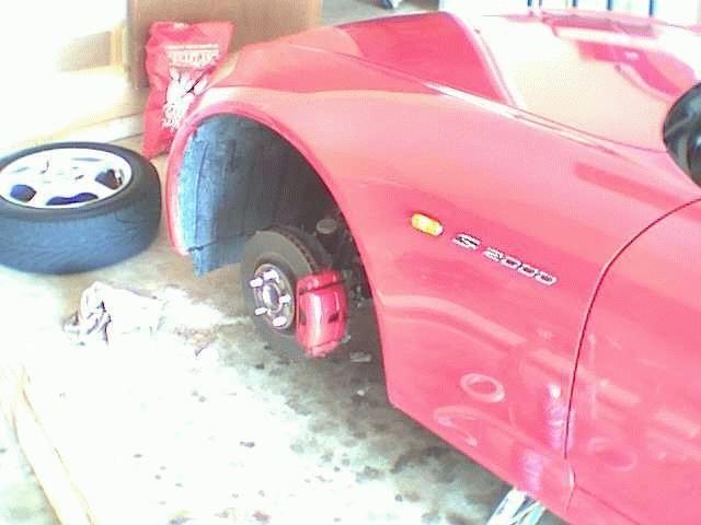

Well, I finally got around to painting mine! Here are the materials I used: Dupli-color high heat ceramic RED paint (DH1608) from advanced Auto, Acetone (commercial grade, not wife fingernail polish remover), masking tape, tooth brush (perferably one you don't use anymore), old T-shirt, 2 model paint brushes, and 2 plastic containers (not cups..acetone will eat through cups).
I started with the driver's side rear. First I masked all the rubber hoses and connections and parts I did not want paint on. Then I poured some acetone in one of the containers and used the tooth brush to clean the caliper, cleaning the tooth brush in the acetone every so often. CAUTION: the acetone will spray off the tooth brush and get in your eye if you are too close and it does not feel good! Once I finished brushing, I dabbed the tshirt with some acetone and rubbed the caliper just to make sure i had all the gunk off. Once clean, I took the other container and sprayed (outside the garage) some into it. I brushed a thin coat on and let it dry for about 15 min. Came back for a second coat, let it dry then came back for touch up. I found that the paint actually covered better as it began to get tacky. it almost acted like a puddy and filled alot of the rough areas. i repeated the process for the front driver's side and then the fun began. TIME TO CURE. About fifteen min after I finished the front I took my S2k out to try and heat up the brakes. I've never had so much fun watching paint dry I started around 1100 and was driving it around 1600, but remember, that was only the driver's side. I'll hit the other side tomorrow. I probably could have gotten both sides done if I had a better jack than just the one that came with it. I am really happy with the color match. I'll post another reply in a couple of months to tell how they are holding up. Here are some pics:
