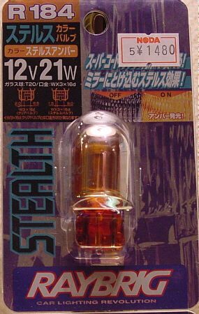

Sorry,
You did order the wrong part. The bulbs you have ordered fits the JDM and EURO spec cars with the standard equipped clear corners. Osram and Philips Silvervision offer these lamps.
You need the 7440 push-in type bulb (Polarg Hybrid M1 or Raybrig R184) like I used for my USDM car.
The top picture is with an amber colored Polarg 7440 bulb, the bottom one is the Raybrig Stealth lamp. Both are in OFF condition.
Poor quality picture of the Stealth lamp in OFF and ON condition. Actual light is just like a regular amber bulb.
Much good luck with your search!!! (I could only find them in Japan).

I'm impressed with the silvering on this Stealth light bulb in the above link. They do make a 7440 version of the bulb @ $30 /pair. The coating appears much better then the Polarg. I've got an e-mail into them to see if they have sample pics of the bulb lit up and ones with them in bright sun.
