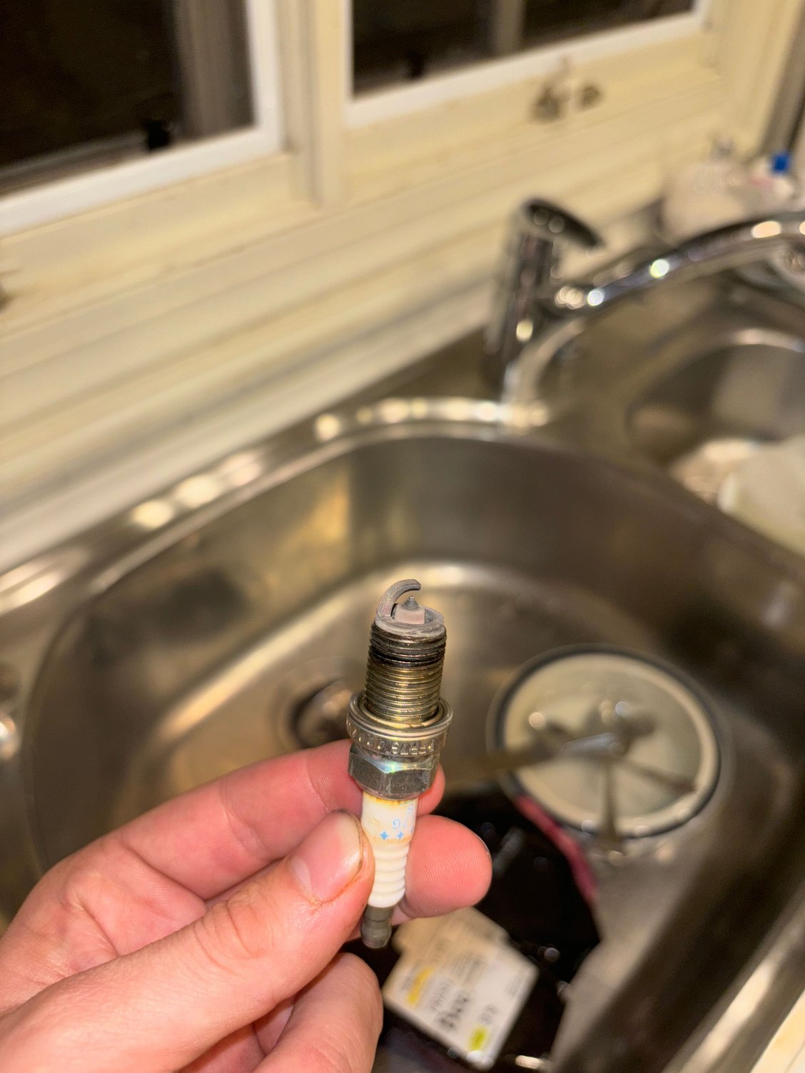

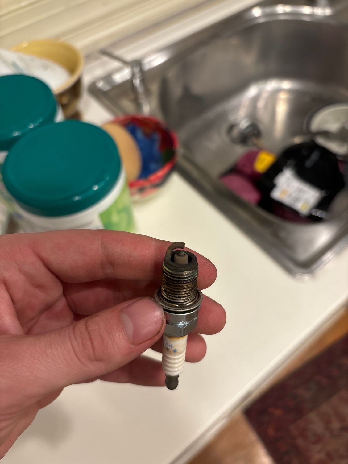

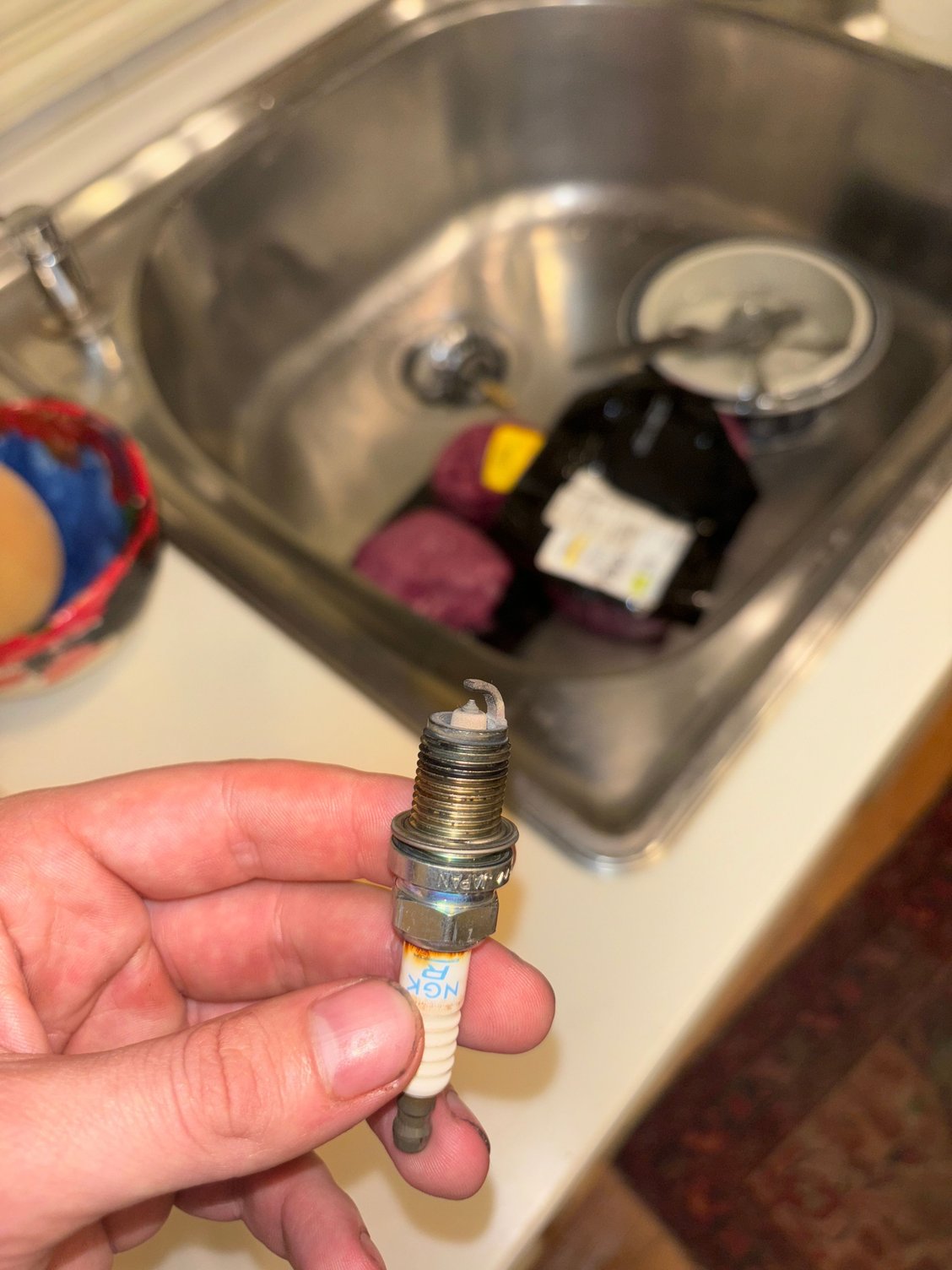

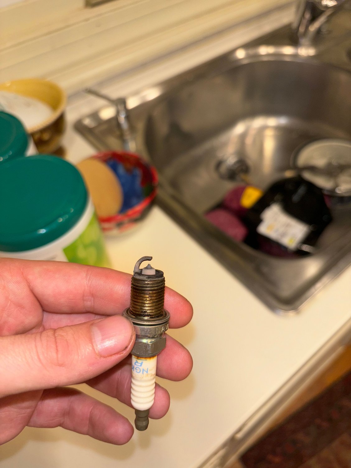

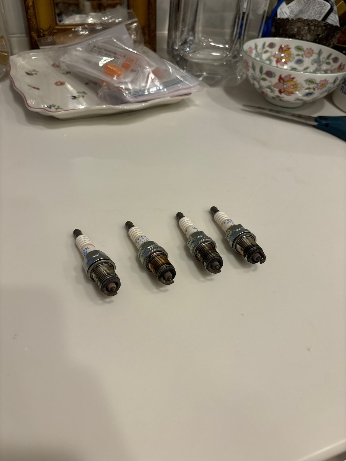

Just pulled my plugs after buying my s2k. Can someone tell me how they look? Also ran a compression test when the motor was cold and all cylinders were about 220 psi (are these solid numbers) how much more inflated would these numbers be if the motor was warm?

Look good,but put new ones in as are worn a little. If all are 220 thats ok,toque plugs correct NM

Do a valve adjustment while the plugs are out. Max gap. Cold engine.(Easier to turn the engine over by hand with no compression.)
Find the current recommended torque for the sparkplugs as it's been increased since the original spec 20+ years ago. Set of genuine pre-gapped OEM plugs is cheap.
