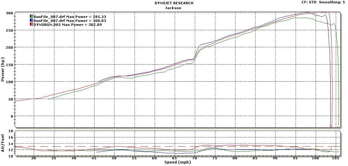

I guess you dont believe me abut dyno numbers. LOL Here you go after half an hour of searching my computer for it.
Red is 7 psi base dyno
Blue is Berk Tech Test pipe (you can see peak loses, but good mid range gains)
Green is the Megan header
Now dont get me wrong, I would buy it again. Cant beat $300 for SS look, but dont expect HP.
