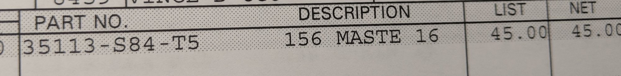

This is the part number I used as master

35113 S84 A02 thanks Deckoz

NP, btw im pretty sure the 157 key is exactly the same - except comes with a new immbilizer ID that needs to be programmed into the ECU.
The others are cloner keys - ie they rock a clone of your original keys immbilizer.
not saying this happens, but, you can technically get new keys with new immbilizer IDs, and remove the old ID's so if say a previous owner didn't give you all of the keys, it effectively disables the old keys out in rhe the world.
