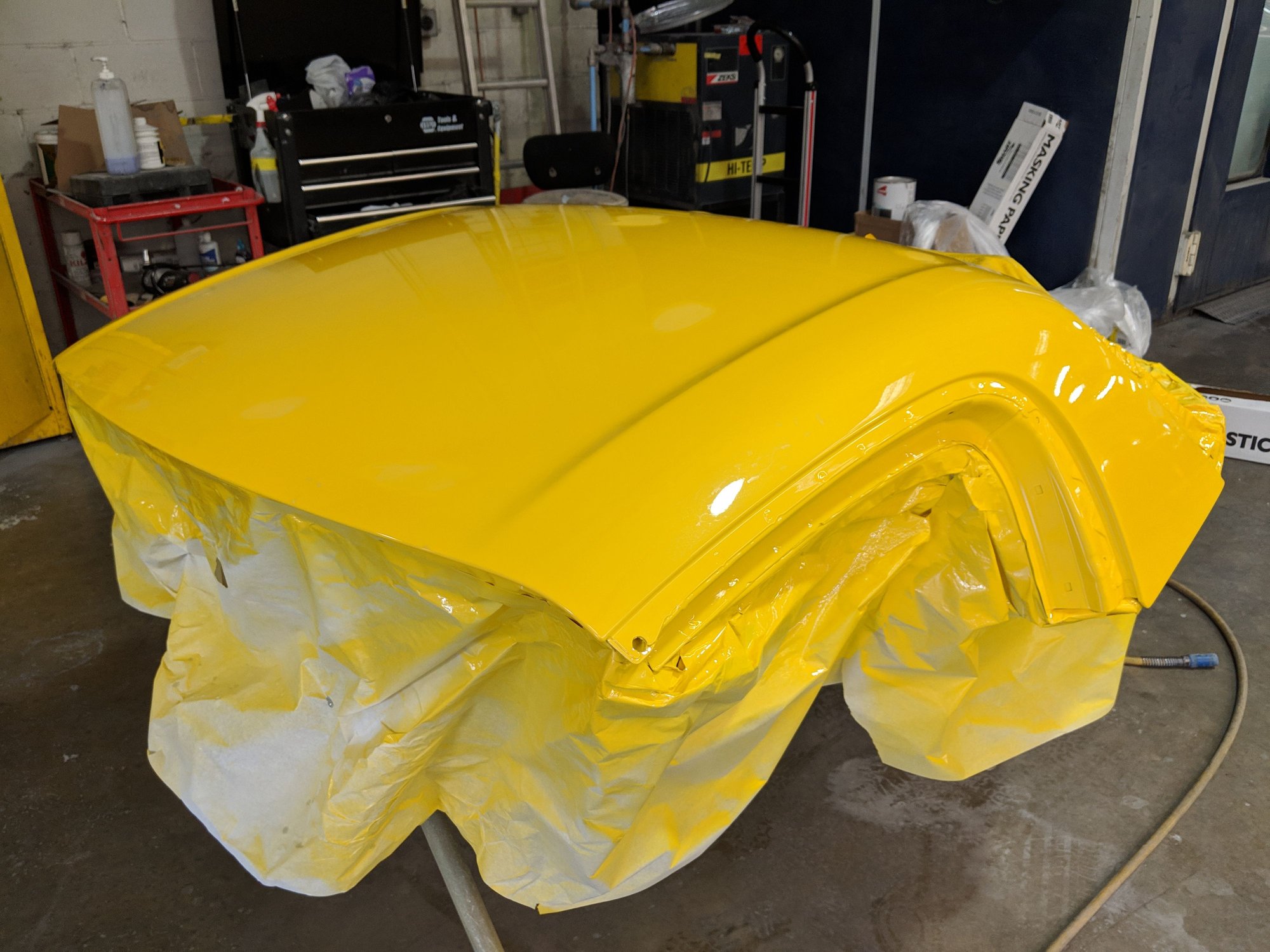

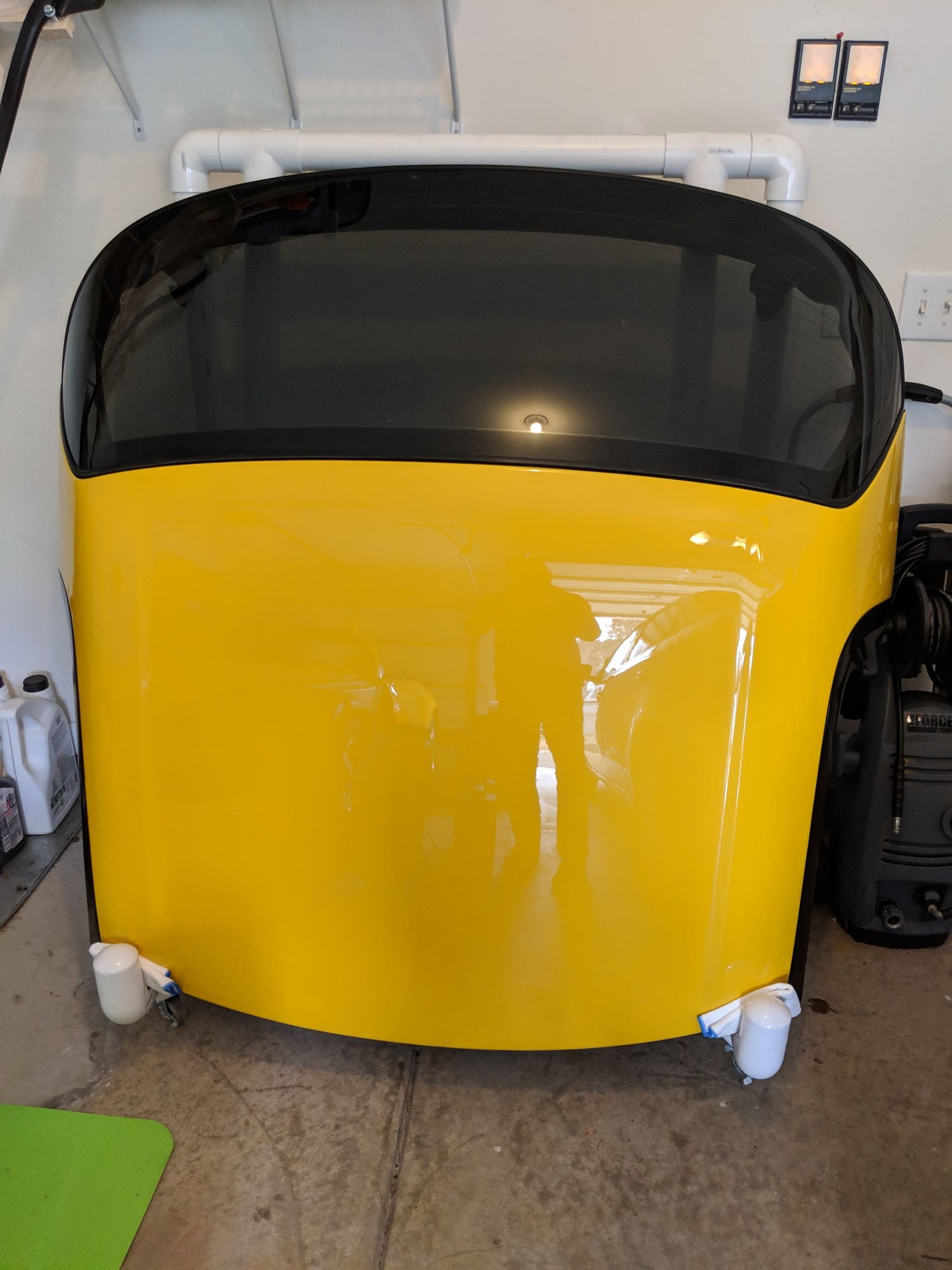

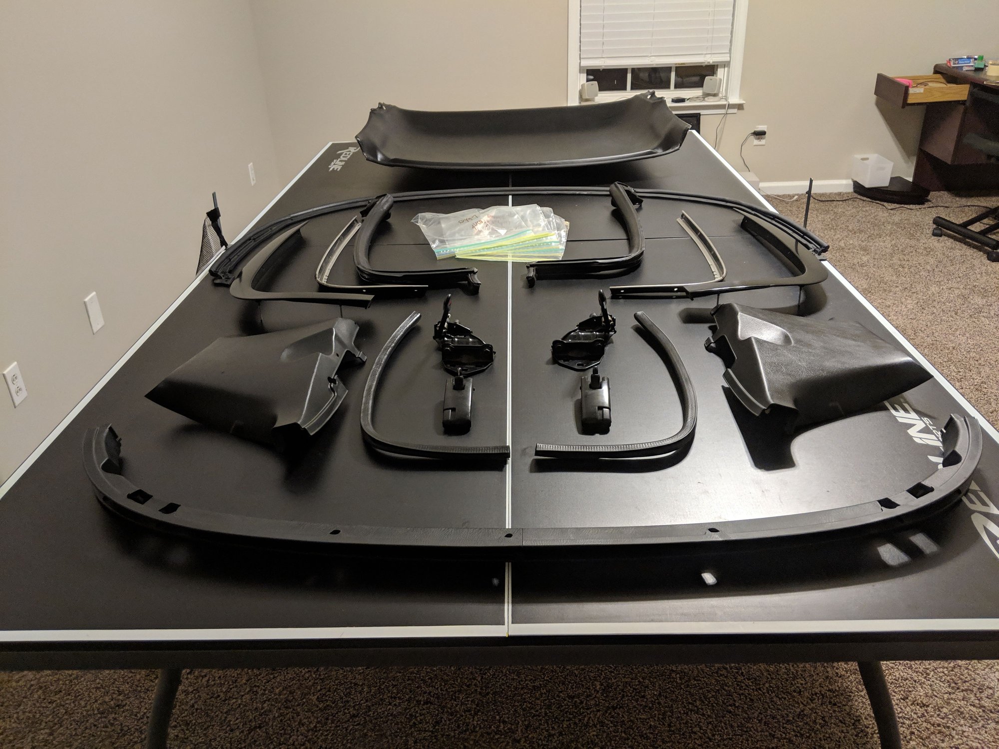

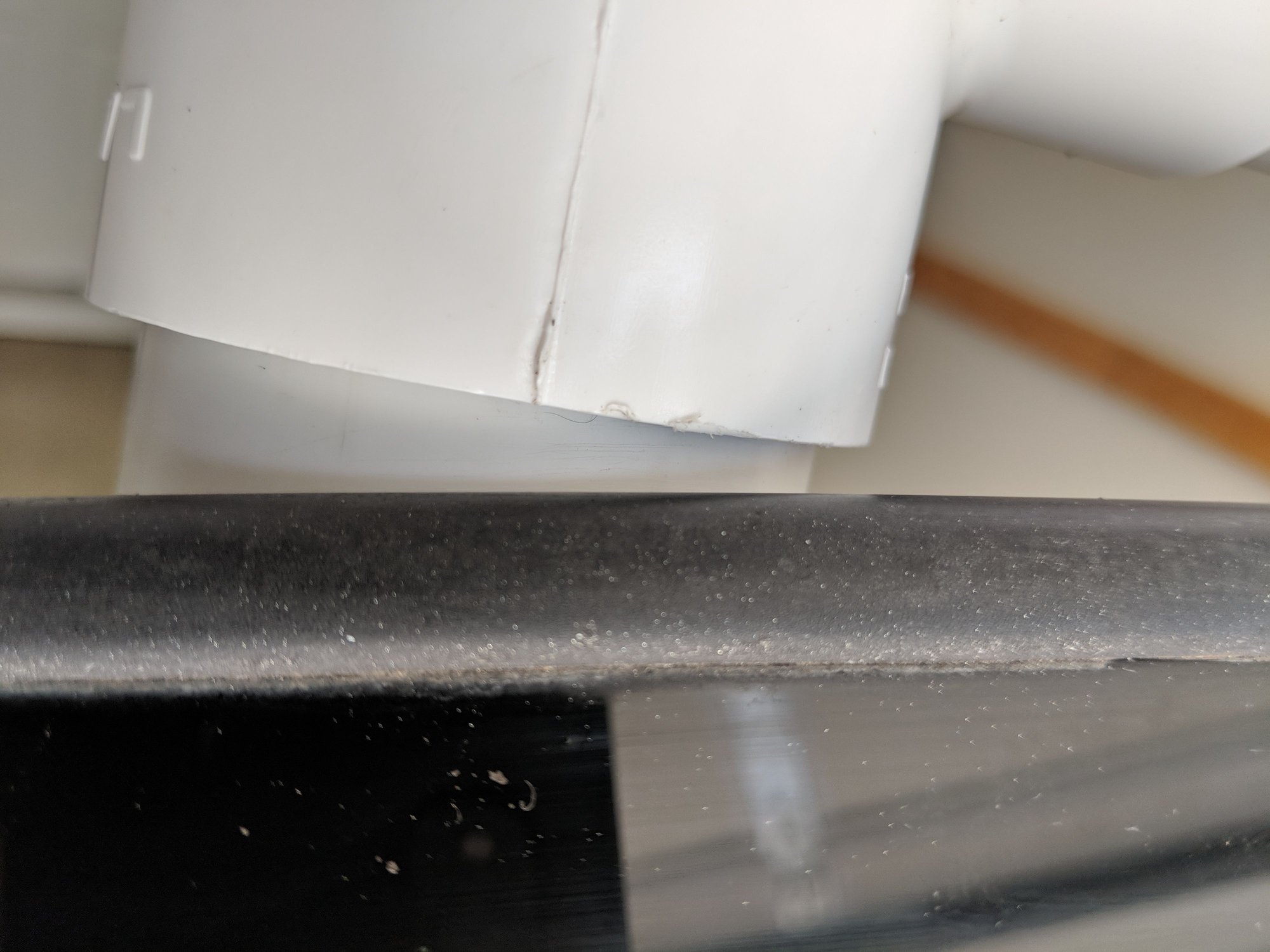

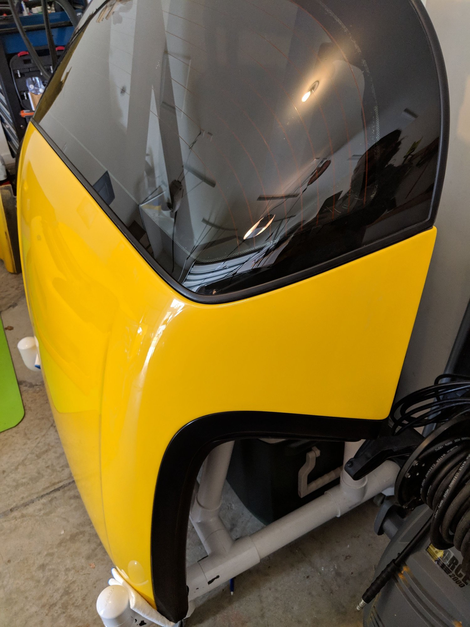

you can strip the rest of the hardtop, but dont strip the urethane bead or the paint under it. tape off 1/4 around the bead at minimum.
the section im talking about you can't even see when the glass is installed.
I literally just did this all myself, I had a sazuka blue thst someone did a shitty white paint job on, and painted the weather stripping and everything. I restored the weather stripping and pulled the glass to fix all the edging to paint it spa yellow.
if you strip that bead down to metal, you will have seal failure. ask any glass guy(windshield guy). you would need to wait for a full cure(60-90 days) before applying a new urethane bead.
anyway here is the glass removal
https://drive.google.com/file/d/1MXu...w?usp=drivesdk
overspray from previous owner
Overspray and mineral impregnated rear bottom
cleaned rear bottom

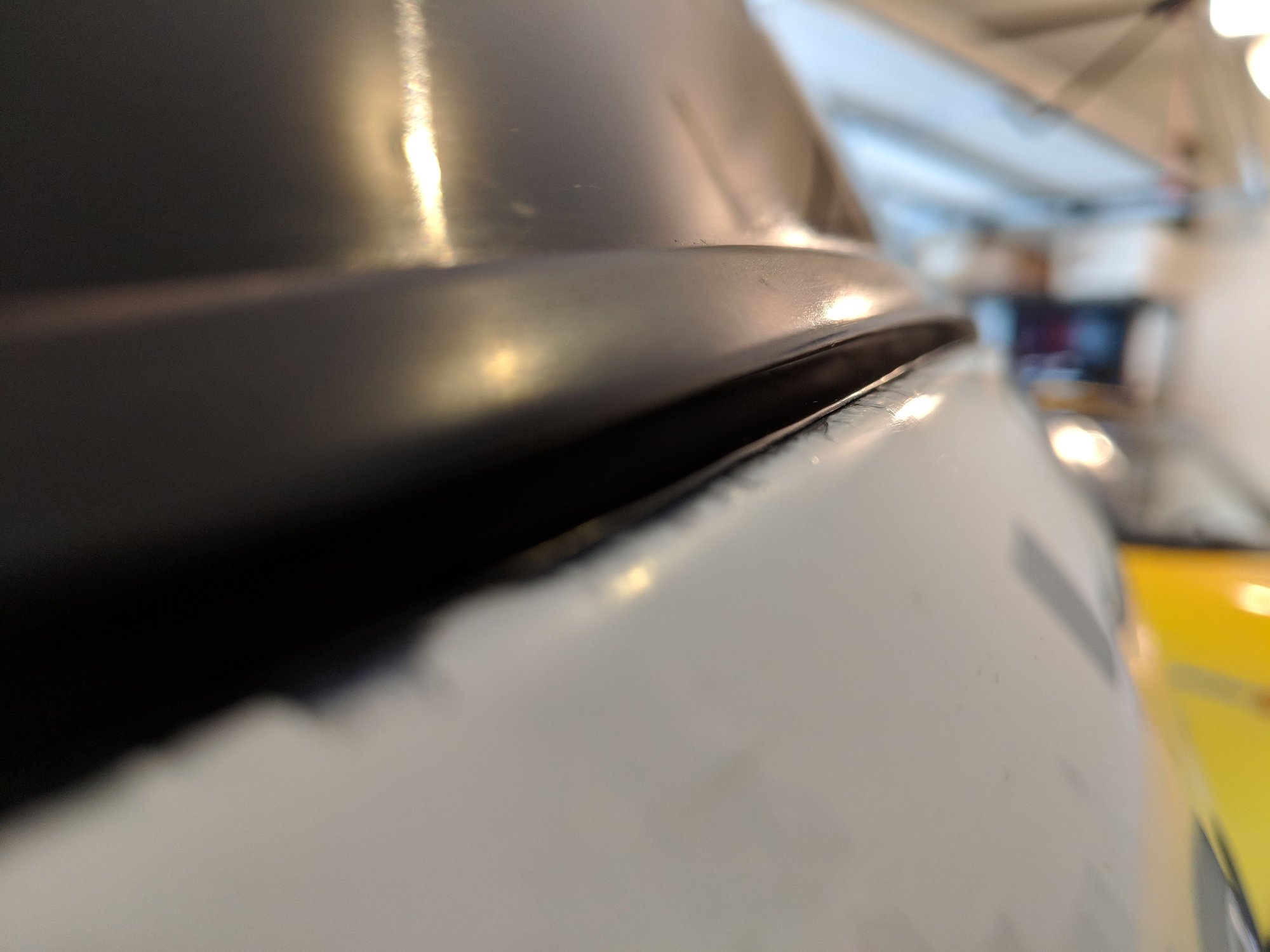

Can the weather stripping around the window (seen in the pic below) be removed WITHOUT separating the window from the top? I imagine this would be sufficient to getting good paint coverage as the weather stripping would coverup whatever wasn't perfect once re-installed.
Old Dec 5, 2018 | 10:41 AM
Deckoz's Avatar
Joined: Jun 2018
Posts: 714
Likes: 158
unfortunately, it cannot without damaging it. having a glass guy properly remove and install it will cost you the same as destroying and replacing the mouldings without taking the glass out. and the ability to reinstall it and it not come unbonded or fit right is unlikely as well.
​​​​​show me a picture of your mouldings and edge by the glass?
if the edge is fine, you can use 3m trim pull tape and pull the weather stripping back.
my edge was flaked, so the only way to properly block it required removal of the window. if your edge is smooth. trim pull tape and a mask cloth for the window are all you need.
​3M 06349 50.8 mm x 10 m Trim Masking Tape https://www.amazon.com/dp/B000P18N6W/ref=cm_sw_r_cp_apa_i_-PccCbXMB702G​​​​​​
