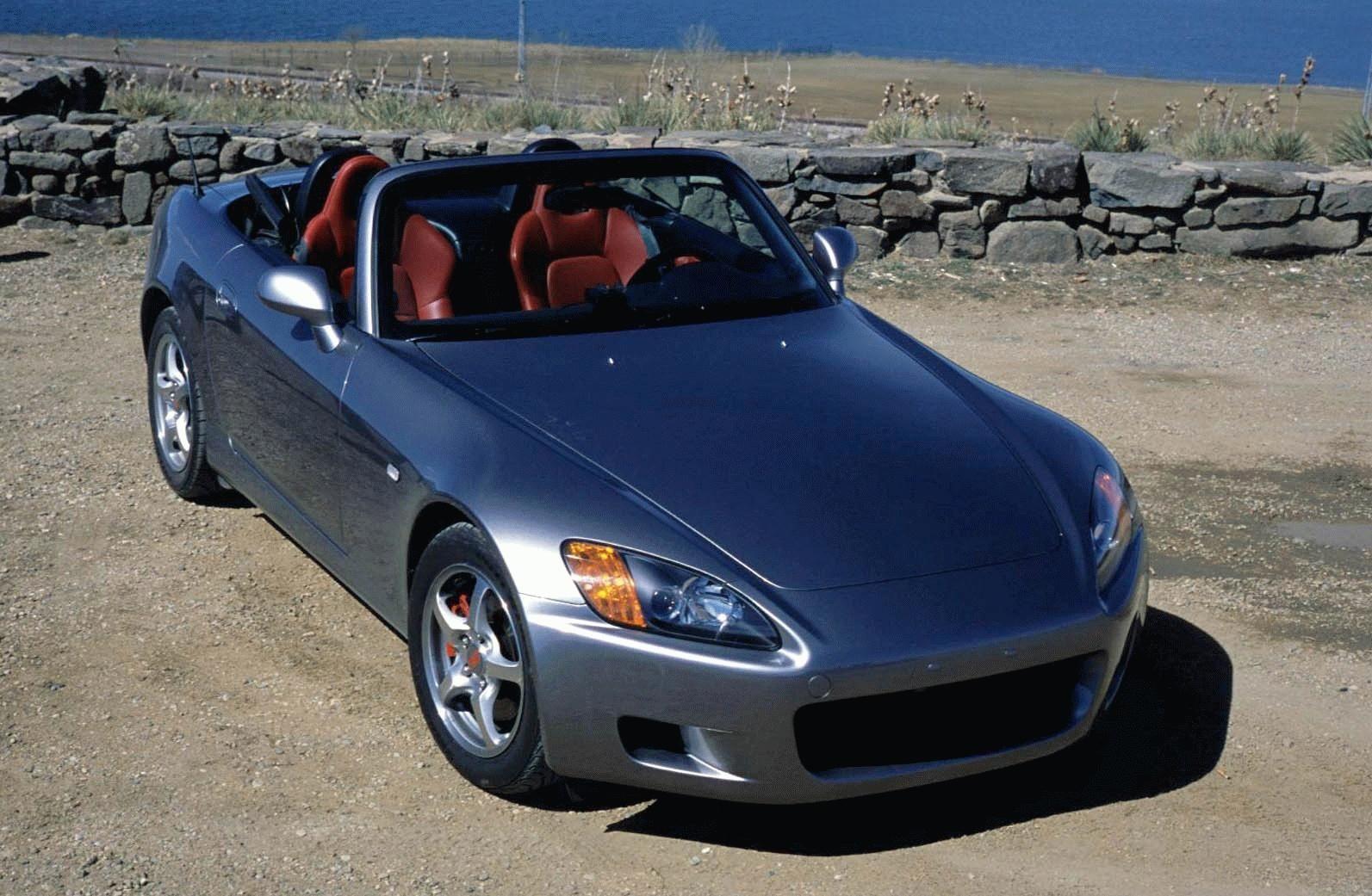

The front looks so nice without any emblems...!!!
