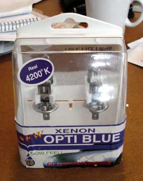

And here they are:
Turns out they aren't Narva's at all, but cheap Korean knockoffs. Still doesn't mean they shouldn't work.
