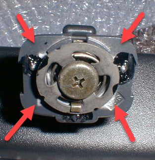

I got mine to quit loosening up and rattling even though I got the screw as tight as I could. What I did was to get some double-sided foam tape. I cut small pieces to go in each of the four corners of the mirror mount. I just took one side of the backing off to stick each piece down and left the top backing on since I didn't want it to adhere to both surfaces. Then, I loosened up the set screw, slid it on the mount, and tightened it back up. The mirror doesn't rattle, buzz, or shake anymore. I think the foam tape just gave it more bite into the mounting surface and absorbs vibration better. Cheap fix ... just cut the tape to fit the areas below.
