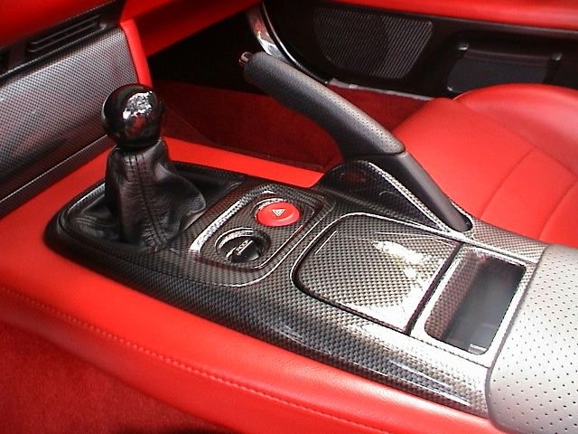

That's not a separate panel, it's part of the main console. It's just painted a different color.
It's very easy to take the console apart to paint or modify it.
Good luck!
-Pete

Very sexy CF console Pete;where can I get one like this?How much?
