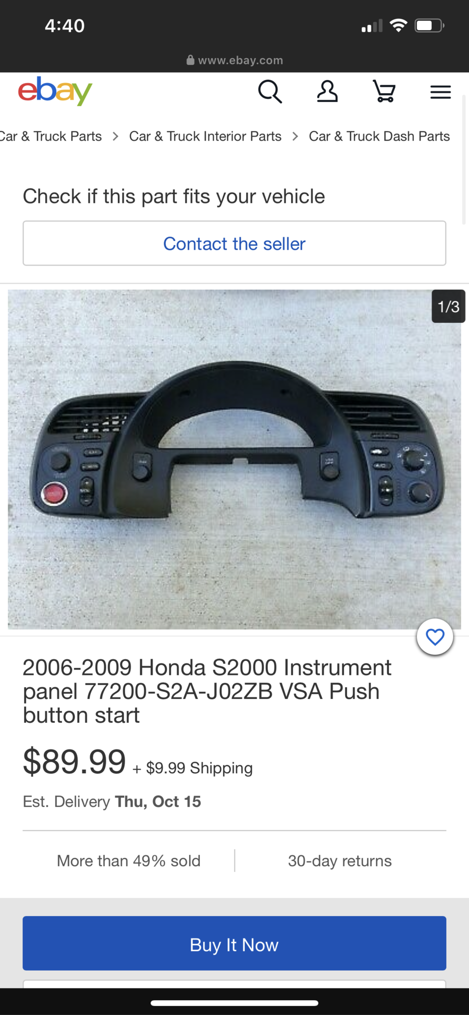

Wanted to see if any of you guys knew of these are plug and play between Ap1 and ap2? I don’t see any differences and some will be listed for sale as 00-09 then others only ap2 years. Thanks

What year is your car? A 2006-2009 panel will have the VSA switch on it. Like you I don't see any mechanical differences in the panels and switches. But I'm guessing too. Color appears to be the only obvious differences for some model years.

Chuck I just wanna say you are the man, always responding. But yeah I’ve been looking and searching I see no visual differences, my buddy mentioned something cruise control related may be diff but button is in the same location so idk.. I may just go for it. My Oem is gray and has so much discoloration and wear and idk why it’s never touched. Also thought about just spraying it black

just swap out the 2 switches with the ones you have now, very easy to do, everything else is the same

The 2 switches on either side of the steering wheel. It varies through the years - defrost / cruise control / vsa

oh okay thanks for the clarification . Yeah my cruise control in my 03 should plug right in but as far as the VSA button on the bezel I ordered I guess will just be for looks haha thanks

As Afzan said, it is plug and play with your current bezel. You will have the cruise button on the left and the rear defroster on the right, if you have no defroster then you will have a blank. Nice upgrade and looking to do the same.
