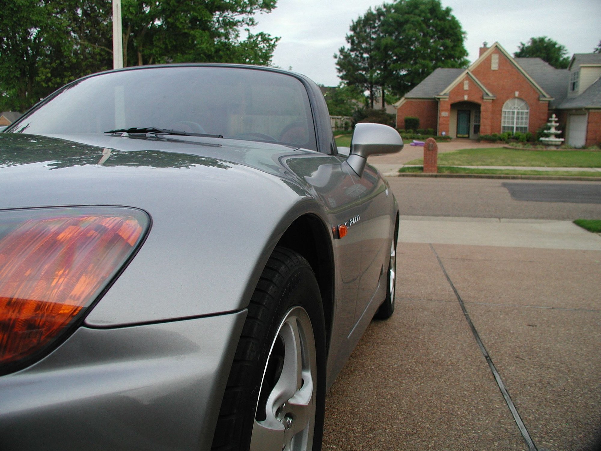

Here's my Eibach drop. I bought it like this, so I can't speak for stock, but I think they dropped like 1.5" or so.
