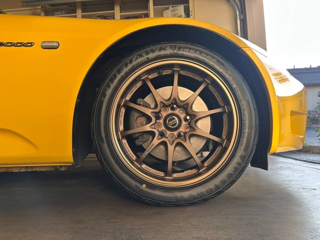

Did the rear axle nut re-torque. Bought new axle nuts, clean and greased face AND threads. Torque to 250 ft lbs. Staked and marked with paint pen.
Afterwards I was finally able to mount the rear wheels. McGard lug nuts and AliExpress center caps.
Bronze wheels go with everything.

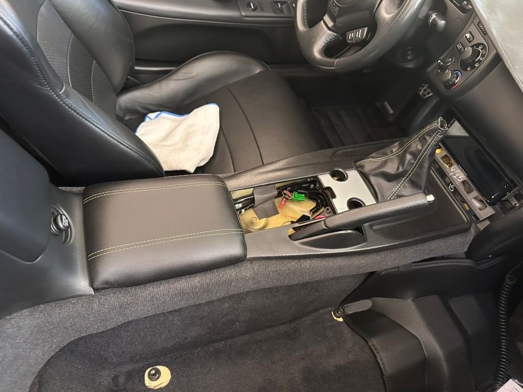

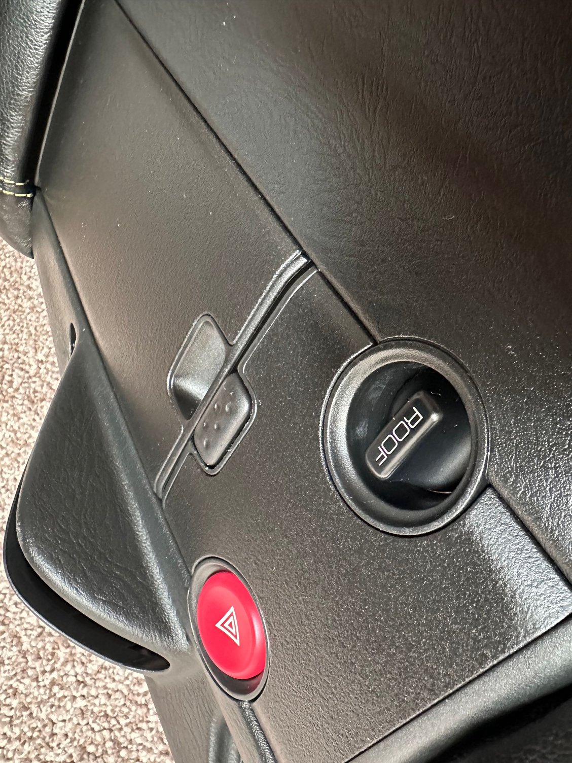

Tested fitted the center console. Thinking of Plasti-dipping or vinyl wrapping the middle trim pieces.

Today, painted the cool silver bits with some Plasti-dip I had. Blends better with the all black interior.

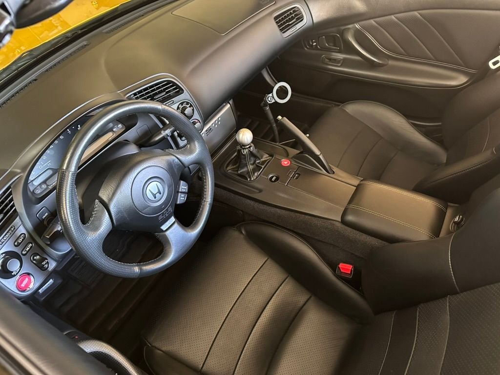

Finally got the interior put together.

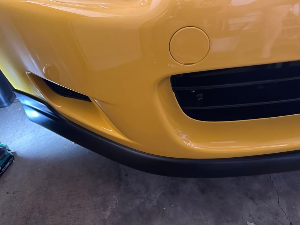

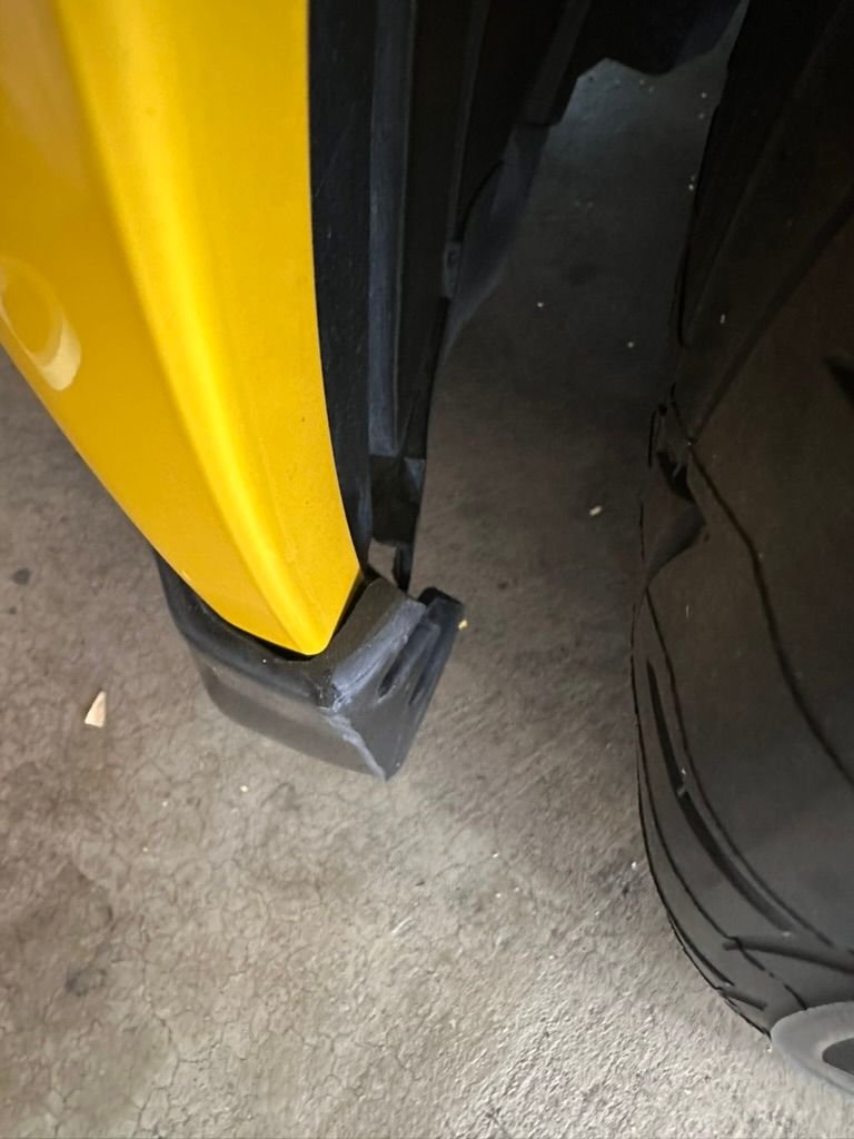

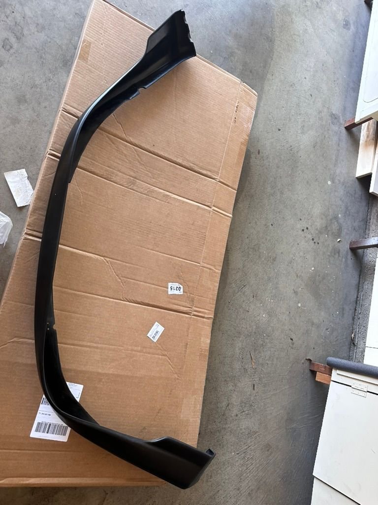

Biggest pain and project that I was not looking forward to was painting the front lip. Im pretty convinced there is no aftermarket lip that fits wells. Needed a lot of massaging with the heat gun.
Biggest pain and project that I was not looking forward to was painting the front lip. I'm pretty convinced there is no aftermarket lip that fits wells. Needed a lot of massaging with the heat gun.

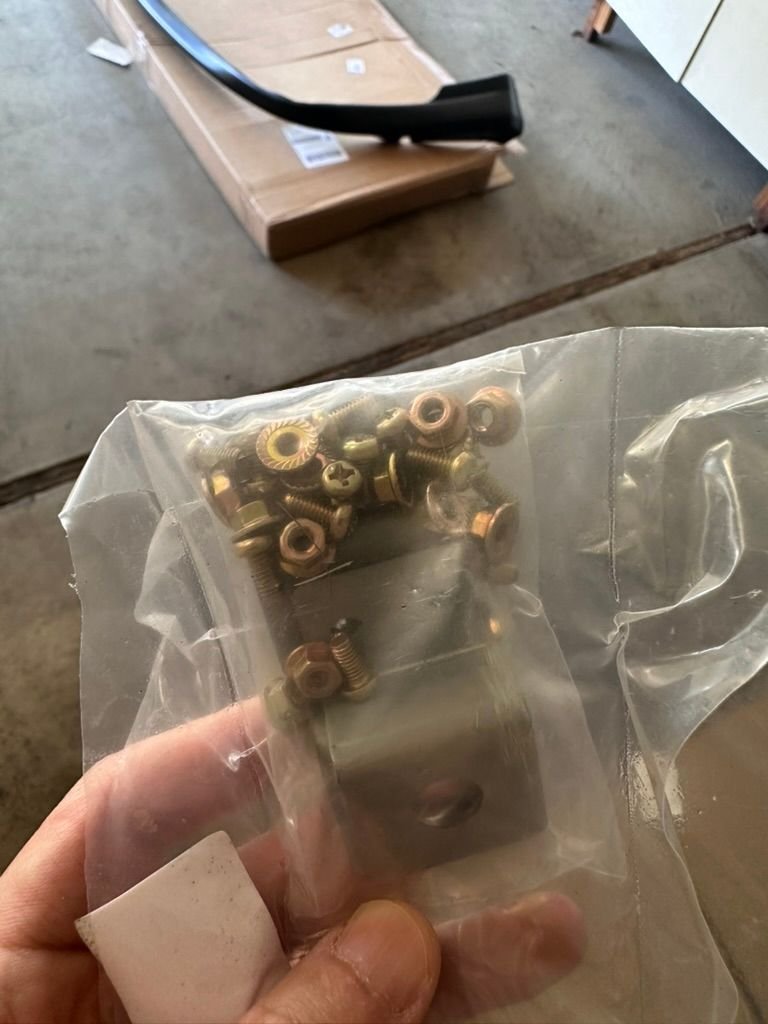

I chose this one because it came with the best hardware. About $65 on eBay.
Easiest way to figure out if a lip is aftermarket -the corners that dont wrap correctly.
Easiest way to figure out if a lip is aftermarket -the corners that don't wrap correctly.
Passenger side wasnt bad.
Passenger side wasn't bad.

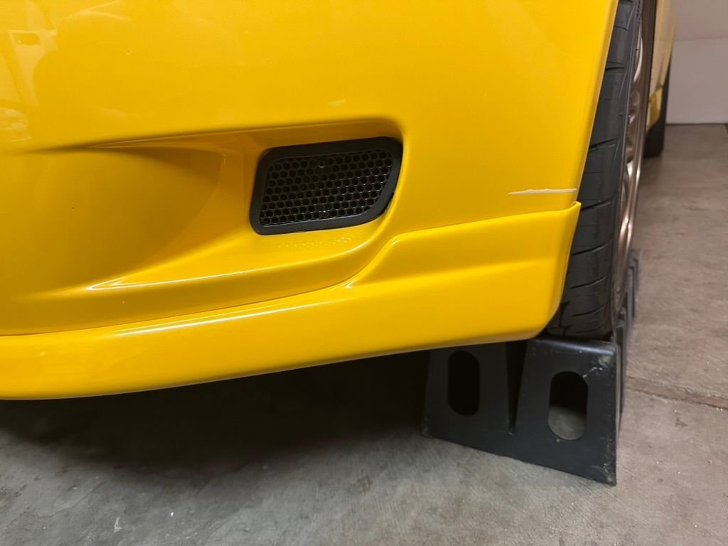

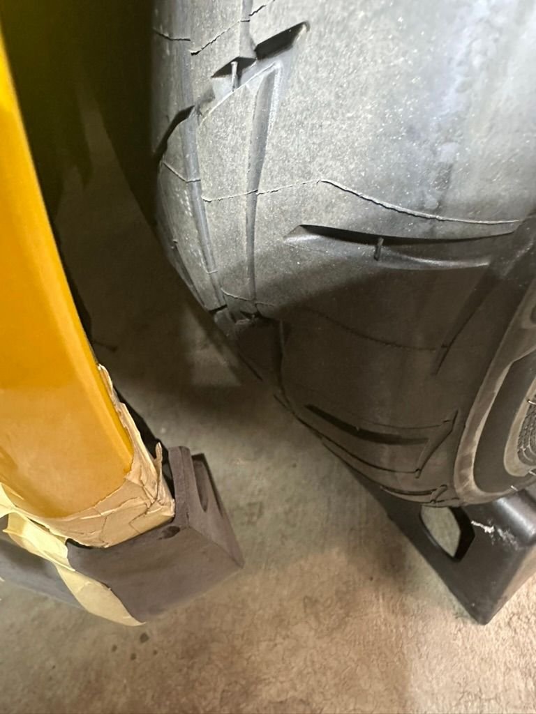

Early fitment.
Early fitment.
There was a lot of test fitting, trial and error, shaving, sanding, heating, etc. Hardware was good but I ended up having to drill some of my holes to make it fit better.

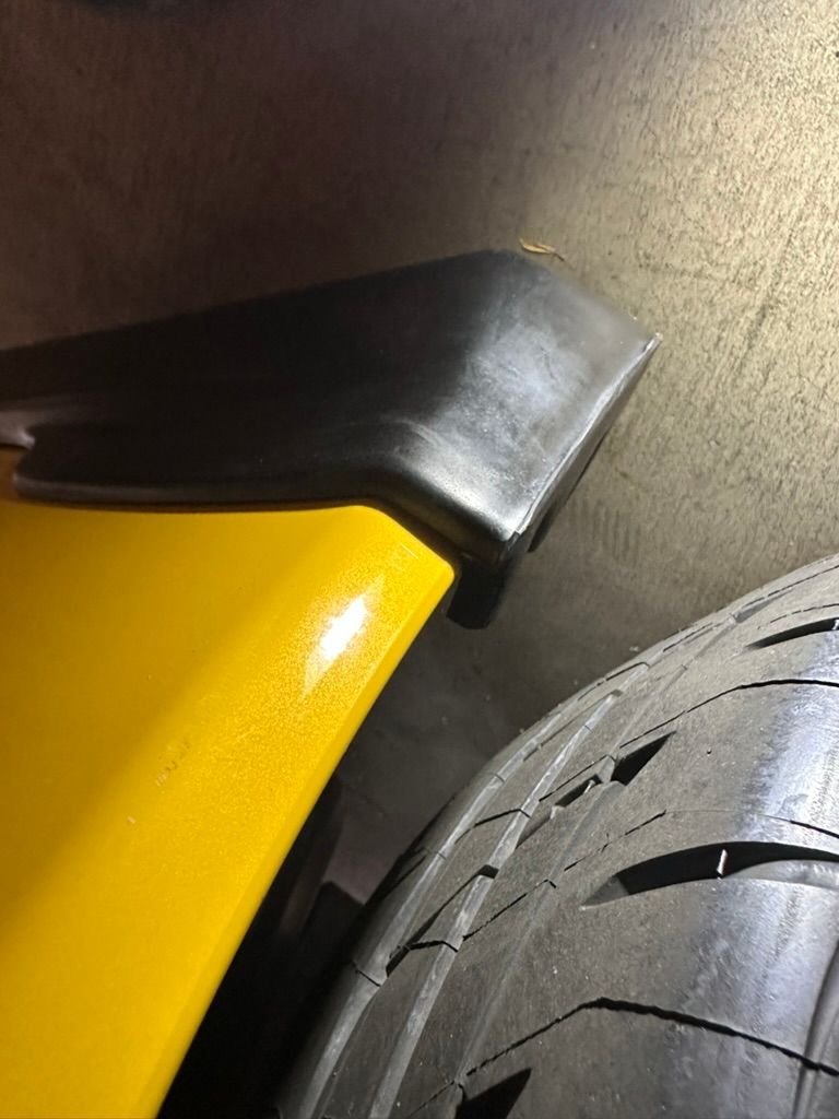

After a ton of shaving, the drivers side looked better.
After a ton of shaving, the driver's side looked better.

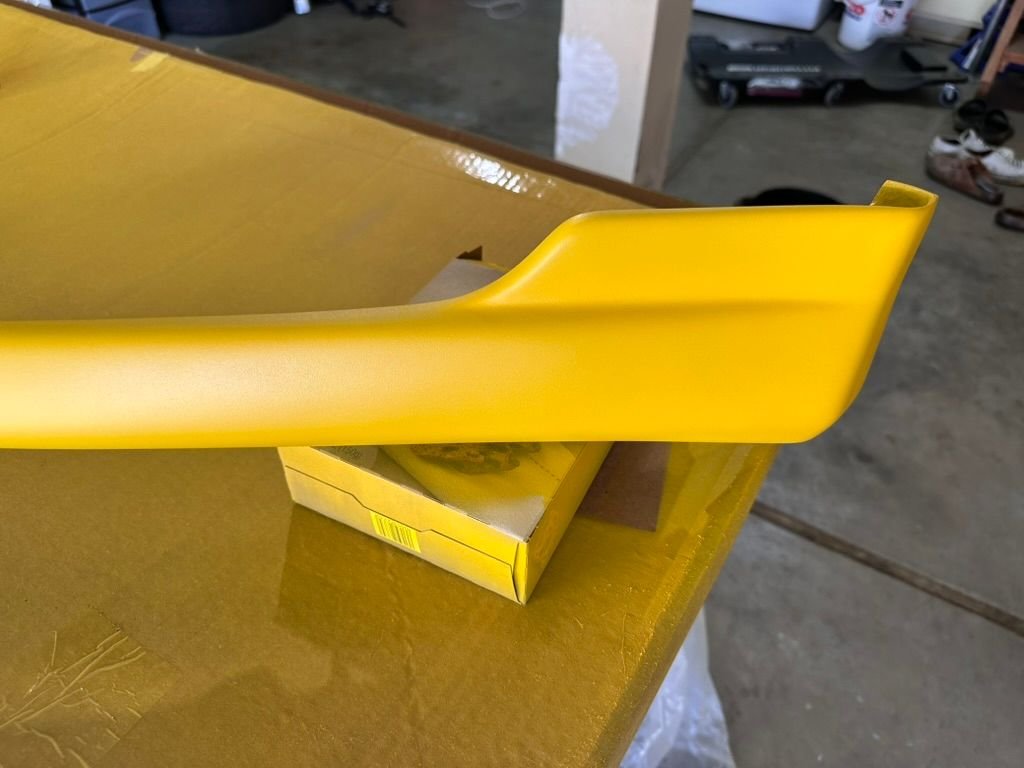

Got some touchup paint from online. The Spa Yellow from an Acura NSX was actually cheaper than the S2000.

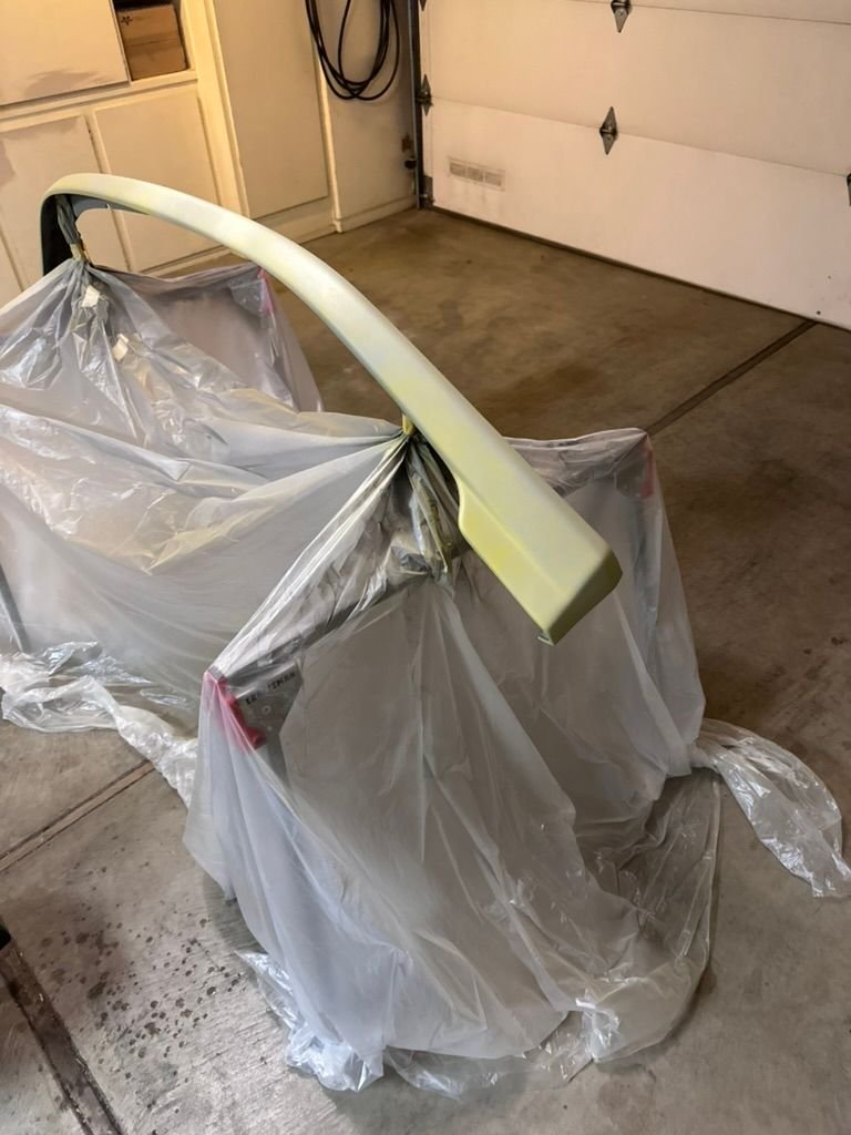

After sanding the whole surface and using Sprayway glass cleaner and a tack cloth, I used adhesion promoter and a can of primer.
Hard part was color matching. I ended up using almost 2 cans of base. about 0.5 can of mid coat and a can of 2K clear. Use a respirator.
This after a few mid coats.
Its important to frequently compare the color before sealing it with clear. Yellow tends to fade and I dont think I would ever get a 100% with rattle cans.
It's important to frequently compare the color before sealing it with clear. Yellow tends to fade and I don't think I would ever get a 100% with rattle cans.

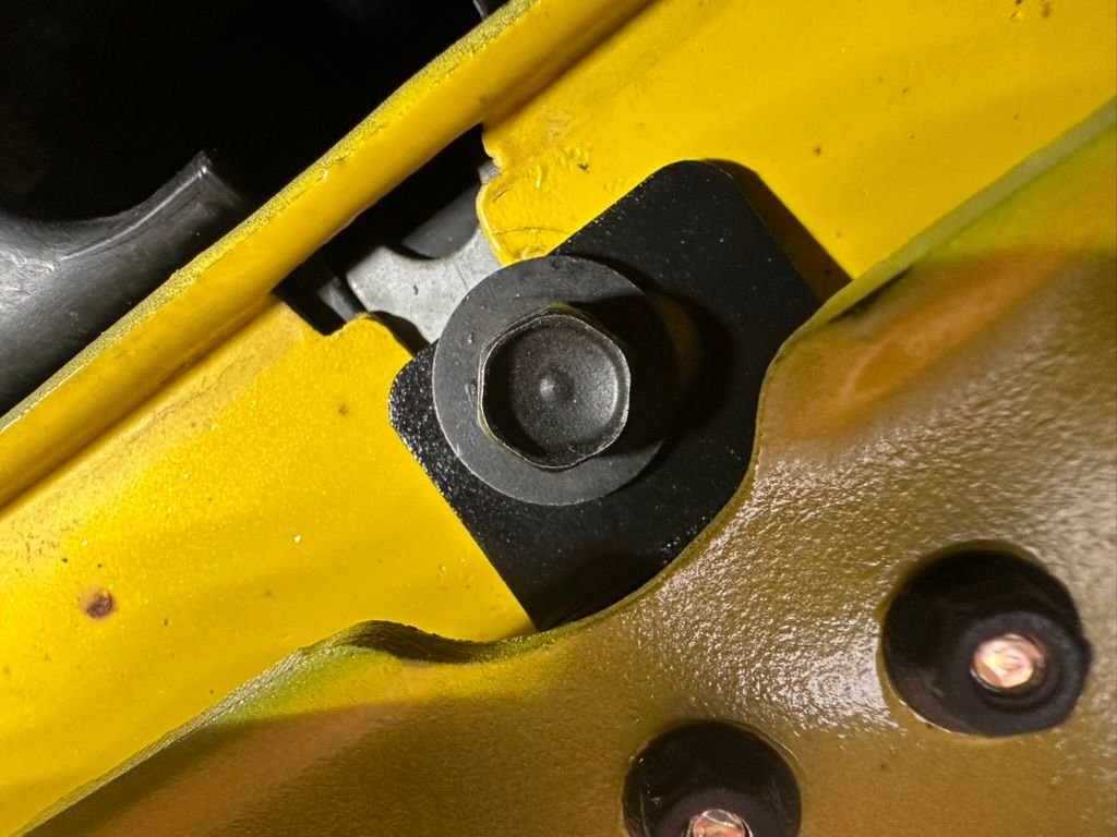

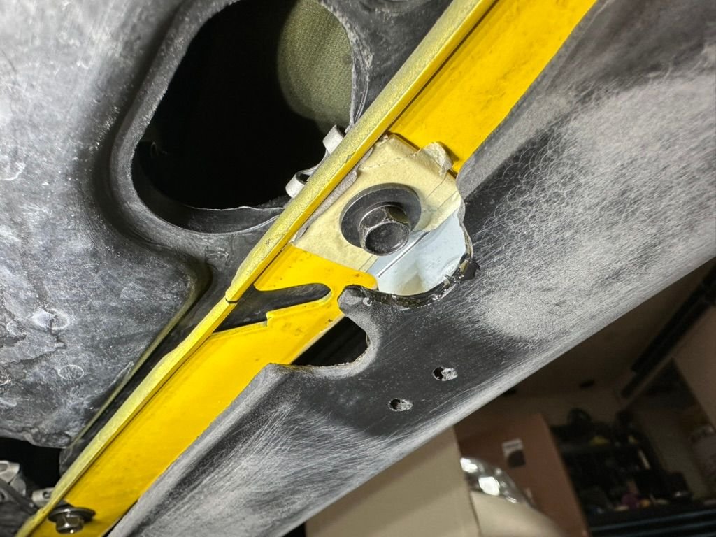

Since I had a splitter I wanted to use with the lip I ended up buying Auveco Body Bolt 22906 from Autozone. They're longer and allowed me to use the existing mounting points.

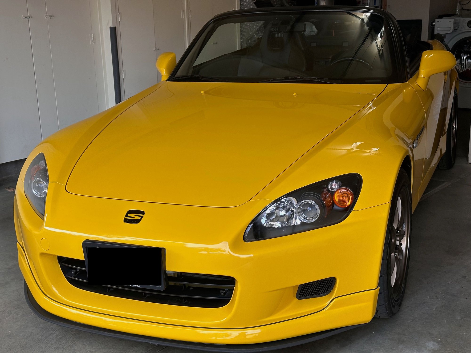

Here is the lip fitted with Honda OEM weather seal, front splitter. After 2K clear, had to wet sand and polish/buff.

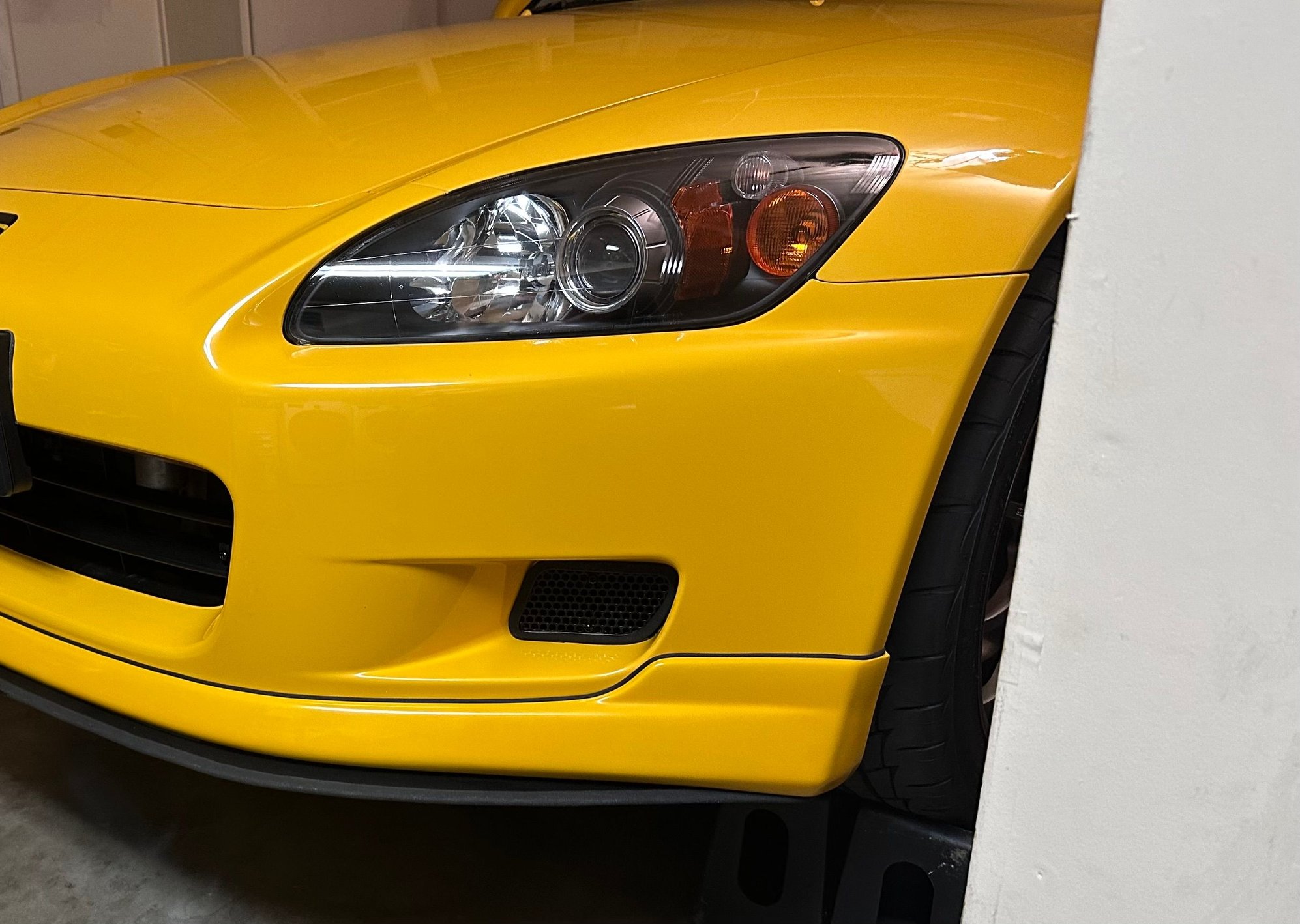

After a quick rinseless wash
