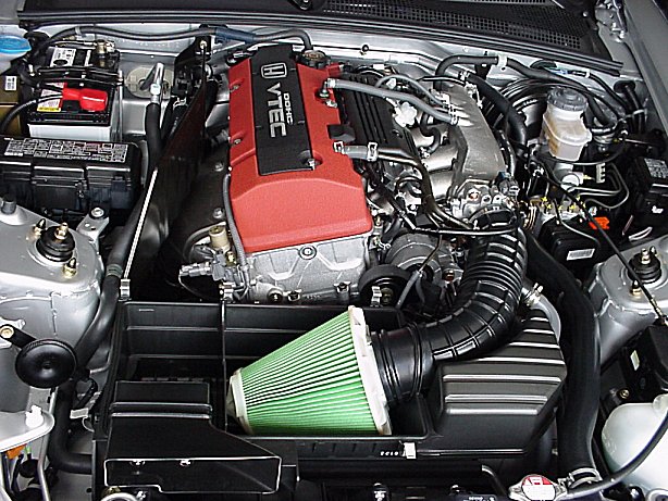

i did a little study on this issue and found taking the cover off increased intake temperature by at least 40F in summer during a 15 minutes freeway cruising, while stock air intake increased by no more than 20F. with this data, it's hard to believe taking off the lid will improve performance.
my ghetto solution to cold air intake is to insulate the intake box and top of radiator with aluminum. with this set up, i am able to achieve zero( or close to zero) temperature gain compared to ambient temperature.
if you want loud exhaust without power loss, just chop off the resonance box connected to the air filter housing. this will increase exhausted significantly especially above 5K rpm.
