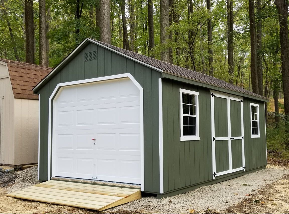

I figured I'd update everyone on the Garage with a picture! The quality is astounding. I could not have built anything this good for the price paid. 12x20 with a 9 foot rollup door.
I will be putting the car into storage shortly - I just need to build up the ramp with some stone that will be delivered tomorrow (you'll notice a 3" drop from the diamond plate/floor sill of the garage to the ramp).
I had a follow up question - being this is in the backyard, it's not heated. Temps in NJ get down to the teens or single digits over winter. I've been trying to get a solid answer on if it's OK to leave the summer tires in place. They are Firestone Firehawk Indy 500s, and I've read conflicting information on whether it really matters. It seems to matter more about moving the vehicle in frigid temps rather than the tires just being on the car in storage. Any thoughts on this? I don't have a spare set of tires to swap just for storage. I considered pulling them from the car and storing them in my basement, but then I have concerns about leaving it on jack stands with the suspension unsupported.
Any thoughts?

Very nice outcome on that garage. I like it.
I wouldn't worry about the tires. It isn't like the old bias ply days where you get flat spots. I would NOT put it on stands. Put a bucket of DampRid in the interior to deal with changing temps and humidity. Also put moth balls in pantyhose for the engine bay and steel wool in the tailpipes for varmints that may sneak in.

That garage looks solid! God damn, those amish do some great work for affordable prices.
