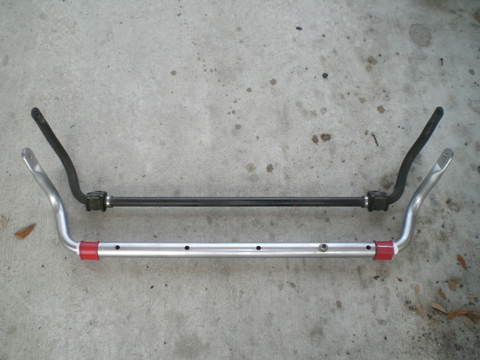

i dont even know where these bars go. anyone have pics for a noob? I know the comptech bar goes over the intake over both shocks or whatever but wheres the rear?
And would they make a significant difference?

So the CR is 22% stiffer than what?
anybody have a FSB, RSB comparison between oem 00-01, 02-03, 04-07, 08, cr, etc... ?!
Old Nov 5, 2007 | 03:59 PM
  #24
dead-bird's Avatar
Joined: Oct 2004
Posts: 74,594
Likes: 7
From: Pensacola
Stock and Comptech
Comptech installed
