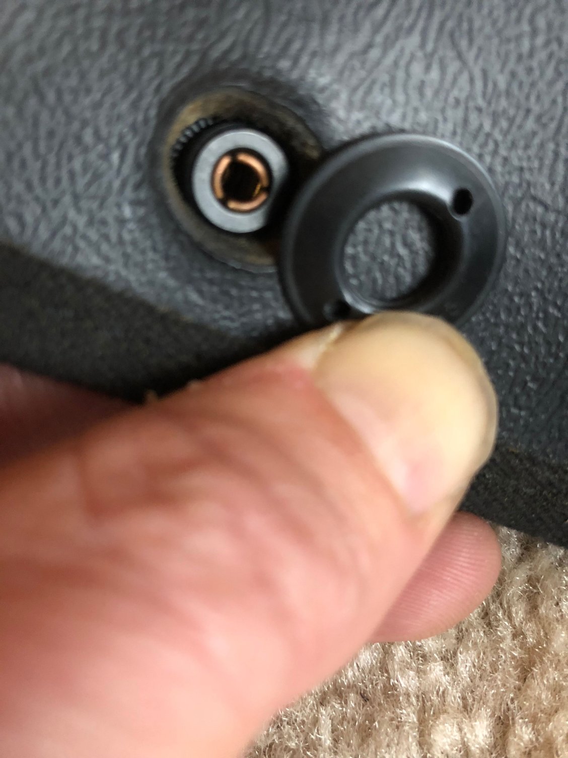

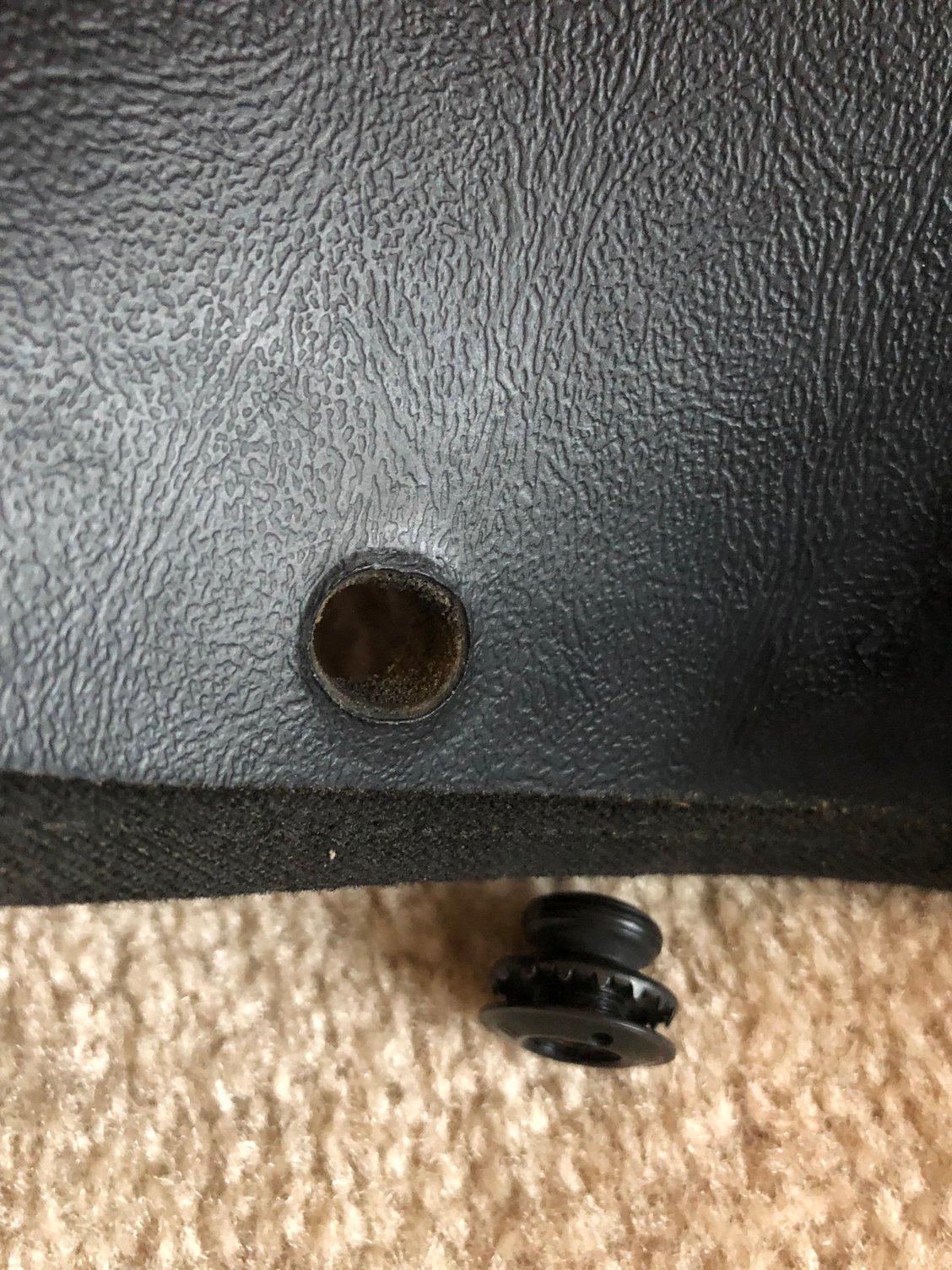

My tonneau cover lost one of the female hooks. I have purchased the replacement part and figured out that you have to unscrew the parts. However, I can’t figure out how to condense the actual cover enough for the thread to make contact so I can tighten it. Is there a secret or is it just a matter of being determined to make it work? Thanks - Scott

Hmmm, I had the same problem on my 09 a few years ago, as far as the female portion went AWOL. I got a new part from the dealer but I don't recall having difficulty installing it. From you pictures it looks like you have a raised "ring" from the material being pressed into that shape for some time. I would either heat it with a heat gun to make it pliable (or hot sun if you live in Arizona) and if that does not work, try trimming the high edges with a razor,exacto knife, going slowly. You don't want to make the hole too big for the clamp nut to work.
