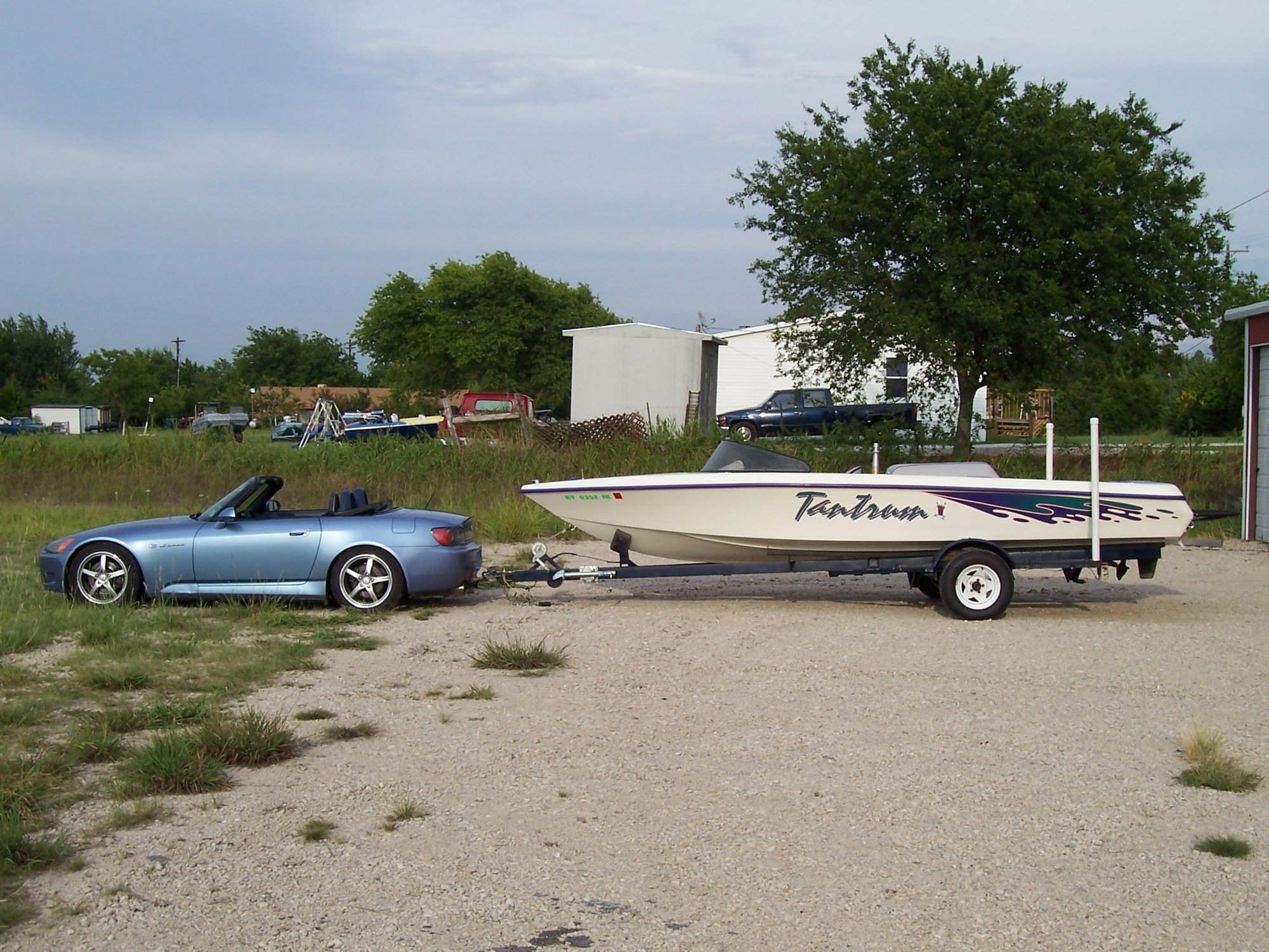

700 is kind of a lot. There are some people who haul tire trailers with two sets of tires... but that total setup is still probably <500#.
I know "dead-bird" pulled a little camper trailer all over the place without a problem. Don't know how much that thing weighs, but maybe still less than 700.

DB's tailer is more than 500lbs, easy.

i get a feeling that boat plus trailor is more then 500 easy..

Yeah it was. but if you read that thread. He only drove that a mile or two.
