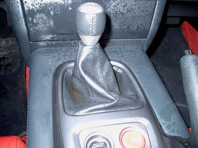

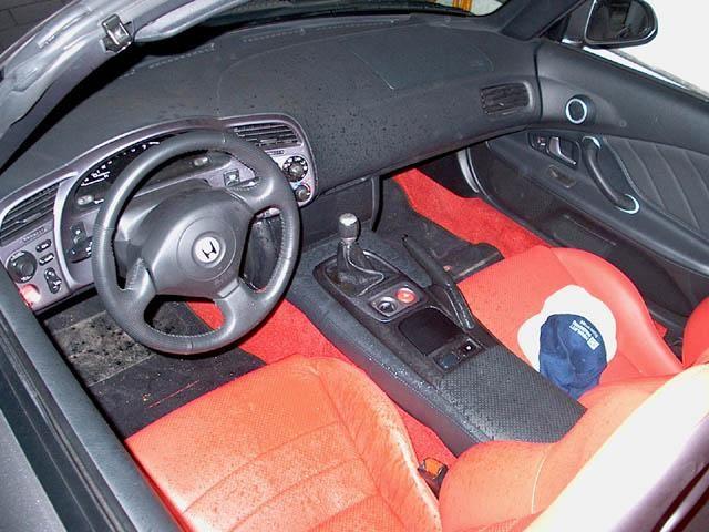

I store my baby in a garage of an old building. The last 2-3 days we've had continuous rain. When checking for her yesterday evening I found this :
Reaction was this:
Water dripped from inside (!) the building into my car. Target was between shifter and ashtray. Now who's insurance is gonna pay (mine or the garage owner's) if there's any permanent damage is not of concern right now. What I need to know from you guys is this:
1) The water was running through cracks in concrete and therefore is likely to be acidified. What do I do as immediate steps to protect the leather ?
2) There's water in the middle console and the switches. I was able to lift the cover from the rear end but got stuck at the brake (didn't want to apply more force). How do I remove it without damaging anything ?
Thanks for the help !
This sucks so much !! damn... fortunately the headunit was protected by the lid..

Sorry, I couldn't wait for answers here and took her to the dealer an hour later...
Of course I dried as much as possible right after I took the pictures (and before creating this thread - actually I ran down to the garage - camera in one hand, towel in the other).
While driving to the garage I had a/c on, fan @ max, heat @ max. (and me sweating and swearing @ max )
Once there, they removed the plastic cover on the middle console (6-8 clips, pushed in a soft plastic stick and pulled gently) and - what a relief - it was nearly dry below. Only some water on a plastic ring of the shifter.
It appears like the seats and carpets didn't suck up that much water.
Regarding the switches the dealer stated, I needn't worry that much, they certainly designed them with the fact in mind that they could get wet from time to time.
So, with help of A/C, wind and sun, I dry the carpets.
On my way home I bought a plastic canvas 6x5m which hovers 2m over my baby now - looks silly but hey something's at stake here !
Sunchild: Yes, I've found your thread in the meantime - unfortunately it was one of the last ones when searching for "water". I'm very sorry about what happened to you! My baby fortunately wasn't a real aquarium yet (only the shifter) and the damage wasn't that bad as to replace any part (yet). To be honest, I paniked at first but after seening things at the dealer, I'm much more relaxed now. After cleaning things I think I could nearly forget.
