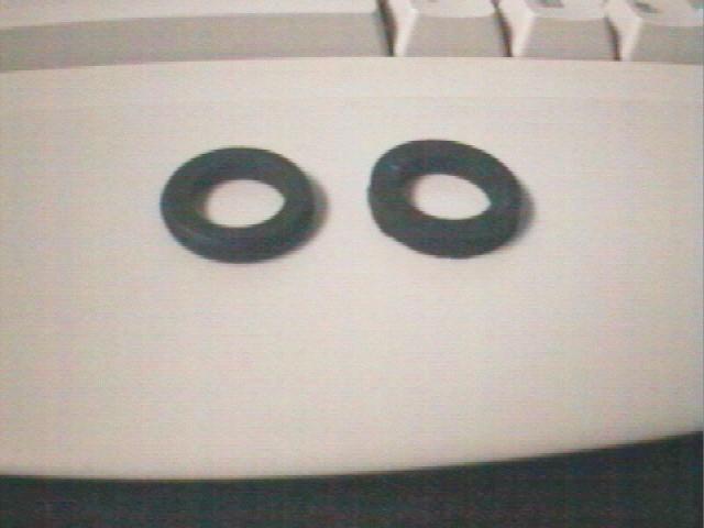

Code3Smith- I did order with the part number you posted. The fact is, they are still made for a Civic. After a few simple mods, mine fit great! Thanks again for the suggestion.
[I realize these are quite possibly the worst pictures you have ever seen]
Anyway, this is what I found to work the best. First of all I took the rubber washers out of the stock side markers and replaced them with the rubber washers that came with the clears. The stock washers are rounded and make the bulb easier to lock into place. (the left washer is the stock washer)
Next I used a utility knife to shave around 1/16" (give or take, you'll be able to see if the side marker is rubbing) of plastic off of three places - both ridges to the right and left of the metal clip and above the clip itself.
Finally I removed the metal clip and shaved between 1/8" and 1/16" of plastic from the indent where the clip retracts. I did this because mine came such that the metal clip could only travel about halfway back. Shaving this extra plastic allows the clip to bend all of the way back, making it easier to install / uninstall.

Awesome.
Thanks a bunch for this information and the photos. If the bulbs go out and you have to remove these side markers, what are you supposed to do if they fit really tight?
You just provided the solution.
Thanks, again.
