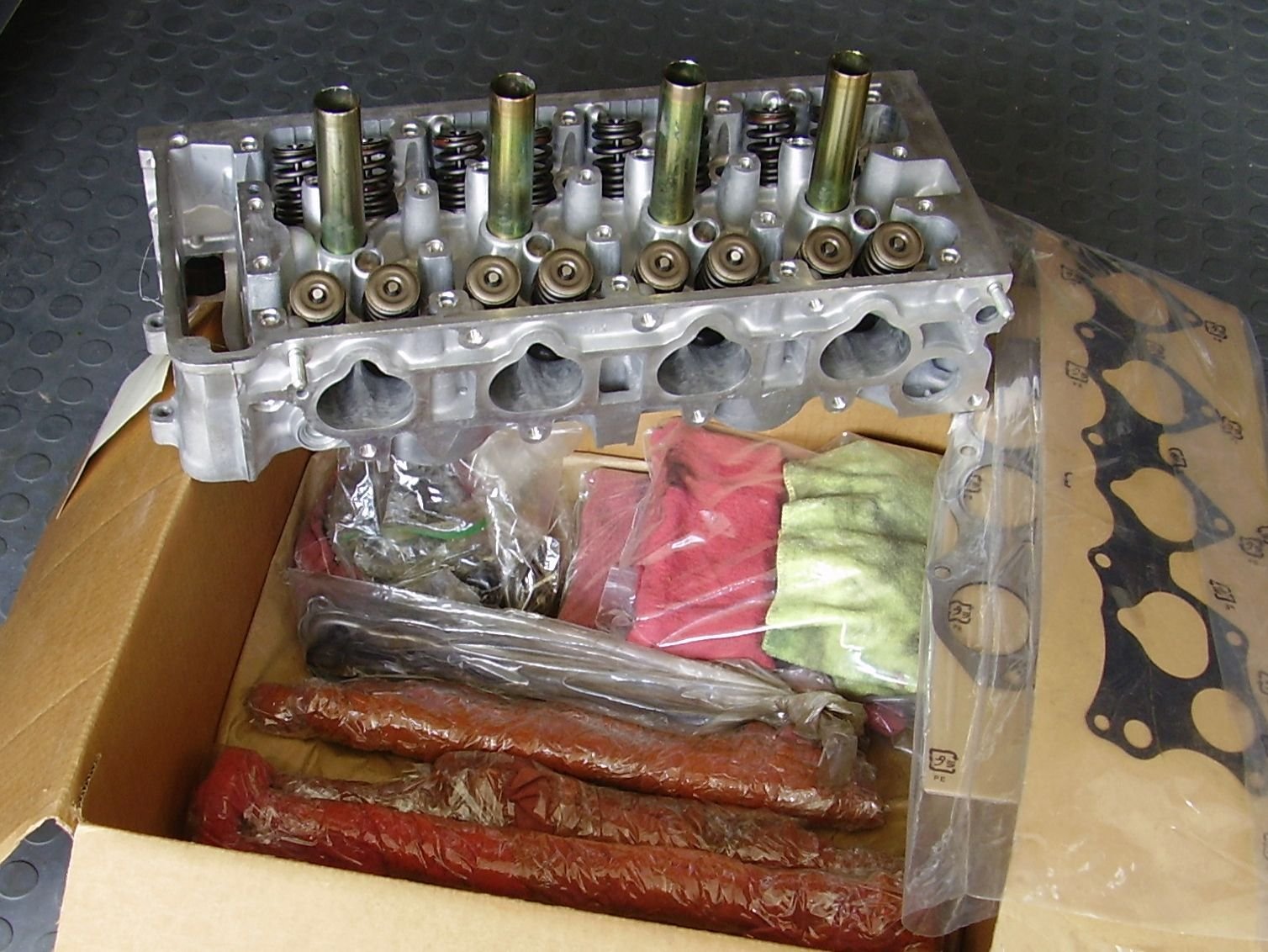

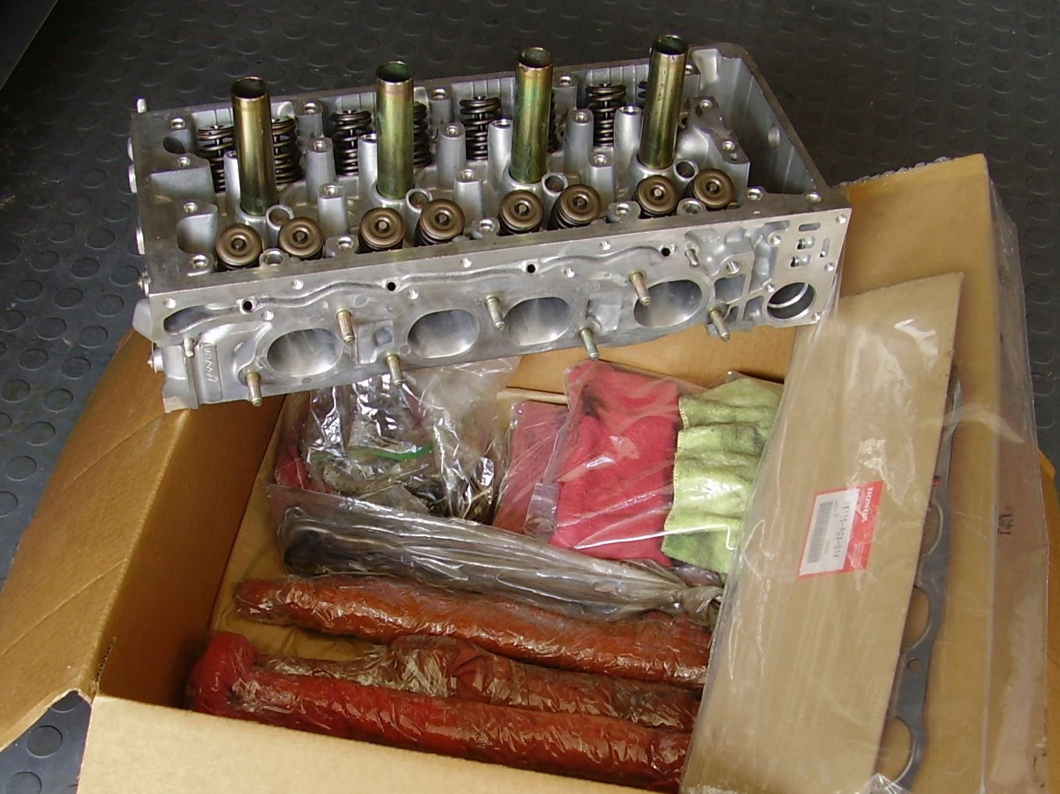

You have it apart, go for stainless steel valves AP2 retainers and a nice port (matched to your intake and exhaust gaskets) and polish job. The valves will cost about the same as OEM but there billet stainless steel (made of one piece of metal) and a bit lighter. The AP2 retainers are proven to be a little better/stronger. The port and polish will make the movement of air more efficient
This is a standard stage 1, bordering on a stage 2 upgrade that your factory ECU will support without issue. A full stage 2 would be heaver springs and a 3 angle valve job.
Stage 1 head
I can post a stage 2 head as soon as I finish it today or tomorrow
