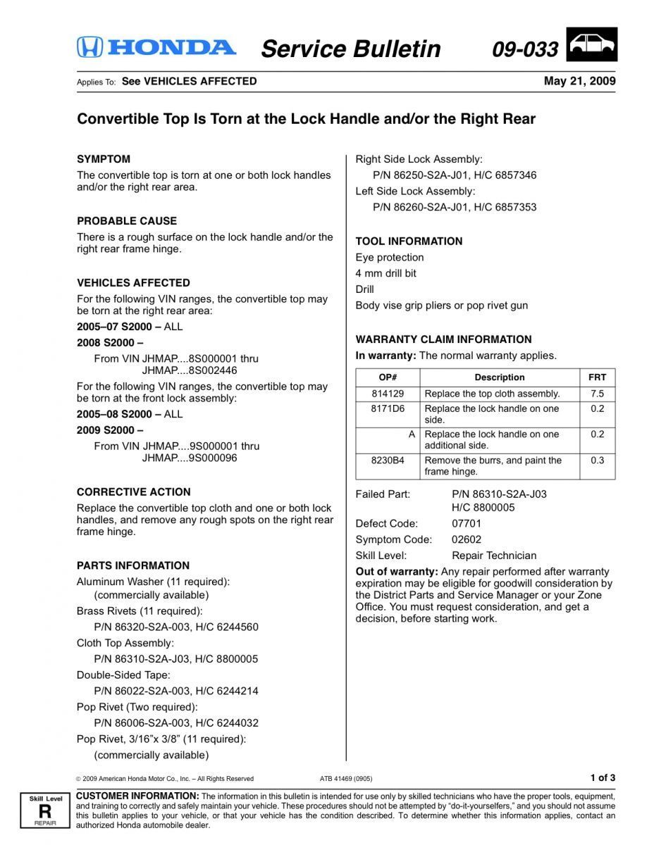

Here's the TSB, it pertains to 2005+, although i have found this on some earlier models as well
picture_php_pictureid_527673_9c9d15529753a9ea2ad4f e78221d6b2d89f8643d.jpg (928×1200)
