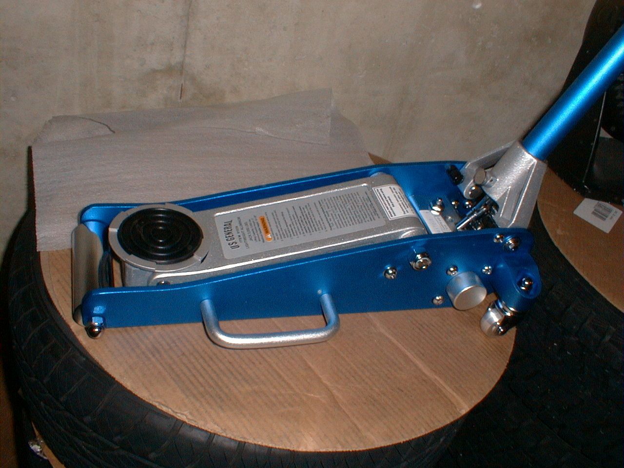

I use this one. It sells for 79.99 now, I paid 100.
  • Minimum saddle height: 3''
  • Maximum saddle height: 15-1/8''
  • Handle overall length: 23''
  • Two piece knurled aluminum handle prevents slipping
  • Overall dimensions: 20-1/2" L x 9-3/8" W x 8" H
(Click on the Jack for a link to Harbor Freight)

Stratocaster, where can one acquire that jack?

I got it from Harbor Freight. The picture of the jack is a direct link to their site. It can't hit the front jack point on our cars, but only 1 or two jacks can, and they cost 500 +.

Let me make this cheap and easy for all of you. Buy the Harbor freight low volume jack that Strat is showing, or the high volume jack that looks the same but costs about $40 more. They are both very light. The high volume will raise your car off the ground in 3 strokes.
No matter whcih one you buy, leave the Honda jack in the trunk. You can either;
A. Jack the car from the side jack ponts with the harbor Freigt jacks with no problem and lift either side of your car or,
B. Use a couple of 2x6s about 2 or 3 feet long. Lay them in front of your front tires. Drive on. Now you have all the clearance you need to get the Harbor freight Jack under the front of your car and reach the factory jacking saddle that will lift the front of your car.
Hope this helps.
