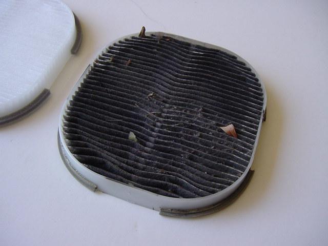

I did my 30k service with the help of Gilcwong today. As part of the service, the AC pollen filter is to be replaced. I bought the filter yesterday at Hopkins Honda in Sunnyvale and the parts guys were shocked that this filter, a plastic ring with pleated paper, cost $40! So I was joking with Gilcwong that since I drive top down all the time, what use is the filter.
Anyways, we finished all the fluids and plugs and finally got to the filter. When I removed the old filter, I was immediately glad I bought a replacement! Check up the ugly sight below. Anyways, I would recommend that you check the filter and replace it on accasion. i am glad I did.

holy sh*t! I have 10,000 miles on my '01.. maybe i should check it out....

The dirty filter reminds me of some of the smokers' lungs I have seen. City folk also tend to have 'dirtier' lungs.

Take note of the angle that the filter/housing is installed before you take it out, because you'll have to duplicate that angle to reinsert the new filter/housing. There are three plastic clips that are integral to the filter housing that hold the filter in place. You'll have to bend them back to get the old filter out. My old filter was dirty after 15,000 miles, but nothing like the one in first picture in this thread.

Yeah, I should have ordered from H and A and saved a few bucks, but I did not get realise I needed it until saturday. Oh well. Either way, I am glad I got mine changed. While the filter does seem redundant for those of us who drive top down most of the time, I think its still a good idea to have a new filter in there as it will increase the airflow the vents can pull in, and prevent any of the "stuff" to get into the vents. My filter had all sorts of "stuff" caught in it, both organic and inorganic.
