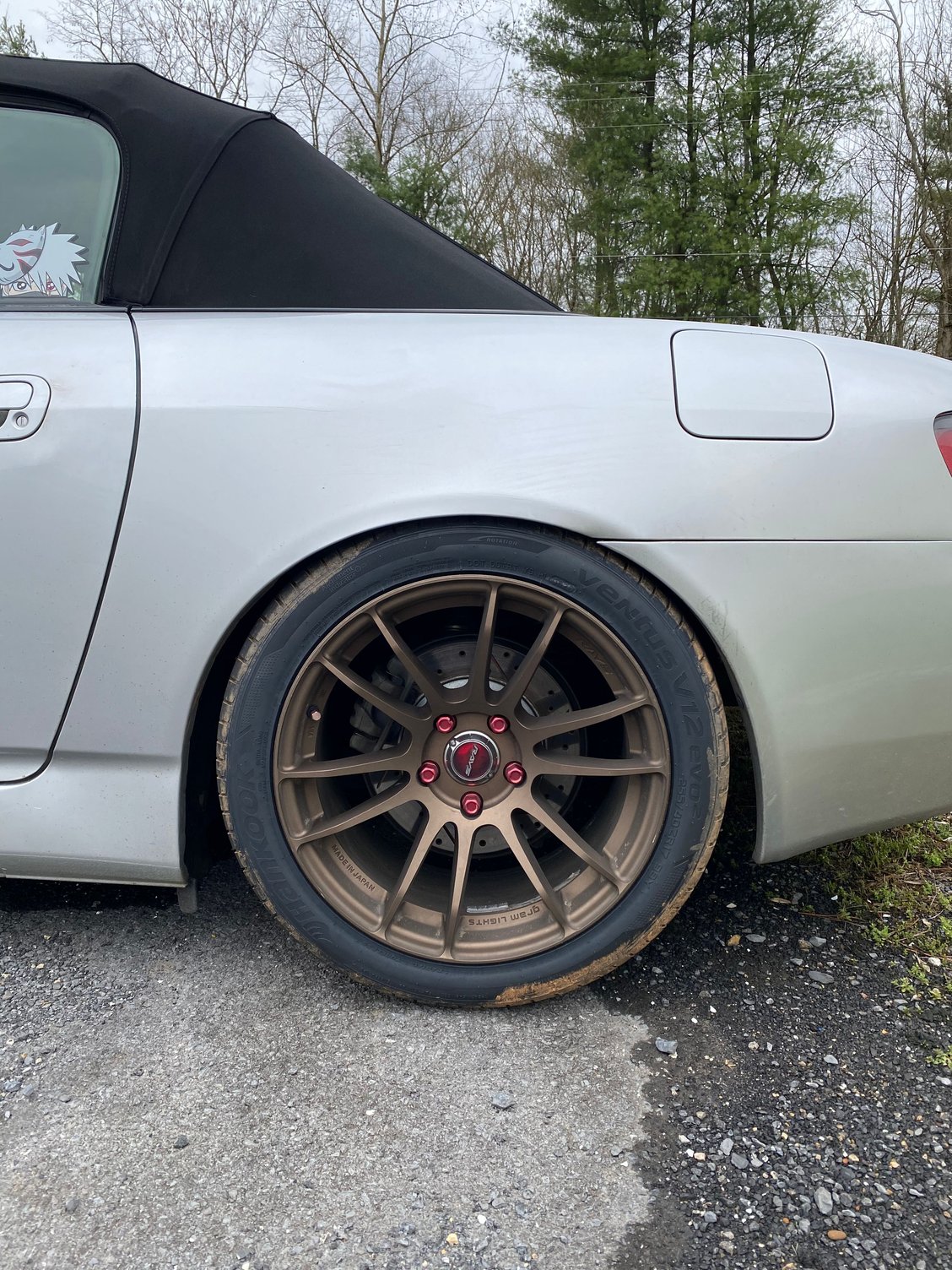

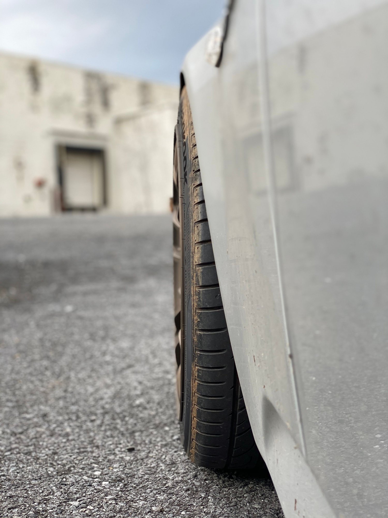

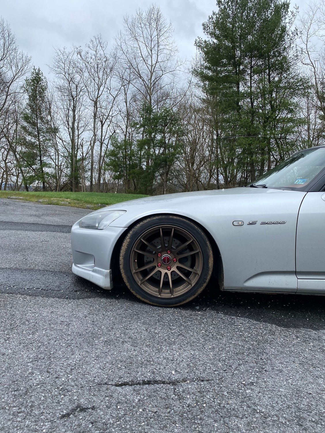

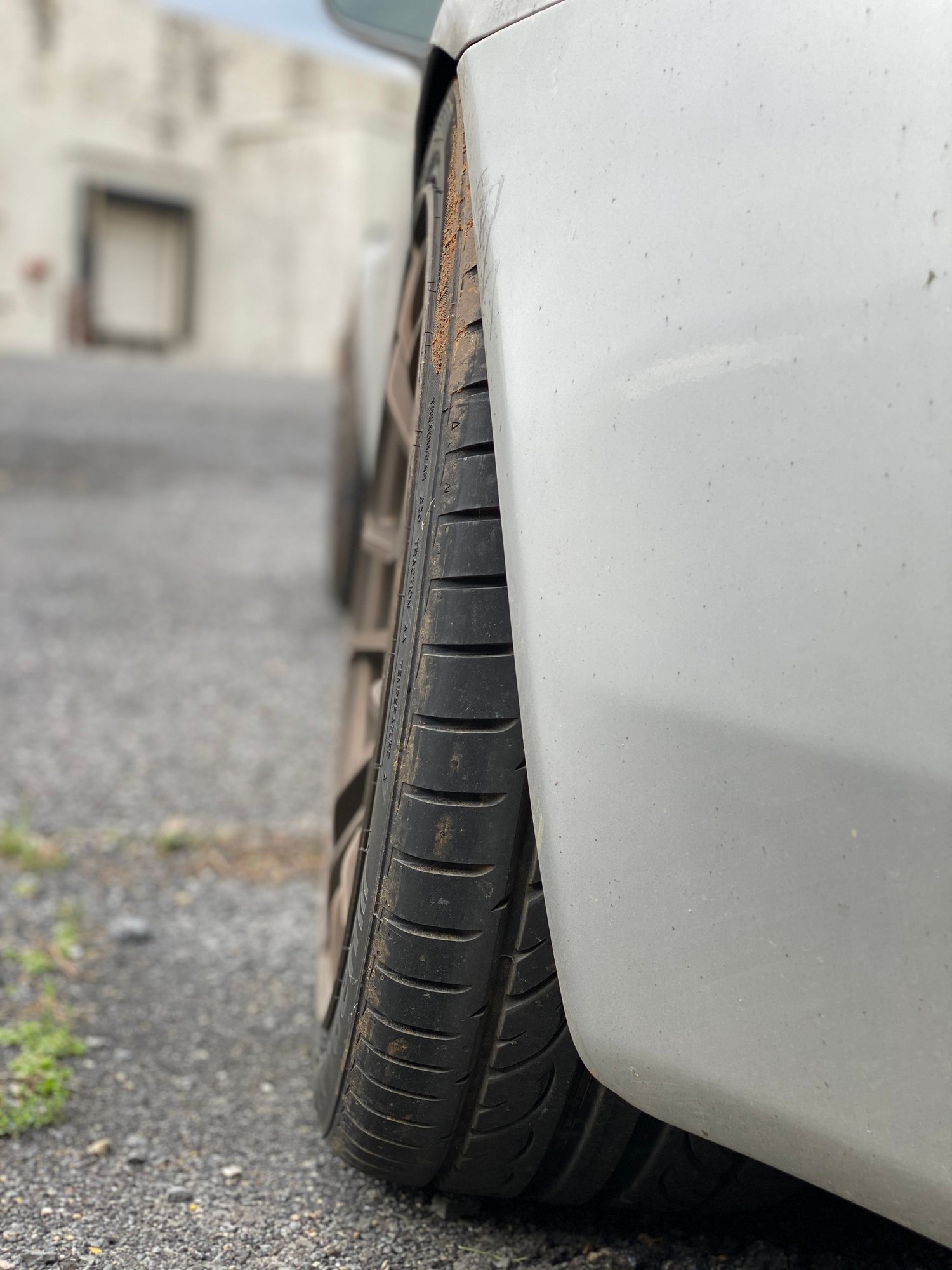

I’m dropping my car off Monday to be aligned after new rear tires . I’m assuming they are just going to go by some Oem S2000 sheet unless I tell them otherwise and my car suspension and setup is a bit far from Oem at this point. I’m on Coilovers lowered maybe a inch 1/2 or more , on 17x9+40 squared wheels with 245/40 front tires and 255/40 rears . It’s about a finger gap in between my rear bumper tab area and wheel not in height but just space inbetween the tire and the fender itself so it’s pretty low/tight . Also in the front it’s about a finger squeeze between front tire and fender tucked just a little bit. I’m not sure what info is needed to at least give me an idea of where my specs should be but I’m open to awnser or hear anything.

Not sure if there help but to give an idea of height/fitment

previously before I put my new rear tires on 255s from 245s my car was like a go kart in handling . Then after the new tires everything feels out of whack and the car is kinda sketchy . The front is loose, the steering is somewhat light and untruthful and it’s a lot of I guess you can say play in slight adjustments when Turning or adjusting the turn of that makes sense. I’m assuming this is all because I need an alignment , tire pressures are checked . Also here is some pictures of how my wheels currently sit and I’ve never adjusted any camber etc this is just natural from lowering car
