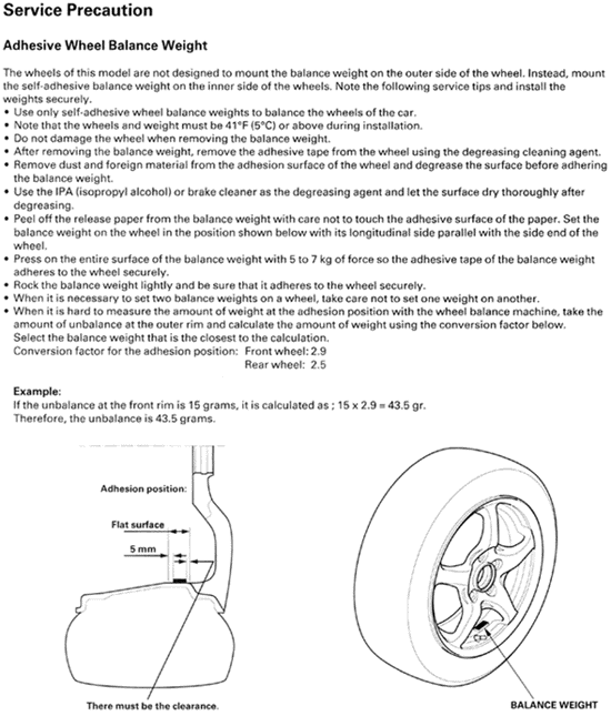

I don't have the service manual here with me, but I remember reading that they should be placed on the flat narrow ridge in the center section inside the wheel.
UPDATE: Page from service manual posted below.

Old Feb 16, 2001 | 06:29 PM
KenS2K's Avatar
Posts: 51,814
From: par•a•dox
Here's what the service manual says:
