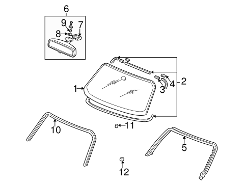

I can try to explain. In my case, I have a PGW windshield. It was delivered with mirror mount already installed. My last replacement windshield did not have one already installed. It used the one from the prior windshield.
The OEM mount was a wedge shaped. Meaning the top is thinner then the bottom. The PGW mount is not wedge shaped, the top and bottom are the same thickness, and the same thickness of the top of the OEM mount. This means the OEM mount cover will not snap back in place either.

Which part below is the mirror mount that is supposed to be wedge shaped. Can the replacement part be ordered without the entire glass. Can the part be taken off my original factory windshield (not sure if they still have it). I originally asked for PGW, but you are telling me that it has the same issue. I am sure a ton of people have had their windshields replaced (most of them had to have been non OEM). Are people just ok with this. Is this an installer issue?
