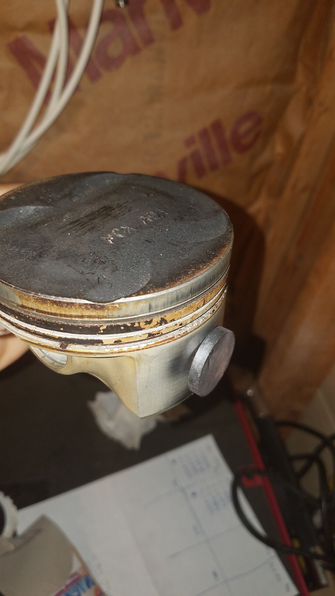

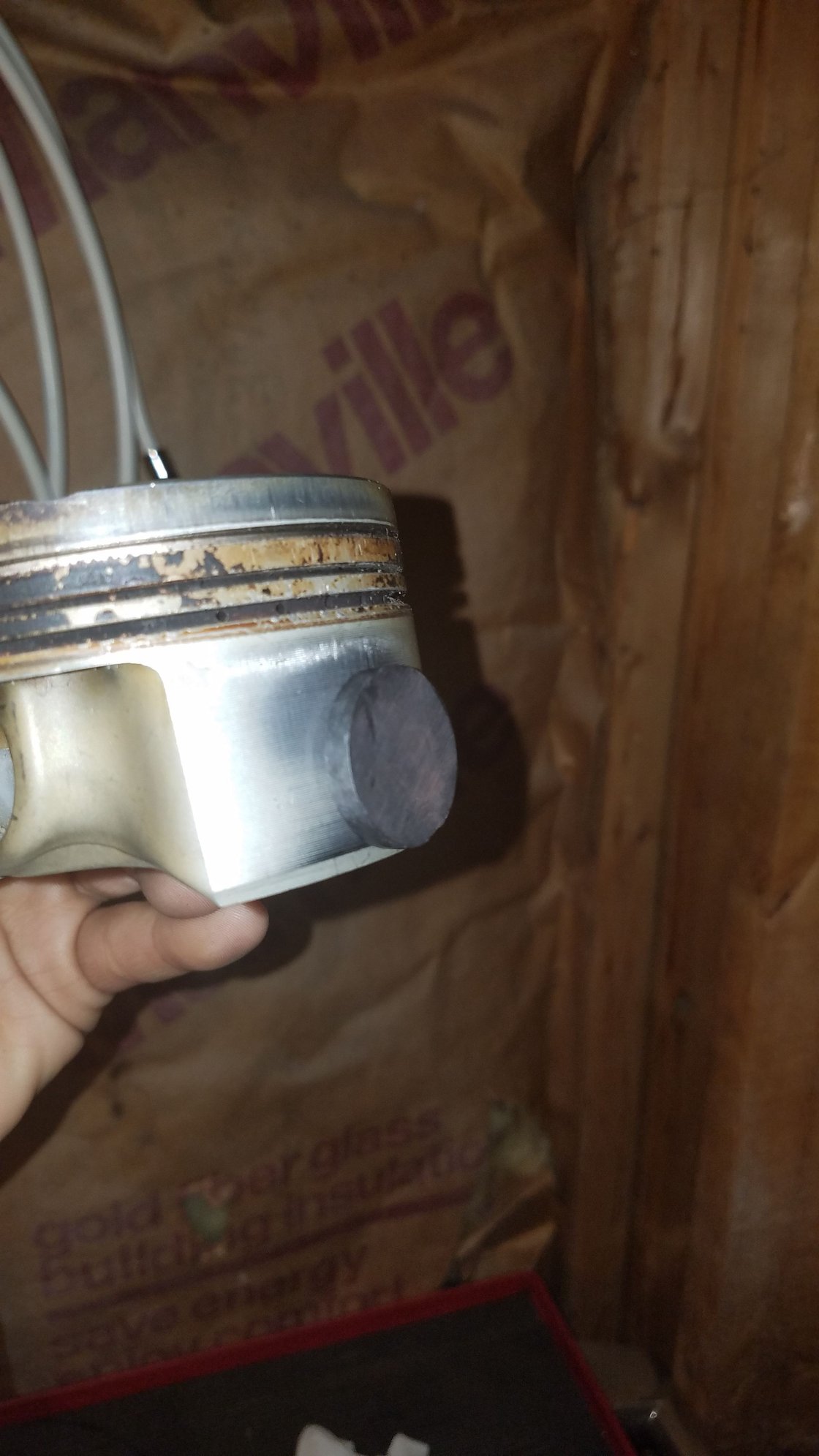

What I stated was that the piston was iron PLATED, not that the piston is made of iron or magnetic. The pistons require an iron plating otherwise they would scuff the aluminum. If the pistons are not iron plated, then how can you explain this?
