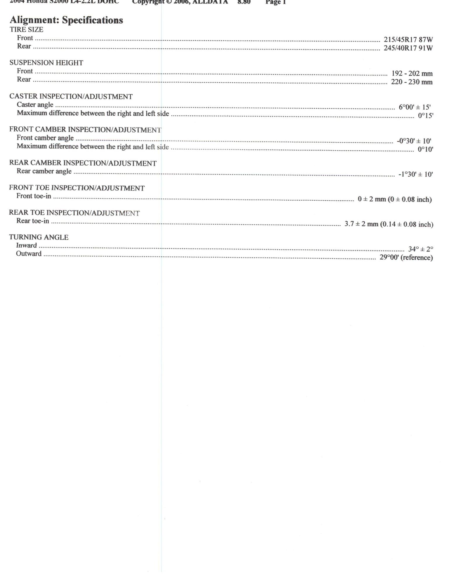

Hopefully your car hasn't exploded yet! I've been shopping around for a good alignment shop since I moved to Texas, so today I think I found one in Tomball. I asked the guy for a printout of the AP2 specs and this is what he gave me:
These album photos don't seem to be that great to read, but hopefully it will be good enough for people looking for the specs on a stock AP2 with OEM wheels and tires.
