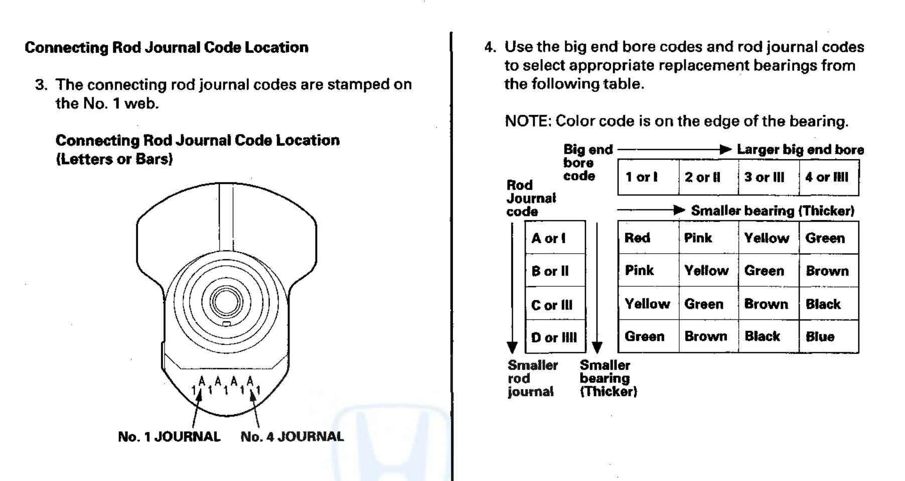

Hi all - for all the old timers who may be following my elevated wear level Used Oil Analysis ("UOA") thread, here - I have decided to bite the bullet and prepare for conrod bearing replacement and analysis of the used bearings.
For the benefit of someone reading this in future, please refer to Section 7-8 of the Repair Manual (PDF Page 230) which outlines acceptable tolerances and identify your OEM rod bearings.
Question for the brains trust - Would it be silly if I ordered 8 of every bearing, used the ones I require (possibly retaining an extra set depending on the combination) and then attempting to sell the remainder of the bearings? The source I am looking at (Amayama) does not accept returns - this method would allow me to borrow a hoist.
For completeness, I intend to order new rod bolts and also plasti-gauge the bearings. I have a set of AP2 banjo bolts which I will install if on hoist.
Alternatively, I could replace the bearings on my garage floor (space is limited) and just order the ones I need.
Grateful for any thoughts.

My only question - Are the top and bottom connecting rod bearings always the same colour? Based on my limited research it appears the answer could be yes.
Old Feb 21, 2026 | 10:00 PM
MaintenanceObsessed's Avatar
Joined: Dec 2025
Posts: 144
Likes: 68
Yes. Main bearings will sometimes mix colors but con rod bearings will be the same.
