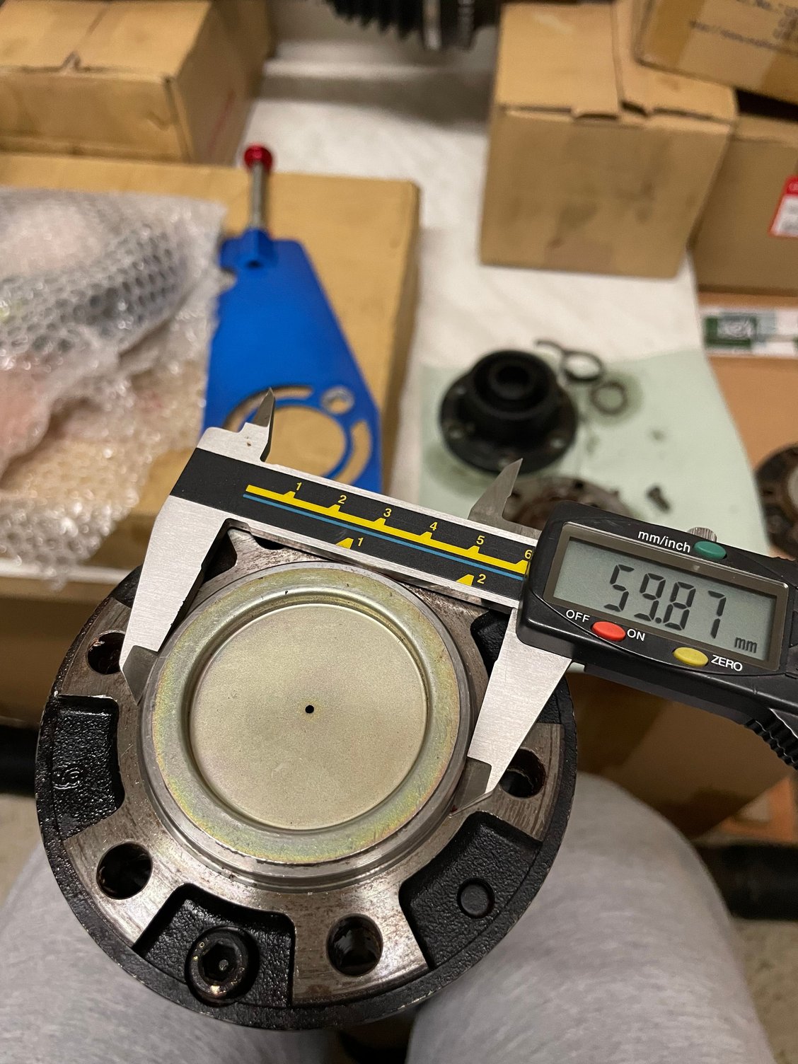

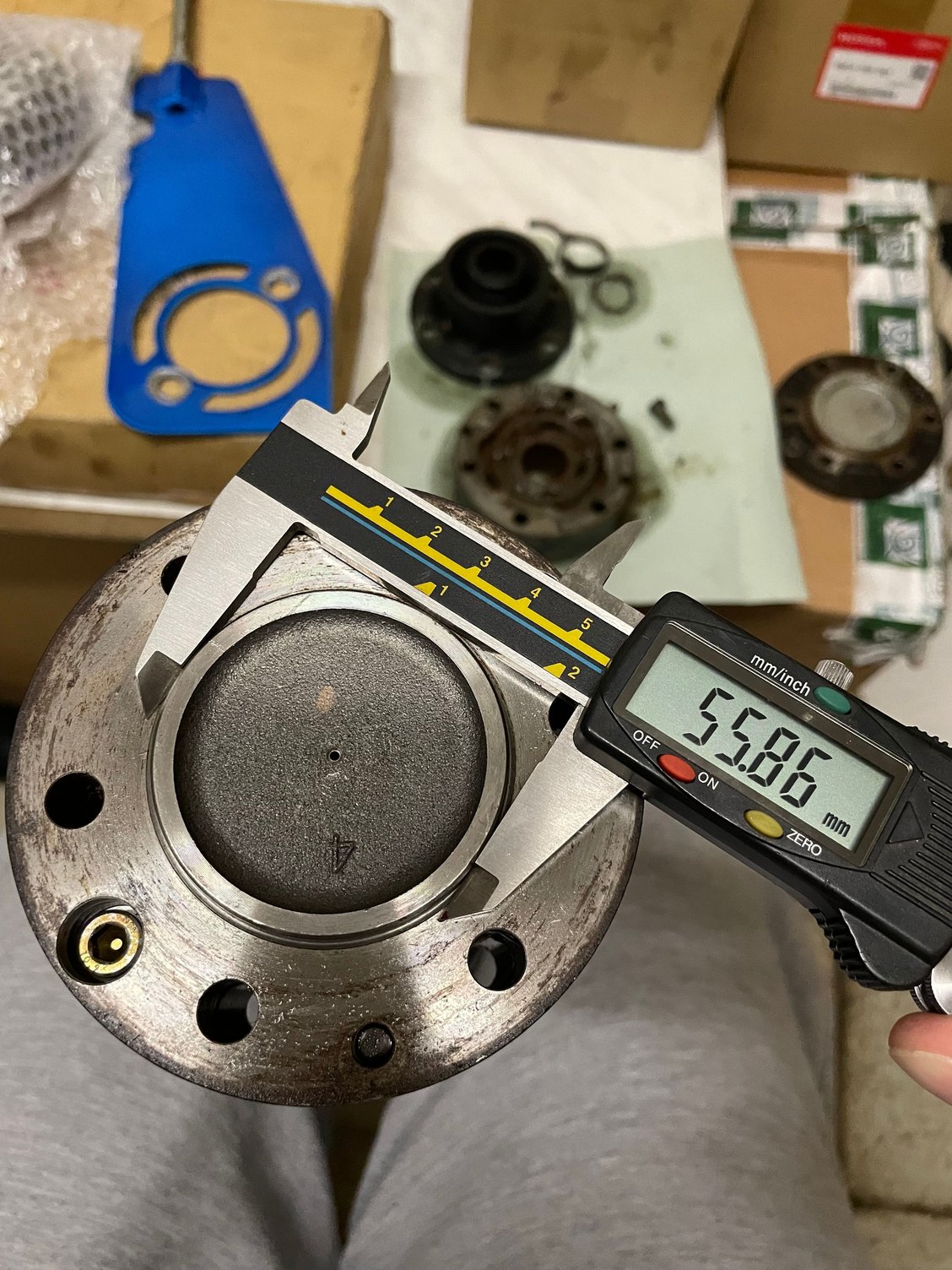

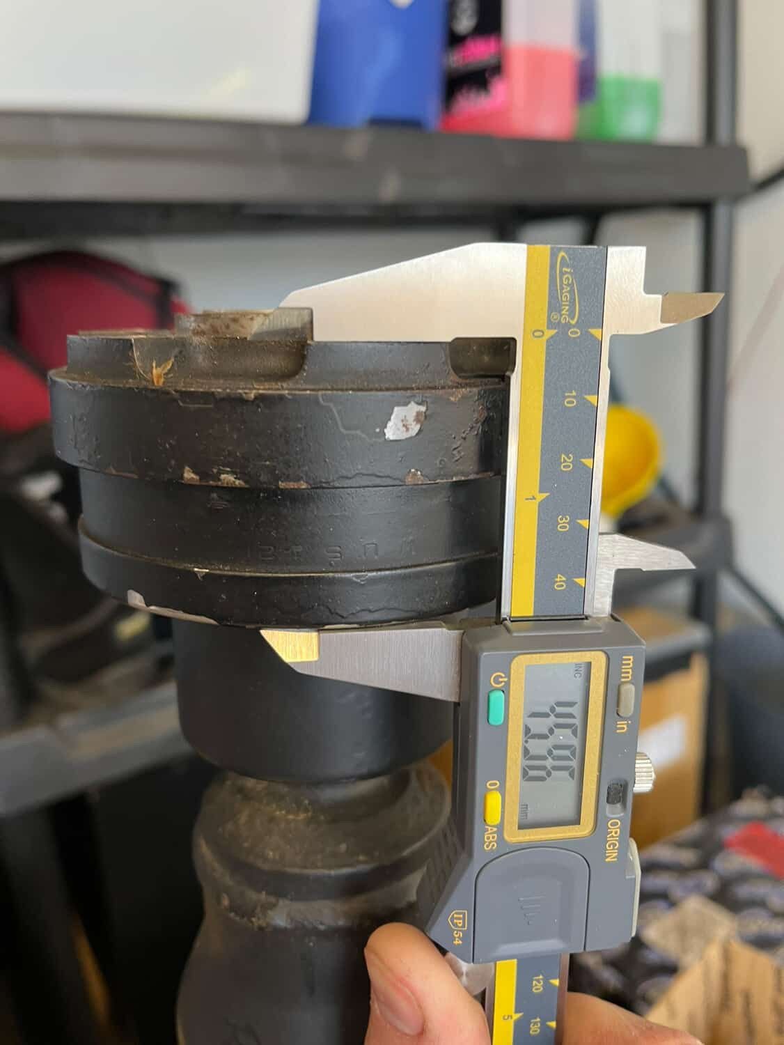

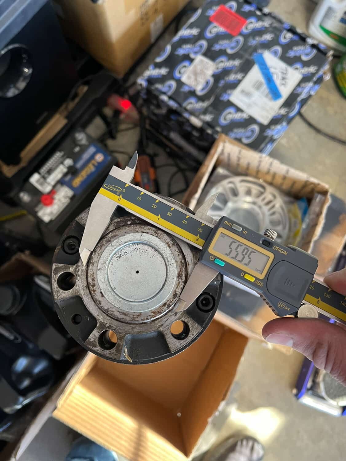

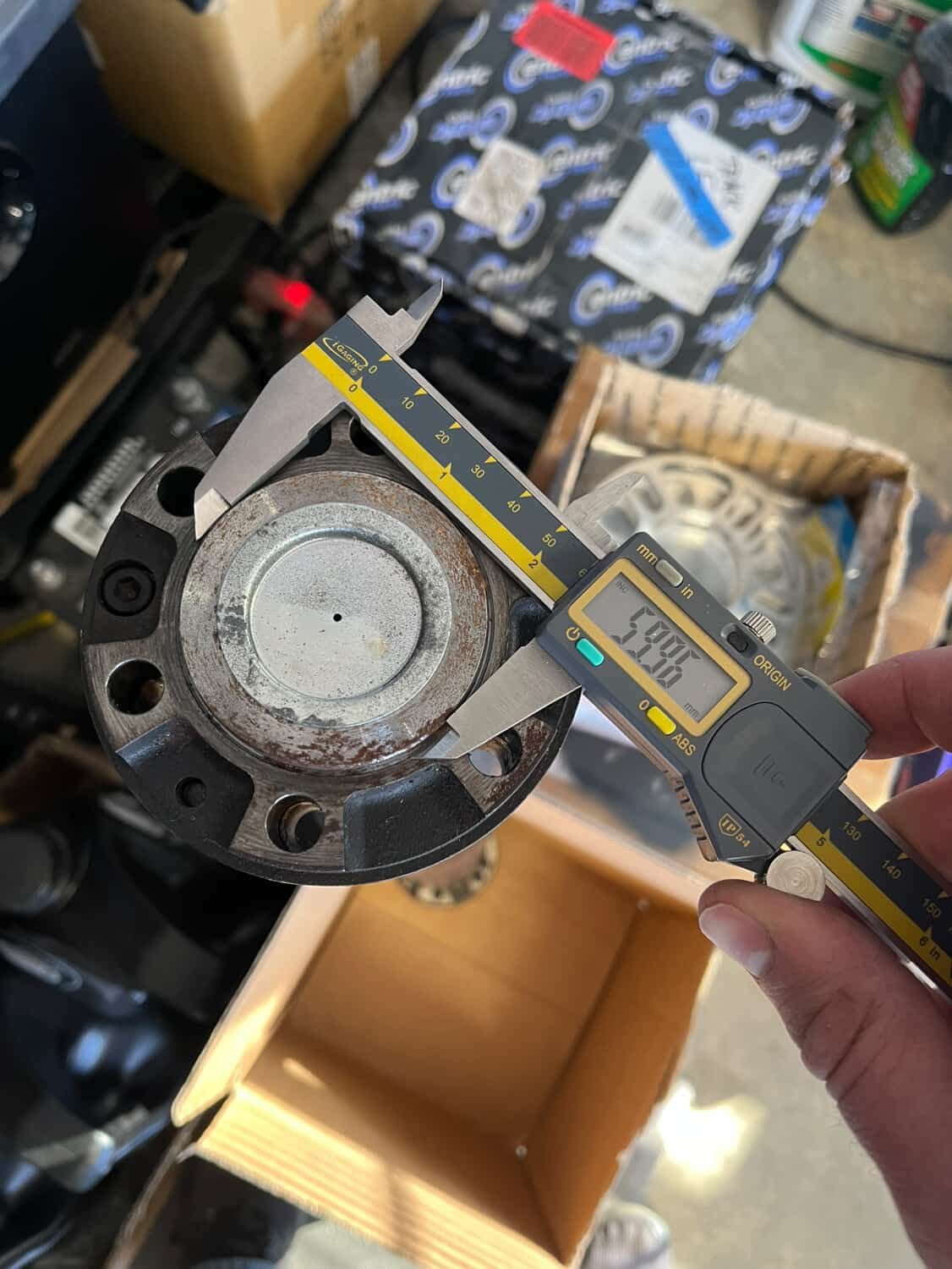

It is confirmed, the diameter of the centering rings is the same on AP1 and AP2, so it is possible to install an AP2 prop in an AP1 with AP1 flanges and the proper shoulder bolts(10mm to M8 thread).
After contacting NAUS, he was kind enough to measure his spare AP2 shaft and I was able to compare the dimension to my AP1, see in the pics bellow.

For your information, the correct shoulder bolt to make the AP2 prop fit the AP1 flanges with correct thread engagement is ISO 7379 M8 10x45 (d1=10, L=45, b=13). These are grade 12.9, so it is an upgrade from the soft, easy to round OEM bolts as well.
Additionally you need to order 6x AP2 prop shaft washers to fit the 10mm shank of the shoulder bolts, part number for that is 40140-S2A-A01.
Thank you to NAUS once again for the measurements of the AP2 joint widths(it is the same on both ends).
