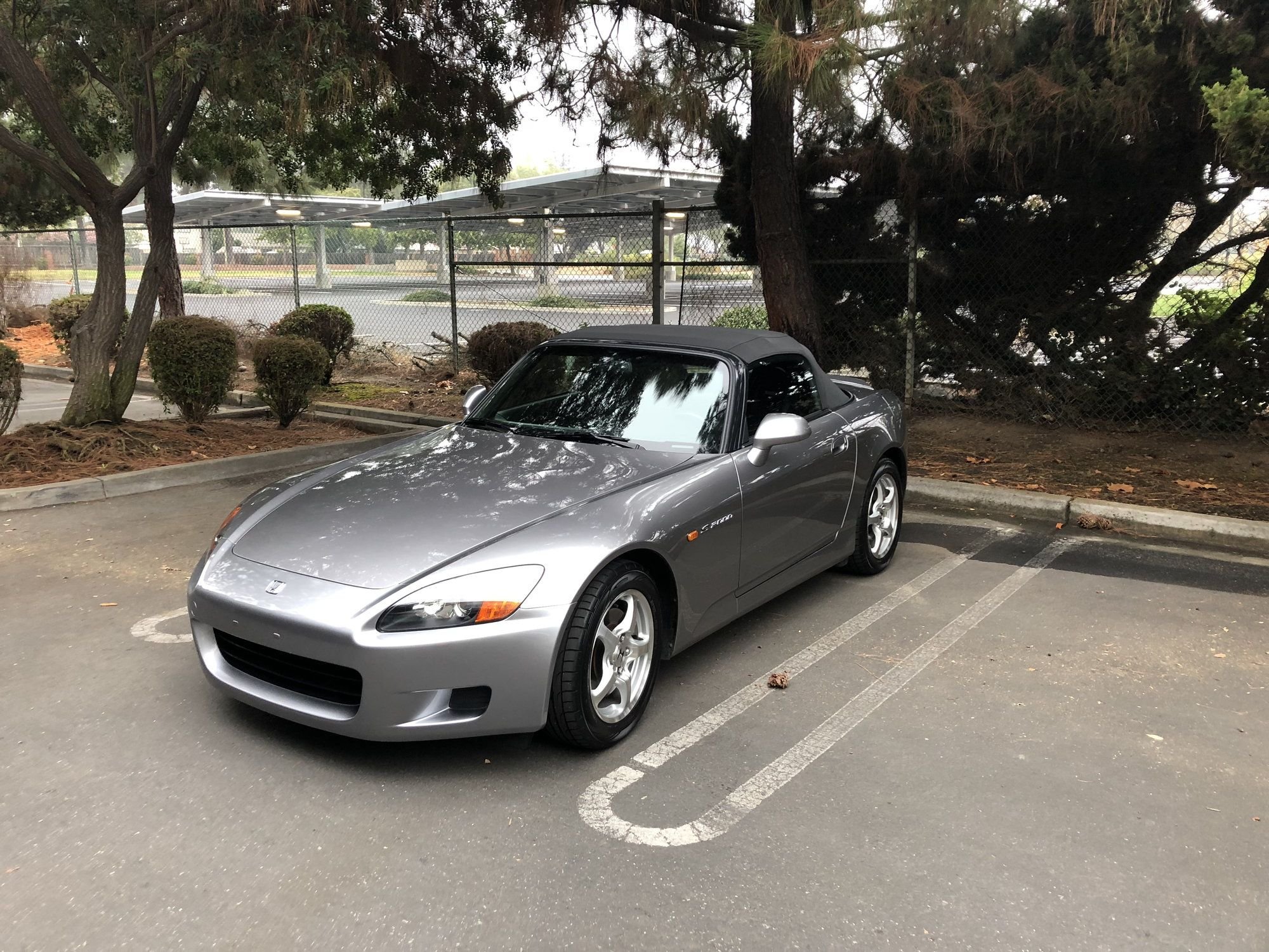

Hi everyone,
I own Year 2000 AP1 with less than 50k miles. Bone stock. I drive for daily commute since I got it at 14k miles from a collector in 2018. However, recently the car was sitting more than 10 days with OEM cover on while I was traveling for work. It started to rain a lot in the SF Bay Area and one day I drove my s2k to work without any issues and then when I tried to start the car again, it won't start while the engine cranking is strong and the battery is fully charged as well. By the way, all this time the green key light was blinking on the dash board. I towed it to a Honda Dealer. After charging me more than $200+ to diagnose the car, they concluded that the immobilizer is not recognizing my key. They asked me to bring another set of key, which I did but still it won't start. Therefore, they concluded that it is due to bad immobilizer. They even tried to re-program the keys but it won't start either. On top of that, Honda does not make or carry the OEM immobilizer anymore so I have to find an aftermarket one or used one on my own, Then, they will replace it with charge. Anyways, I searched through the threads and forums to see if it is in fact the issue I am facing with the immobilizer but I didn't find any useful post yet, so I decided to post this thread for others to share or learn if this happens to you in the future. I have not found a good thread or forum that helps me conclude on the immobilizer issue either. Anyways, I will update this post after mine gets fixed but in the mean time, I'd appreciate if you had a similar issue with immobilizer or similar event with AP1. Or, even AP2 as I am not sure if this is common for both models. Again, the battery
is fully charged, starter seems working fine and everything else checked out by me and the dealer, so the only suspect, I hope at the moment, is the immobilizer as the dealer indicated. I will keep this post up to date after my problem is resolved. Feel free to ask any questions. Thanks
