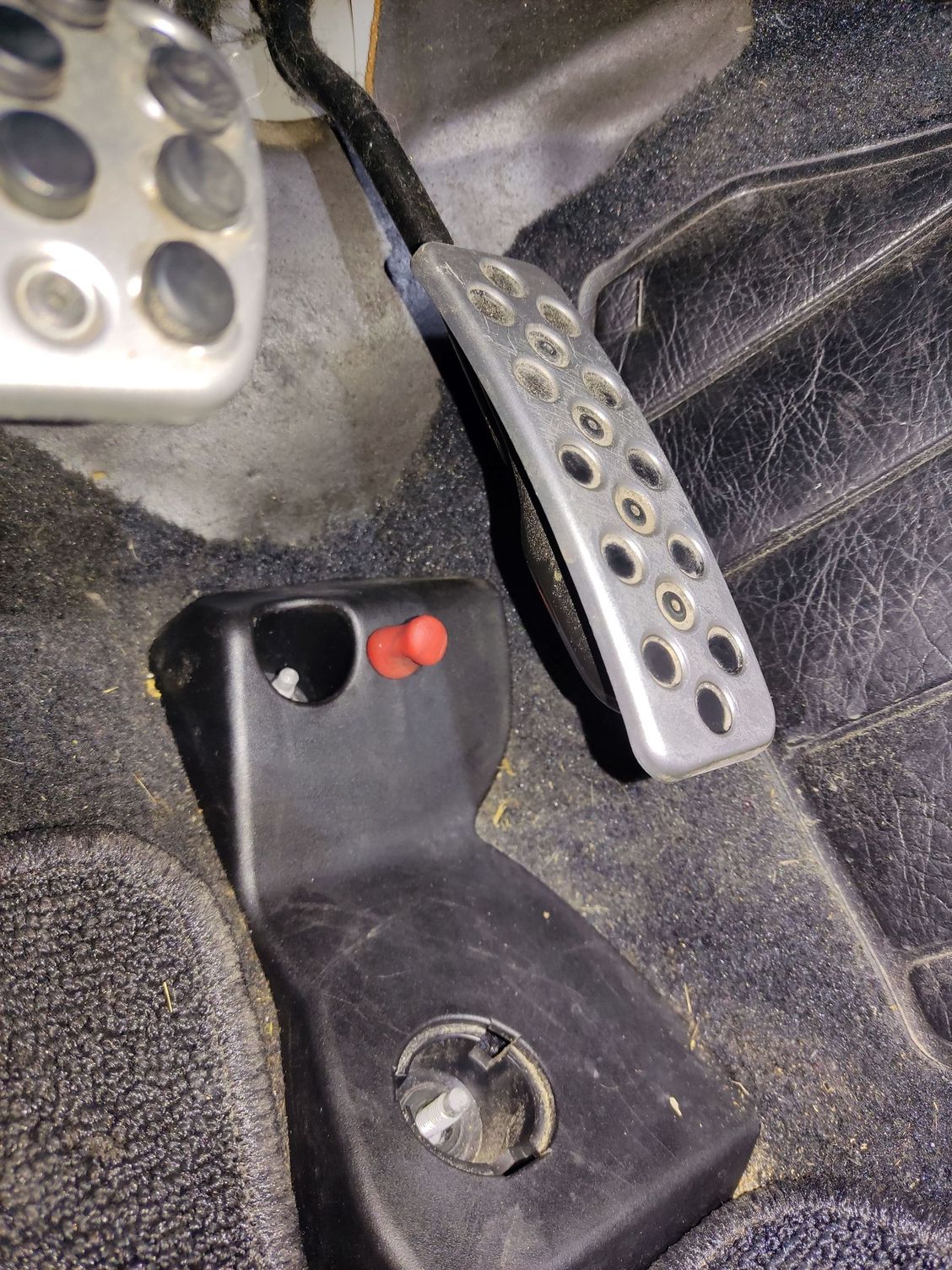

I discoverd that my AP1 does not have a adjustable Pedal Stop. E.g. some sort of bolt at the bottom of the footweell wich you can screw in and out to adjust the stop of the pedal. The S2000 has a Plastic stopper, but it´s not adjustable. Just a sort of wedge bolted toe the bottom of the footwell. Nr. 2 https://www.hondapartsnow.com/parts-...sis/pedal.html
With the Cable slack at the throttle valve adjusted according to the FSM (12 mm slack) the accelerator pedal is still several centimeters or 1 Inch away from the Plastic stopp in the Full throttle postion.
This means, all the pressure of your foot pulls at the cable and the the Throttle valve. This just seems not O.K. At every vehicle i had before, car or Motorcycle, there was a sort of mechanical stop.
Is there something wich i miss? Or is it really designed this way?

@Mr.Matchbox I talked to this earlier in this thread. Originally my pedal hit the plastic stop so not sure why yours doesnt. There is a black squishy bushing between the pedal and the cable end. Its there save the cable assy when you hit the throttle stop. Ideally you hit the throttle stop and the pedal stop with the squishy bushing partially engaged. I never liked how much slack you need in the cable to align all those bits though so i made my own adjustable pedal stop.

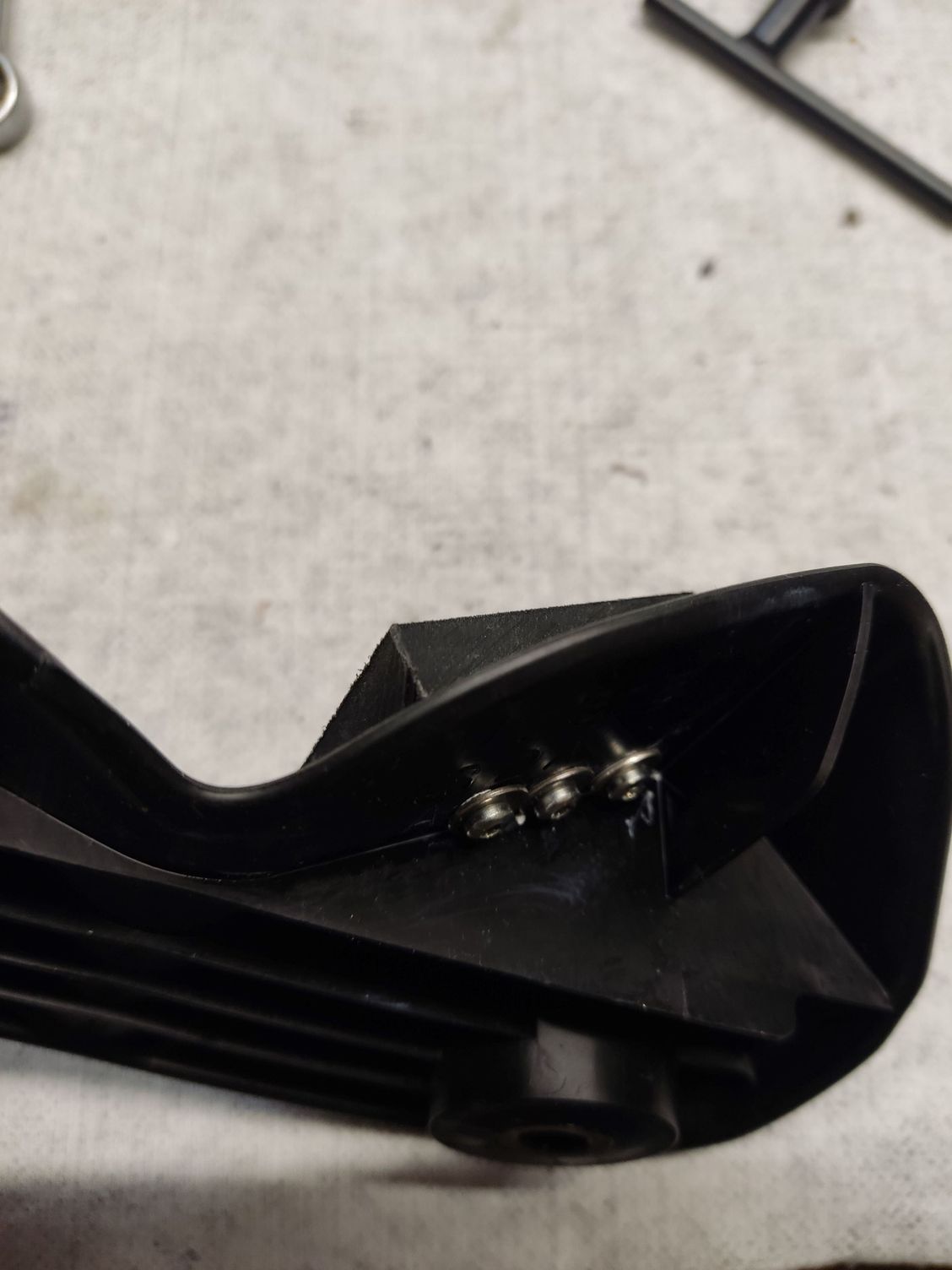

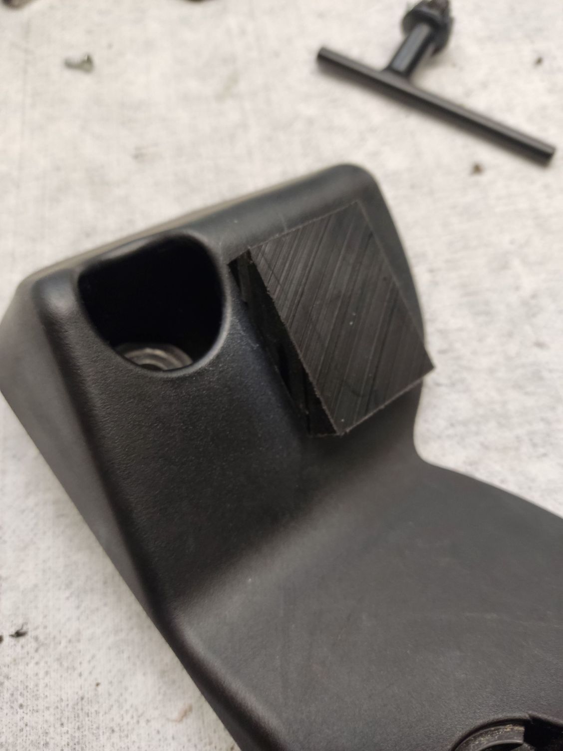

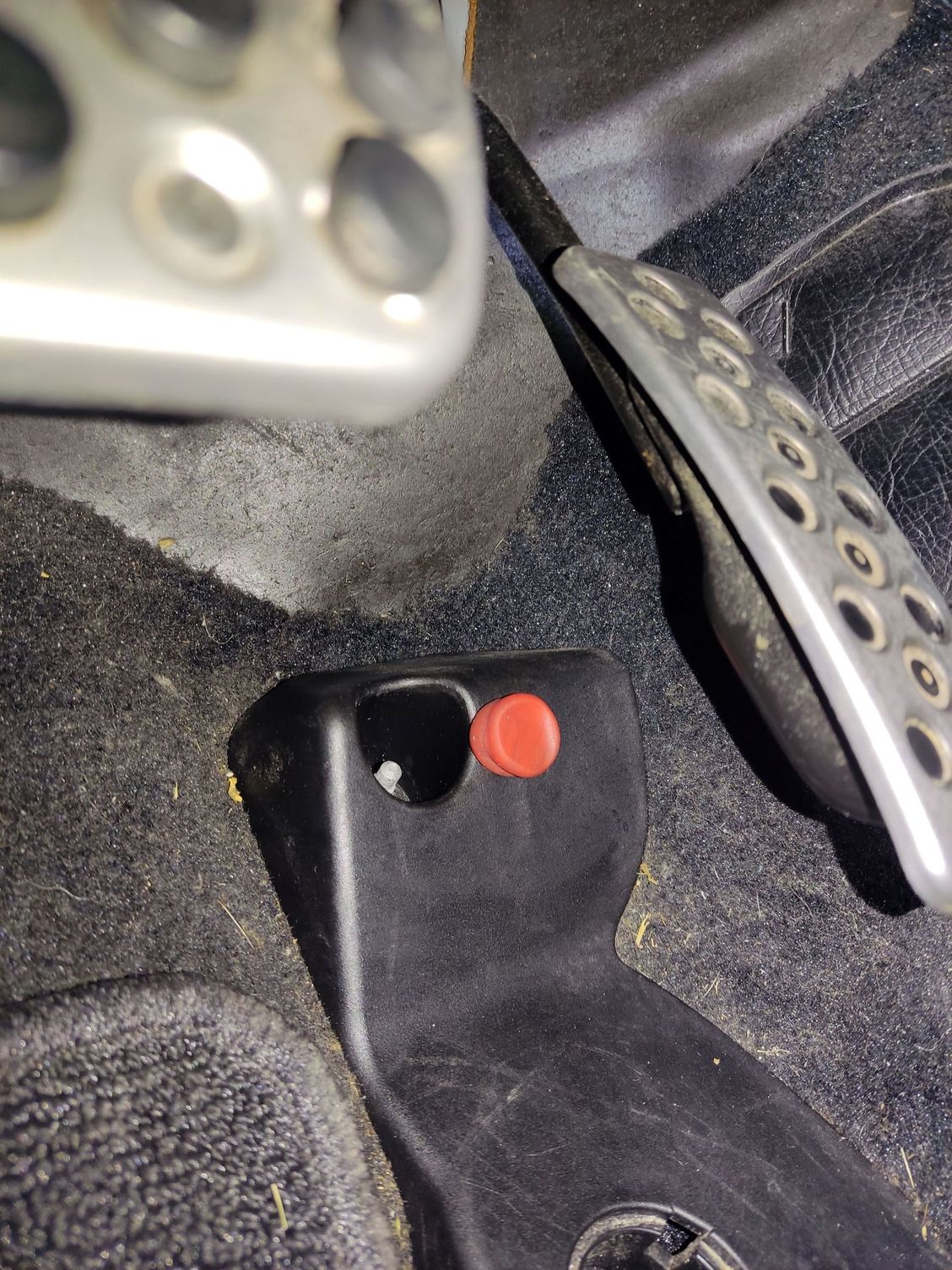

With the help of a little blob of bees wax i meassured about 10 millimeter play. Headed to the material store in my work and raided the garbage can. Found a pice of POM plastic. Bribed the guy at the table saw with a coffee.
Drilling, wrenching, chamfering with a file and i have a stop wich prevents me from over stretching the throttle cable in the the future.
I adjusted the throttle cable afterwards. There is not much slack in the cable, there is no play in the pedal, i hear the "Click" when the throttle valve open fully and there is about 1 mm left until the pedal finally hits the stop.
I call this O.K. And now the big question: Why is it so from the factory?
