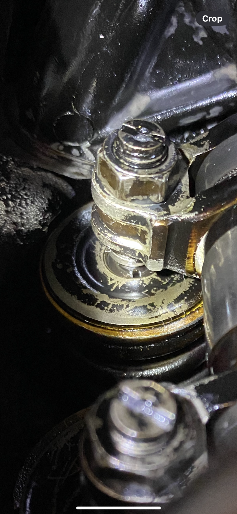

I recently bought an S2000 and am almost done servicing it. Last weekend, I did a valve adjustment, and since mine is a 2001 AP1, I had been reading a lot about the notorious cracked retainers to be able to assess their condition.
From what I could see, the keepers don’t seem to be sunk much, and the valve stems sit higher than the retainers when viewed with a mirror. However, I’m not sure if the retainers are cracked, and the inside of the engine is covered with deposits, which makes it even difficult for me to make a confident judgment.
I’ve attached some photos (starting with the first cylinder and ending with the fourth) and would appreciate your thoughts on the condition of the retainers.
A few details about the car: it’s a 2001 AP1 with 200,000 km (124k miles). The history isn’t entirely clear, but it was owned by an elderly couple for approximately the last 15,000 km (9.3k miles) (though, of course, that doesn’t fully rule out the possibility of a mechanical over-rev).
Any opinions or advice would be greatly appreciated — please talk me into or out of replacing the retainers with the AP2 ones.

7th pic looks broken pretty bad. Pivs can be deceiving, what is all the yellow paint?

wow, oil deposits are quite rampant on that one. too bad they dont make a Valvoline restore and protect in 10/30. anywho i agree with billman that 7th pic looks low. i would replace the retainers and keepers.

For the retainers, yeah for an AP1 you bought used, I would almost just swap them. It is only a concern if a mechanical over rev occurred but you have no way to know if that has happened. Previous owner was an autocrosser and swapped the ones in my AP1 when he still had it or I would likely have just done it right away. Even if never tracked, it is pretty easy to do the 2-3-2 money shift in this car if someone is beating on it on the street and is not paying attention, so good insurance IMO, especially now that there is question on pic 7 there.
Also curious with all the yellow in those pics... something looks very off in that head

By the way, the retainer in picture 7 is the second one from the firewall, which confirms Billman’s findings that these are usually the worst. Once I get the parts and replace the retainers along with the valve stem seals, I’ll report back on how many were broken.
