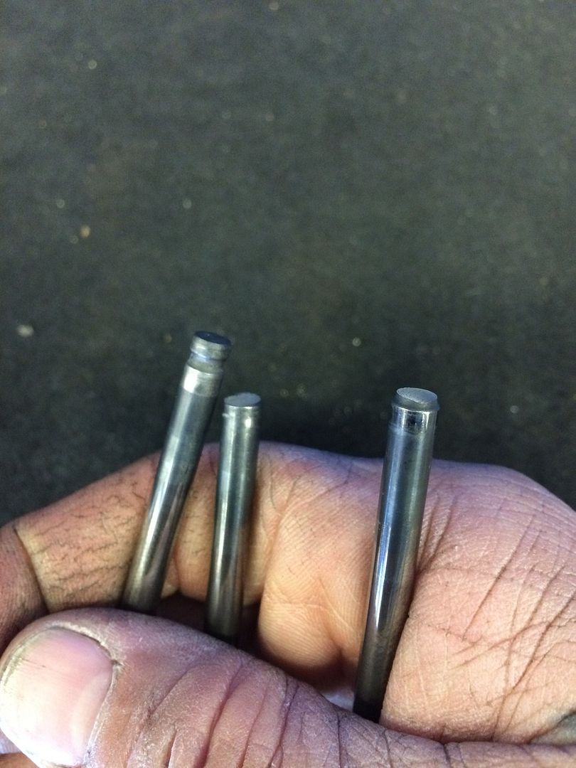

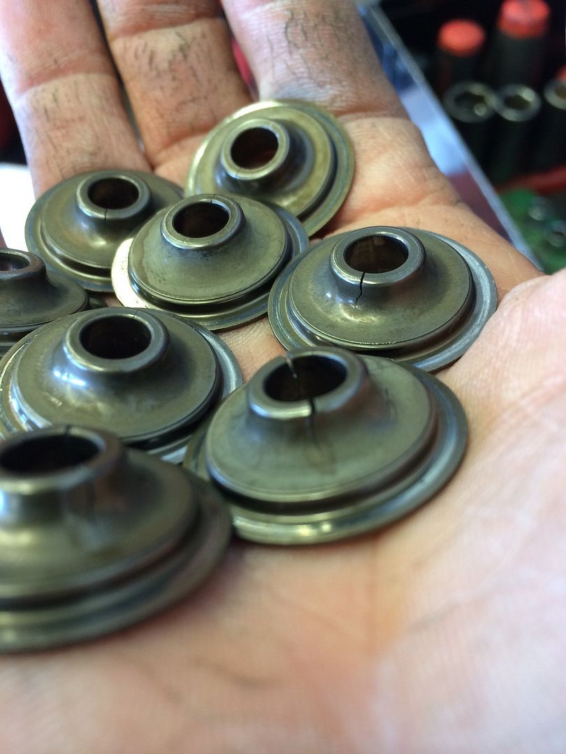

This was off of a customers car. Came in running. Valves almost dropped. Rocker was touching retainer. Rocker should only be touching valve tip. 2 tips were missing. 2 broken valve tips. Multiple cracked retainers.

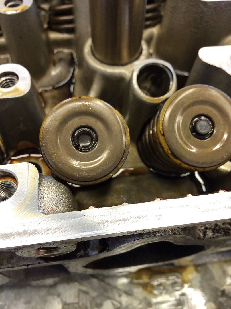

IMHO the best way to inspect the retainers without pulling things apart is to use a dental mirror like so.

Take your pics with a mirror exactly as above
