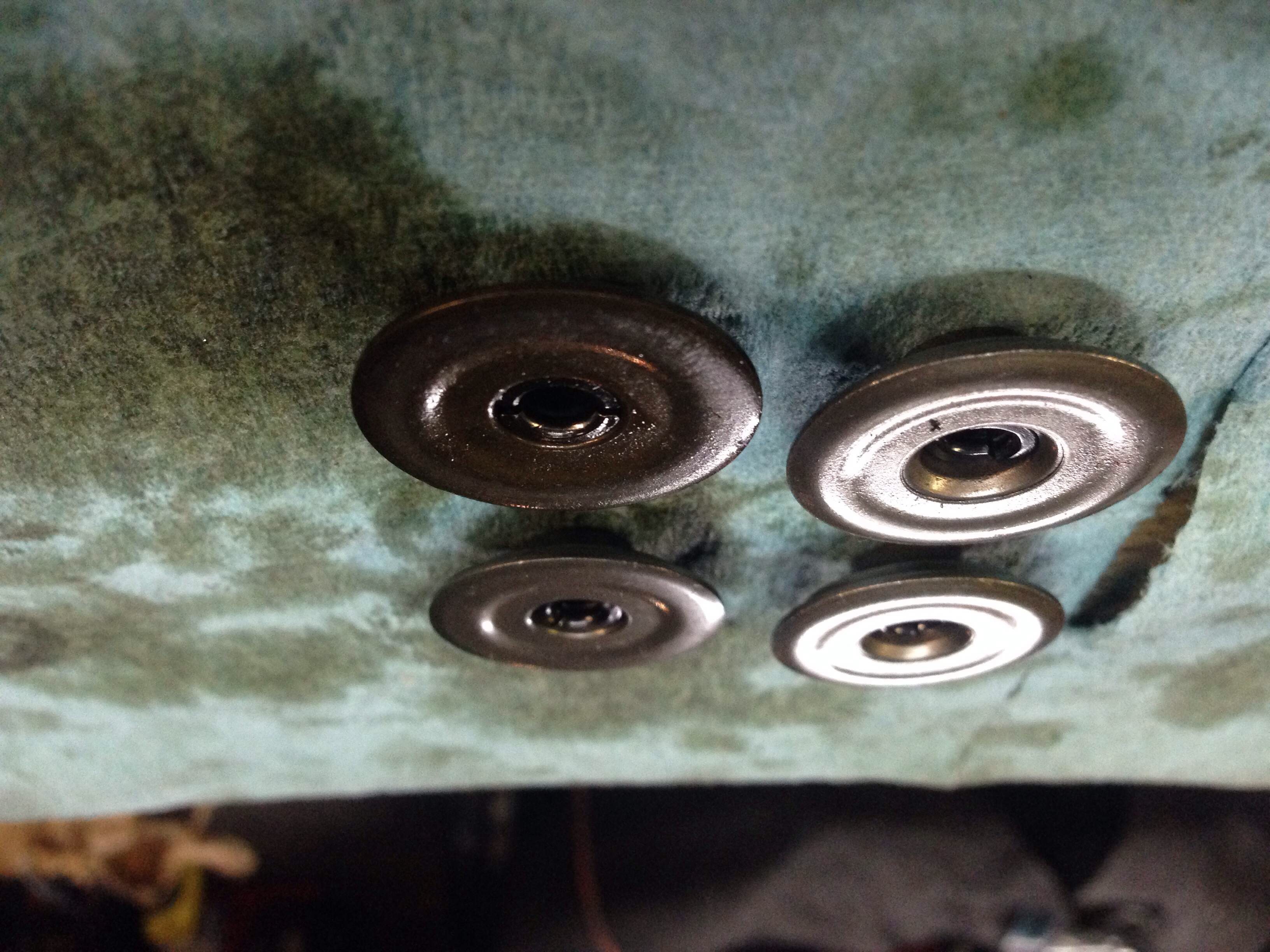

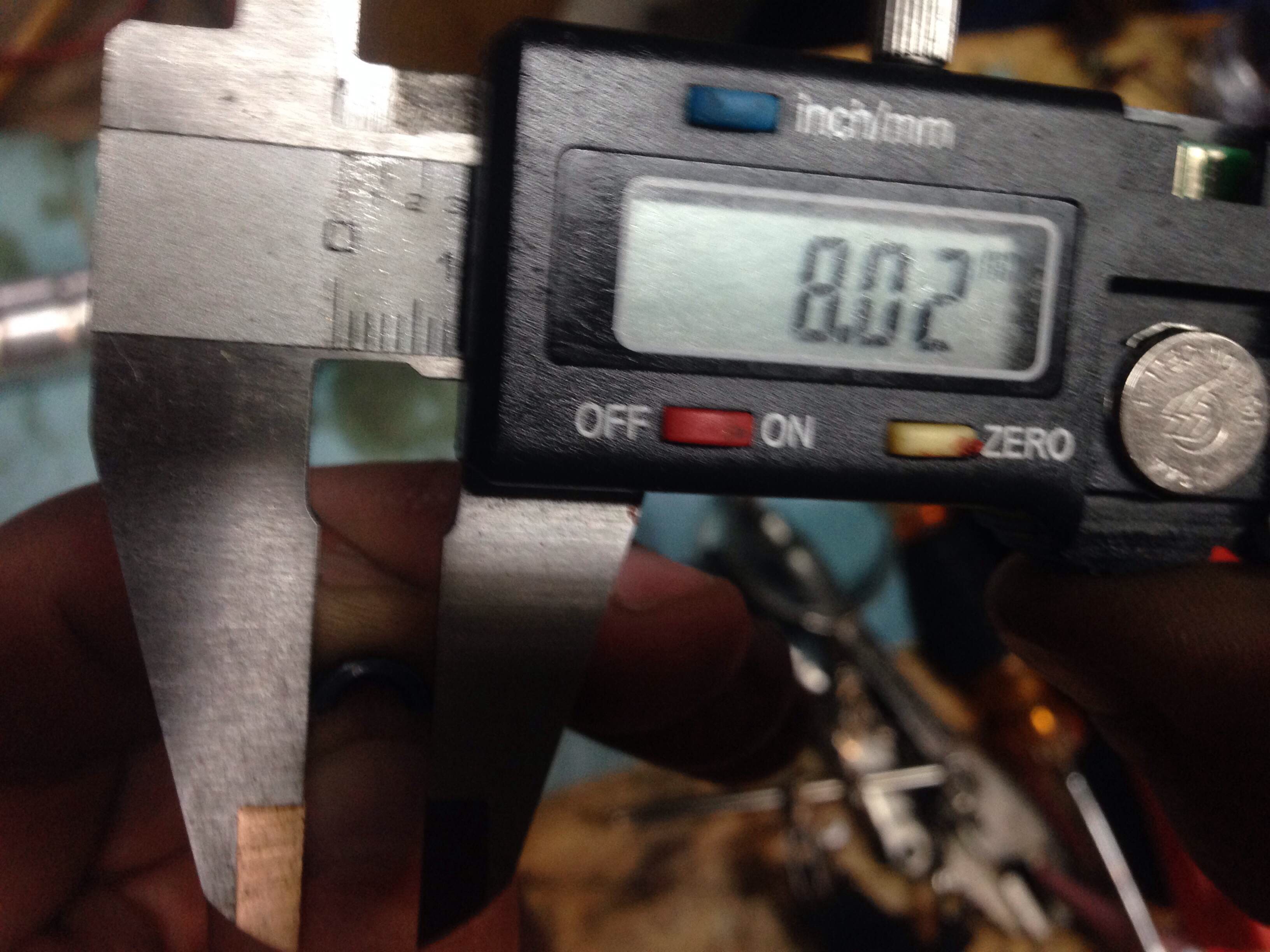

I measured my old ap1 cotters with a pair of calipers and they were approximately 8.04mm depending on how good your machinist hand is lol. I started measuring all my new cotters and I noticed a difference that some were around the 8.04 mark and some were around the 7.64 range. From getting what I could from the picture that Carbon Blue posted in an older thread on s2ki, I took a measurement from end to end at the top part of the cotter. As you can see my measurements give me the clarification I needed when my eyes couldn't. In the end I also noticed that ap2 cotters sit nicely lower in ap2 retainers vs the ap1 cotters sitting up in the ap1 retainers as in the picture with the ap2 on the left, ap1 on the right. Sorry pictures suck, iPhone ugh.

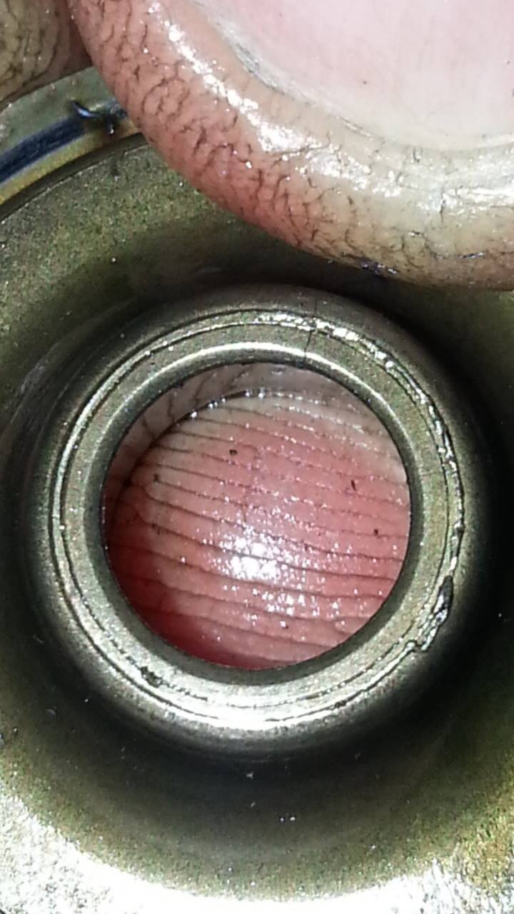

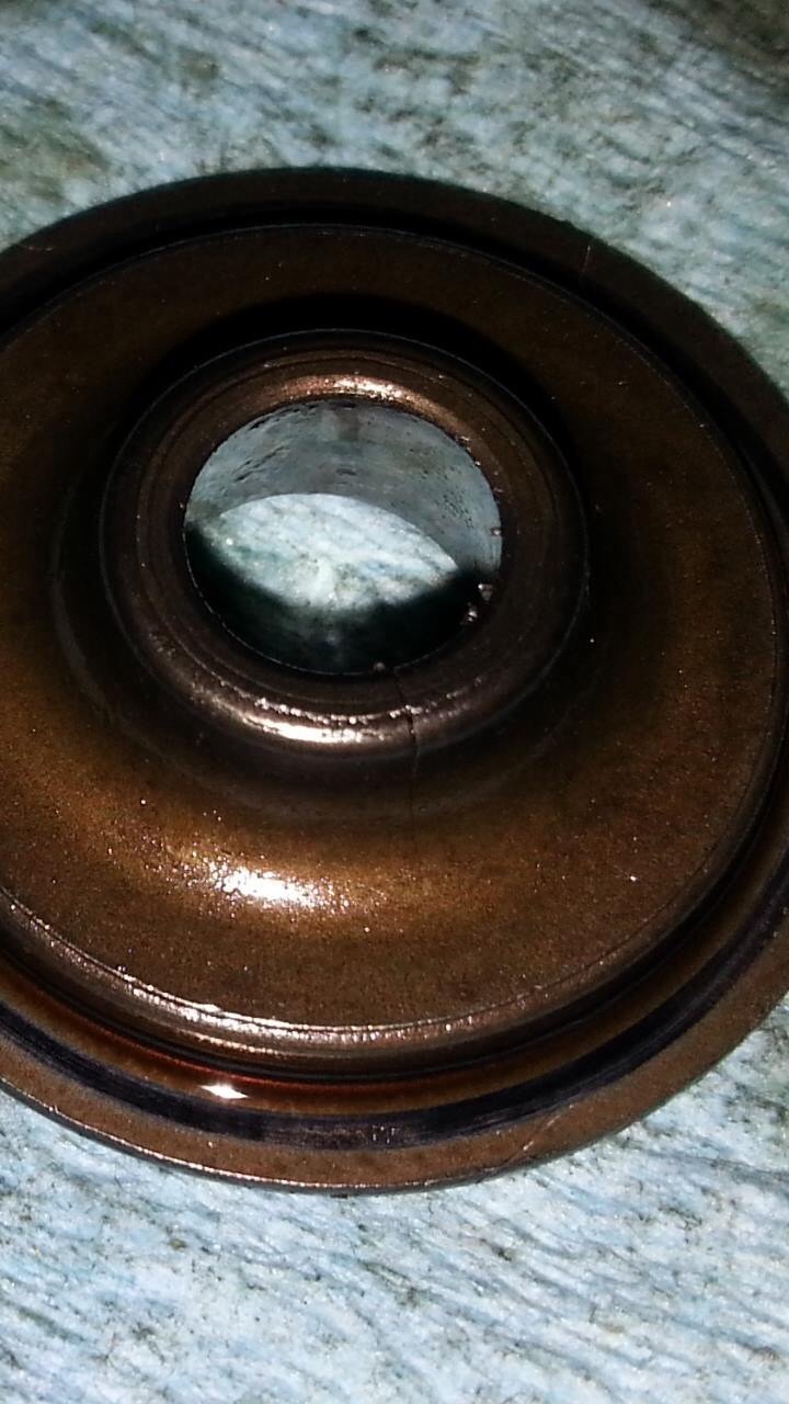

I don't know if this would help anyone, but I thought I'd give it a shot. In the end, 2 cracked intake retainers and no cracked exhaust retainers of course, but peace of mind is priceless.
