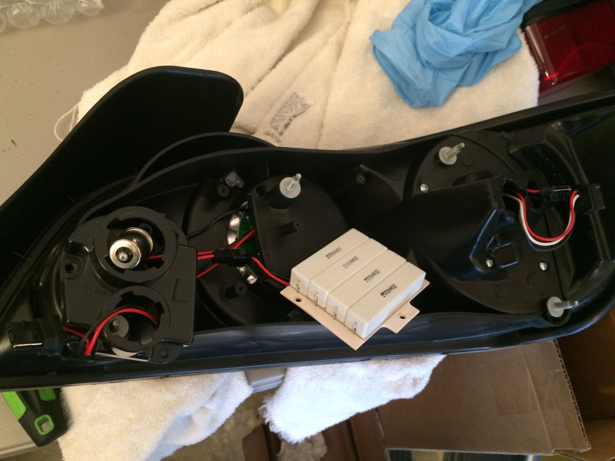

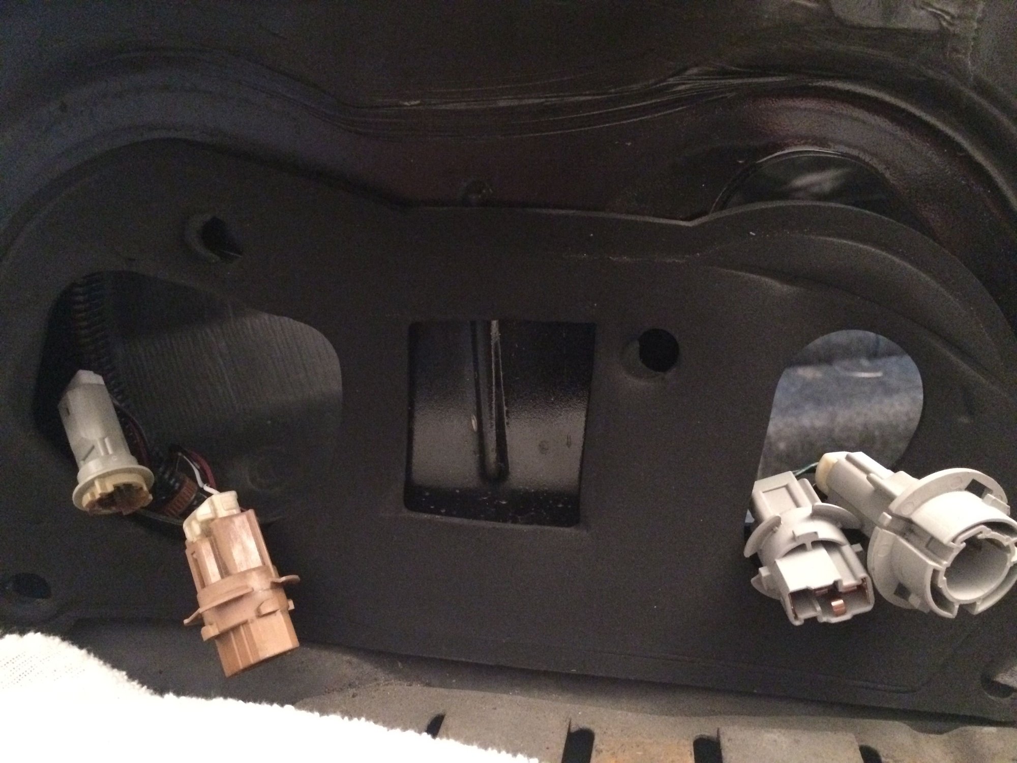

Finally tear into it today, pick up 2 replacement blinker bulbs because they're cheap and why not try that first - I am greeted by this conundrum. First and foremost I can't even see a way to pull the panel off to access the bulb itself. I'm also now figuring the issue is more complicated than just a blown bulb, especially considering both of them don't work. Has anyone seen this conversion before, or knows what the heck is going on? Rear panel does not appear to have been cut/modified at all, something I thought was required based on the other threads I've been reading.

Dogsbody, you have the knock-off generic ap2-style tail lights made to fit the ap1's. This is a great option for those who do not wish to cut metal to get genuine ap2 tails into their ap1's. I know because I have them too on my ap1. The issue with these tails is that the first batch of them had the polarity reversed for the turn signals. Since all the lights in the rear tail lights of these ap2-style tails are LED's built in, there is no LED bulb to switch out. So, you will just have to cut off the turn signal wires and re-wire them opposite.
