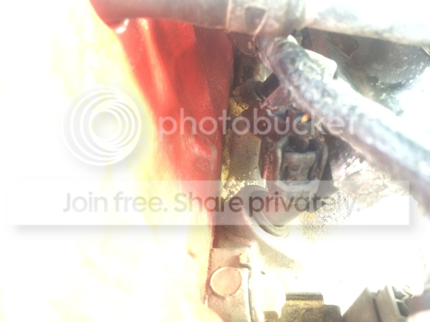

Also found this the other day, it's like a popcorn texture, however I've done a few hundred miles since and no more has appeared.
Could just be build up of mess from constantly bleeding coolant?

Pressure test your coolant system, that should make any leak apparent rather quickly. See if there's oil in your coolant when you remove the radiator cap, cold engine of course. It's hard to spot but if you look closely if you see little black dots floating on the surface it could mean you have a head gasket leak. Remember the oiling system is under higher pressure than the coolant system. So you it's more likely that if you have a seeping headgasket the oil will end up in the coolant rather than vise versa.
