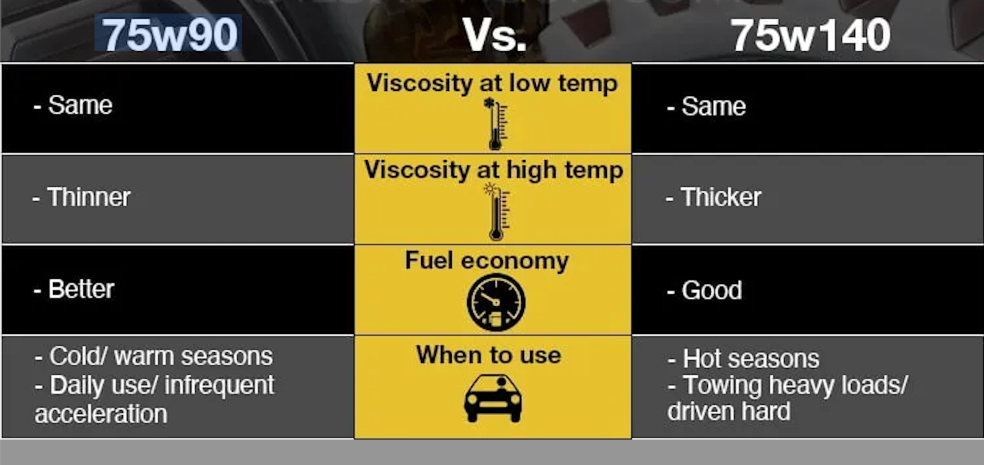

Originally Posted by Mr.Matchbox
Differential: SAE 90 GL5 is what honda calls for, you could use any 75w-90 GL5, 75w-110 GL5or even 75w-140 GL5. Most -140 are on the very thin side, just a little bit thicker as the -110 when you read the data sheets of the manufacturers.
75w-110 is a bit more rare here in the US than, presumably, Europe. I think the only one I have seen is Amsoil.
Couple of cut and pastes from webpages. (Bob is the Oil Guy/Oil Advisor)
It's odd how different sites have slightly different explanations of the upper number (90 versus 140). FWIW, I've been using Mobil One synthetic 75W-145, for 8-years on my S2K. No problems, no noises. Change it every two years.
Actually, the different sites have opposite descriptions! Your link says 90 is thicker at high temperatures and 140 is thinner at high temperatures (wrong). It then says that thinner oil is better at high temperatures, which makes no sense.
Lower number = thinner = better for low temp.
Higher number = thicker = better for high temp... just like motor oil.
https://addinol.de/en/products/lubri...ils/sae-75w90/
https://www.thetruckstop.us/forum/th...r-75w-90.1678/
https://www.rv.net/forum/index.cfm/f...print/true.cfm
Yes indeed. It is not just websites about motor oil that are goofy as well. I find disconnects all the time in all manner of so called "expert sites".
