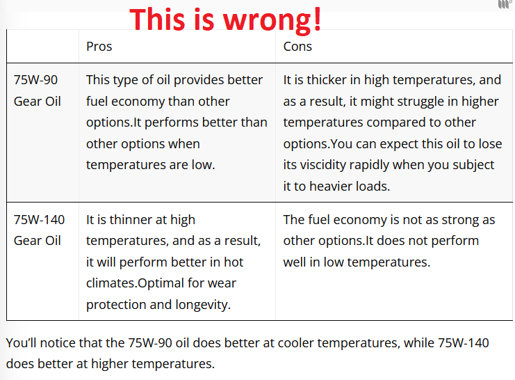

Originally Posted by windhund116
It's odd how different sites have slightly different explanations of the upper number (90 versus 140). FWIW, I've been using Mobil One synthetic 75W-145, for 8-years on my S2K. No problems, no noises. Change it every two years.

Originally Posted by Save the Manual Wagons!
Actually, the different sites have opposite descriptions! Your link says 90 is thicker at high temperatures and 140 is thinner at high temperatures (wrong). It then says that thinner oil is better at high temperatures, which makes no sense.
Lower number = thinner = better for low temp.
Higher number = thicker = better for high temp... just like motor oil.
https://addinol.de/en/products/lubri...ils/sae-75w90/
https://www.thetruckstop.us/forum/th...r-75w-90.1678/
https://www.rv.net/forum/index.cfm/f...print/true.cfm
Look again, it says just the opposite!
No, it doesn't... Look at the chart yourself. I must have checked it three times to make sure I wasn't seeing things. https://mycarmakesnoise.com/oil/75w-...il-comparison/
75W-90 Gear Oil - It is thicker in high temperatures, and as a result, it might struggle in higher temperatures...
75W-140 Gear Oil - It is thinner at high temperatures, and as a result, it will perform better in hot climates

@Save the Manual Wagons! Is correct. Viscosity numbers are, not surprisingly, logical: Higher number means thicker. Works the same for all oils. For example 10W-40 is NOT thinner at 100°C than 10W-30. That's all we need to know.

[QUOTE=Save the Manual Wagons!;24981142]No, it doesn't... Look at the chart yourself. I must have checked it three times to make sure I wasn't seeing things. https://mycarmakesnoise.com/oil/75w-...il-comparison/
QUOTE]
I was looking at the chart you referenced in post #15 above
And I do agree with you.. looking at different charts I guess..
