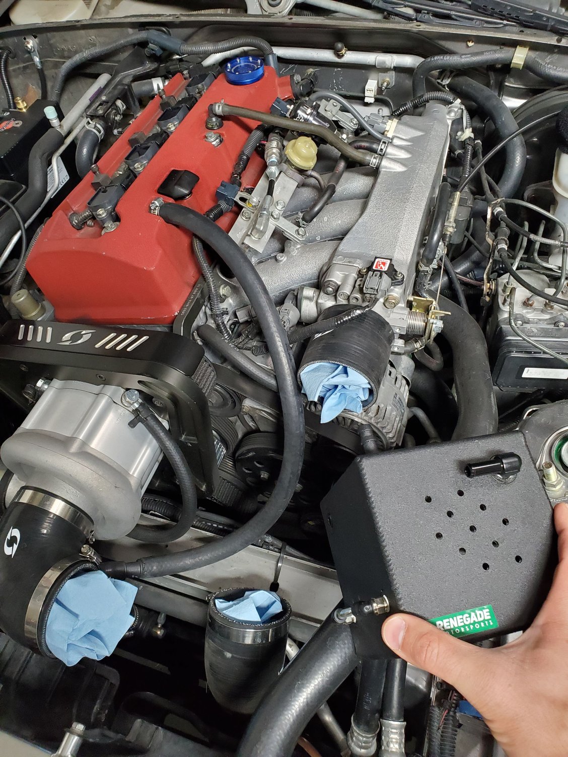

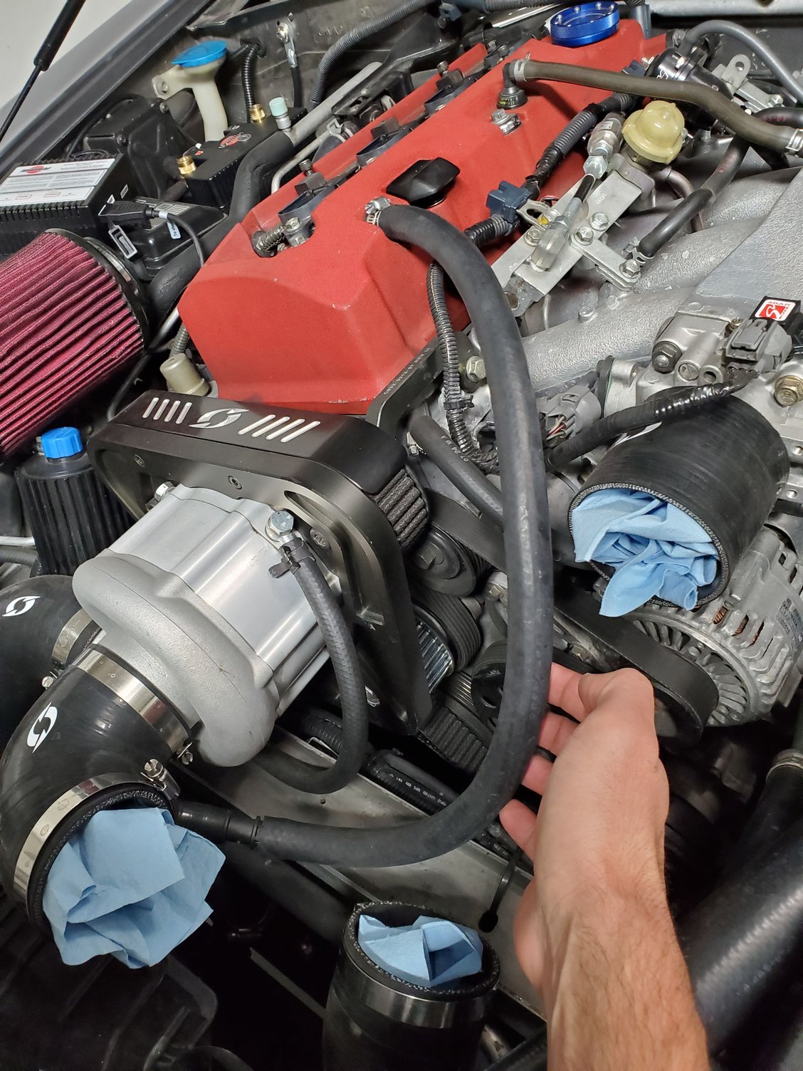

Hi everyone. I have procrastinated posting a new thread as there is so much information out there on the topic.
However, i can't seem to get an answer on my particular setup.
-I have an AP1 with kraftwerks kit.
-Catch Can is Renegade Motorsports (vents to atmosphere)
https://renegademotorsports.com/coll...nt=45091911555
-I also have an AP2 valve cover ill be installing. And so i will be getting a 10an fitting for the threaded pcv port
currently my pcv setup is as oem. routing to the manifold.
front valve cover return is going to the underside of the 90deg elbow right after my kw filter.
If i incorporate my catch can, do i plug up the bung on the KW elbow and also cap the pcv inlet on the intake manifold?
If so, can this lead to any issues with boost in track situations?
Please provide better routing ideas if there are any.
Really appreciate the help

I run HKS supercharger and I only install catch can on front vent, leave the PCV to go to manifold.
I dont vent to atmosphere though, i route it back to intake after catch can.

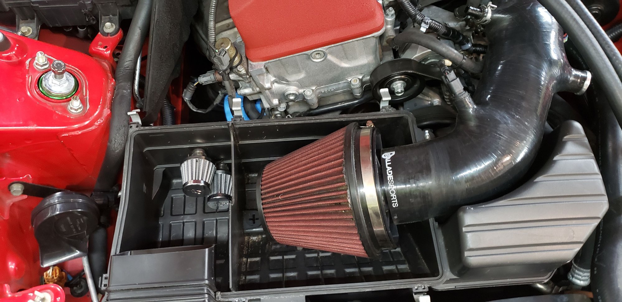

Vented cans smell so bad in the cabin and in the garage when you park.
Vent it to some closed source. I vented mine back into the part of the airbox chamber that would NOT allow liquid oil to access the intake filter.
OMG yess I know I'm a genius pls stop asking me if I know

That is a pretty good idea for a vented can!

Yes, you will cap the intake manifold and the elbow from the kraftwerks kit. Then you will be venting to atmosphere which wont hurt anything, but it will smell bad.
