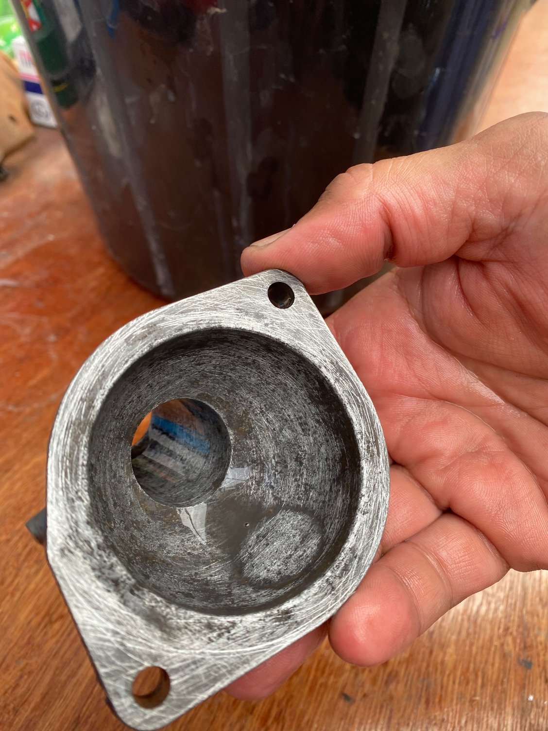

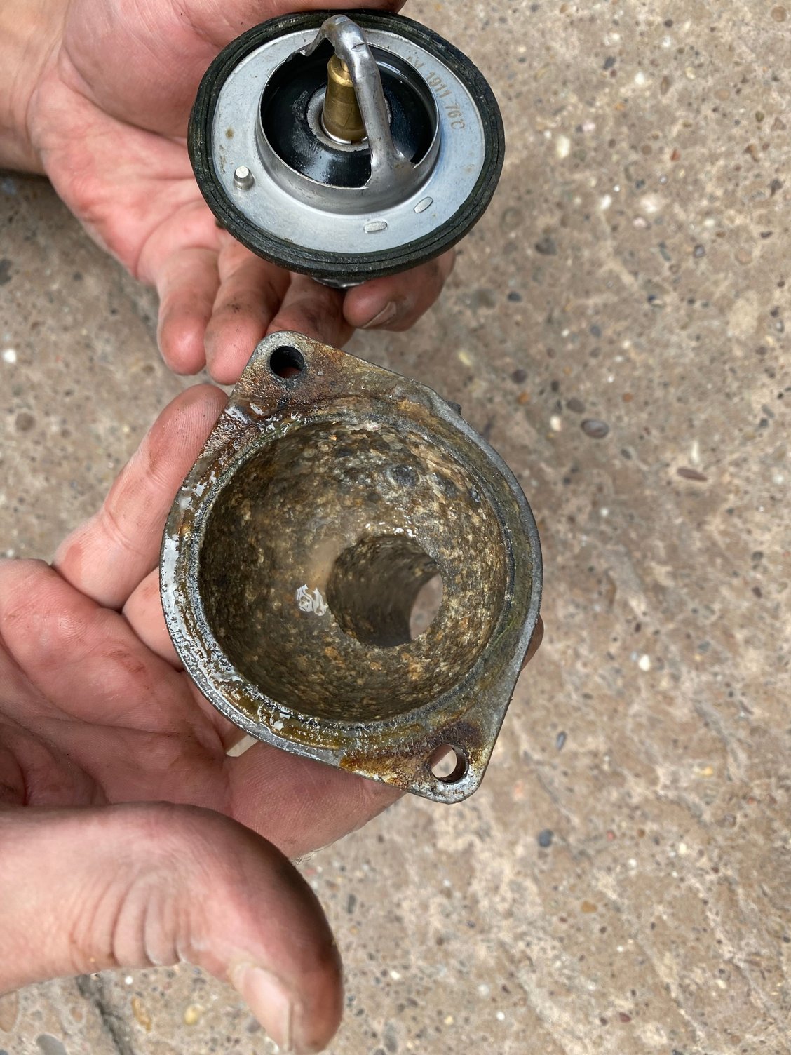

At the initial warm up phase, did you wait for the cooling fans to kick in to know that the engine was up to temperature or did you just wait for the 3 bars on the temp guage (AP1) to show ? The reason I ask is that I noticed that my temp guage seems to have one bar showing even before I start it from cold - so not sure it's 100%. Another thing that is bugging me now is that VTEC did not engage when I was out driving earlier today - I always ensure 10-15 minutes of driving before gunning it. I checked coolant temperature when I got back home with my foxwell OBD2 code reader and it was saying 187' F, which should be warm enough for VTEC to engage i think - read somewhere 140' F is the minimum temp.
1. Like you say, I too suspect I might have fitted the thermostat wrong - the little hole is supposed to be at the top not the bottom to allow air to be bled out easily I believe - but I think the thermostat can only 'face' one way to be seated properly - is that what you are thinking too ?
This is the old thermostat and housing - nasty looking
This is what it looked like when i removed it
and after a good clean - unfortunately I didn't take any pictures of the new thermostat in situ to know if it was the right way up
