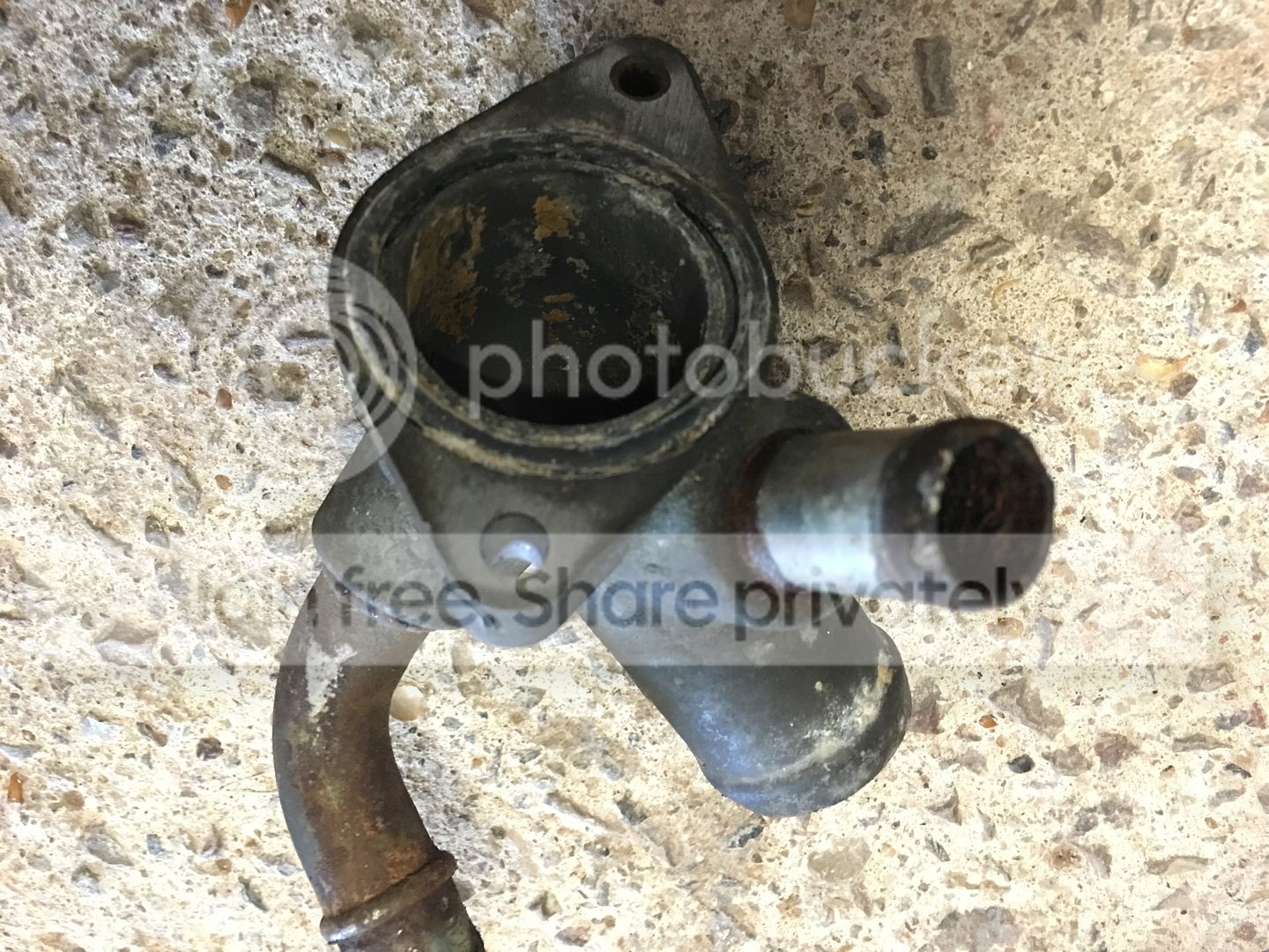

So i put the pressure tester on while still hot, and the pressure was dropping! So obviously a leak causing it to suck in air?
However when cold it holds pressure!
So a good look, and no noticeable puddles, but at the rear by the intake manifold looks a bit damp.
So thought it would be a good time to replace the intake manifold gasket, and this is what i found:
And have a feeling this may be the culprit? the o ring was pretty hard and brittle!
So have ordered a load of new parts, including the heater hoses, as they looked a bit past there best, and will have to try again!
Not looking forward to re-assembly mind, took some serious swearing to get them bolts out!!!

At least it's not the lower radiator hose.
